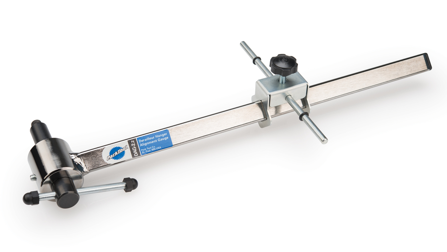

Some points
1) You have to ensure that the hanger (whether integral or replaceable) is aligned properly. This may mean bending it if integral, or replacing it if its replacable and has been badly bent. In both cases you need some way to ensure that the RD mounting bolt is parallel to the axle. This means buying or fabricating a testing/bending tool.
2) Next, you have to ensure that the derailleur is not fatally damaged. The pantograph mechanism has be smooth and low friction. The jockey wheel carrier has to be perpendicular to the RD mounting bolt. It sounds like you know that your RD is kaput. So buy a new one (or a used one off ebay, if you trust ebay).
To answer your question, you need a new derailleur, and likely a new hanger (if yours is replaceable). And you need the tool to check and correct the RD mounting bolt alignment. A Park Tool DAG 2.2 is kind of standard. If you can find a shop, it will be cheaper to have them do it. Or, buy used off ebay and sell it after you've aligned your frame.
