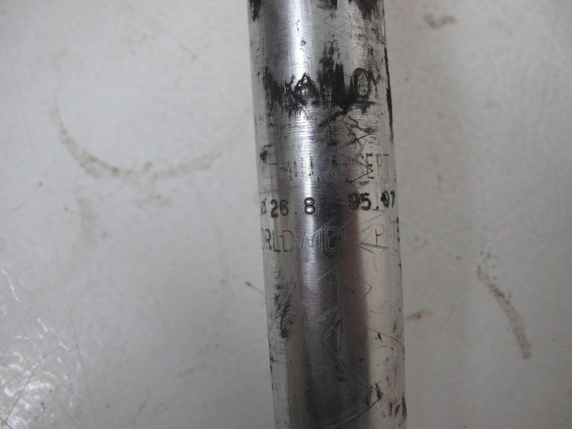

I'm an idiot. The diameter is stamped right there at the top of the seat post. Didn't even have to pull it out; just squint a little. So it's 26.2. This tell us what, exactly?
walterb is offline
Old 10-21-20, 01:00 PM
T-Mar
Posts: 20,868
Mentioned: 561 Post(s)
Quoted: 3761 Post(s)
Liked 1,178 Times in 876 Posts
A seat post diameter of 26.2mm is typical for Bianch Calibrati 1-20, which was a lightweight hi-tensile steel. That would be consistent with one of the Sprint variants.

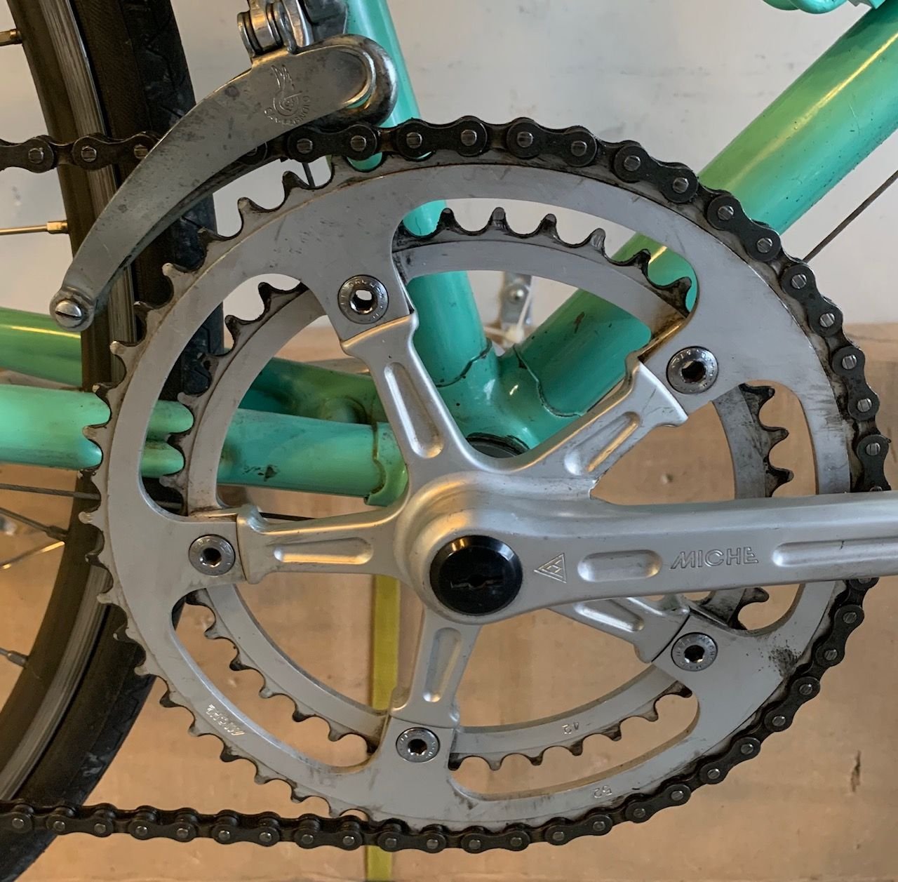

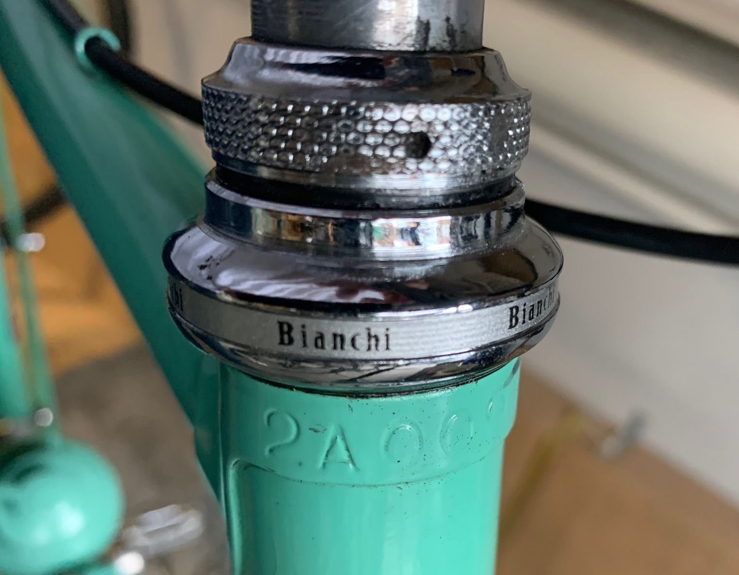

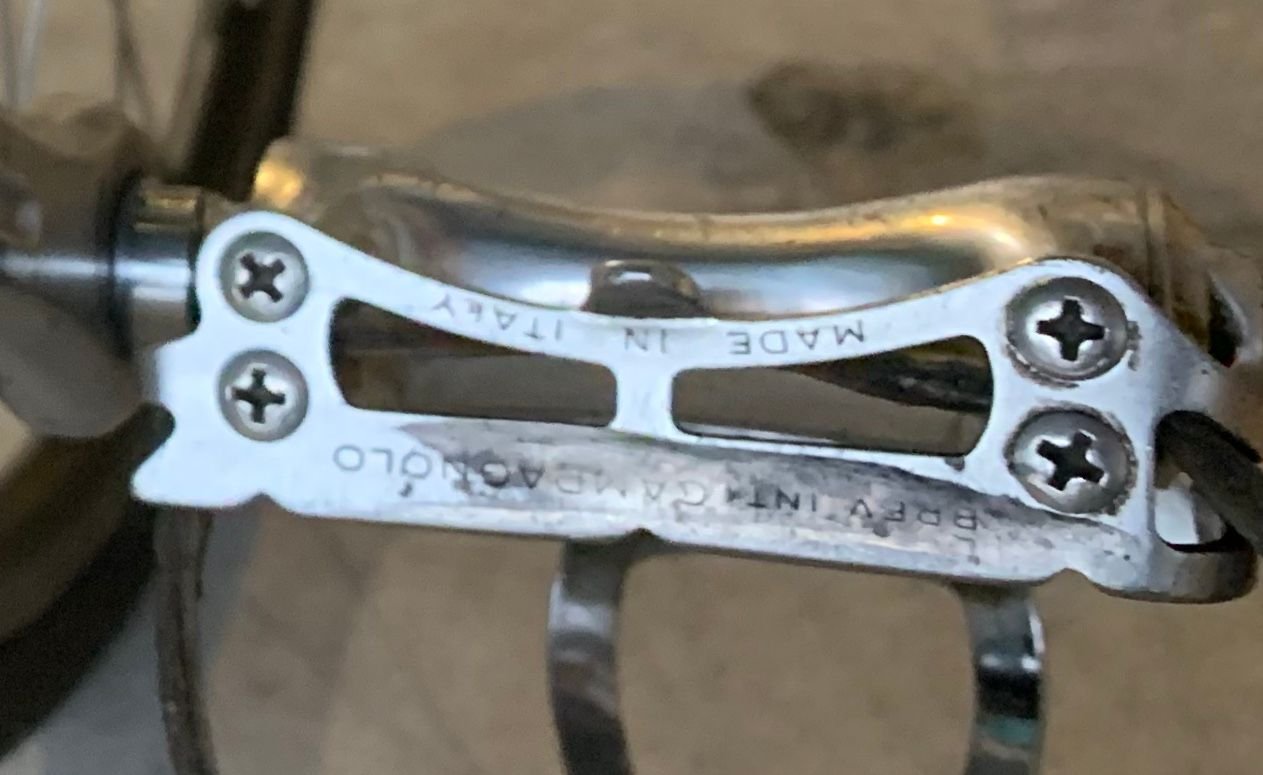

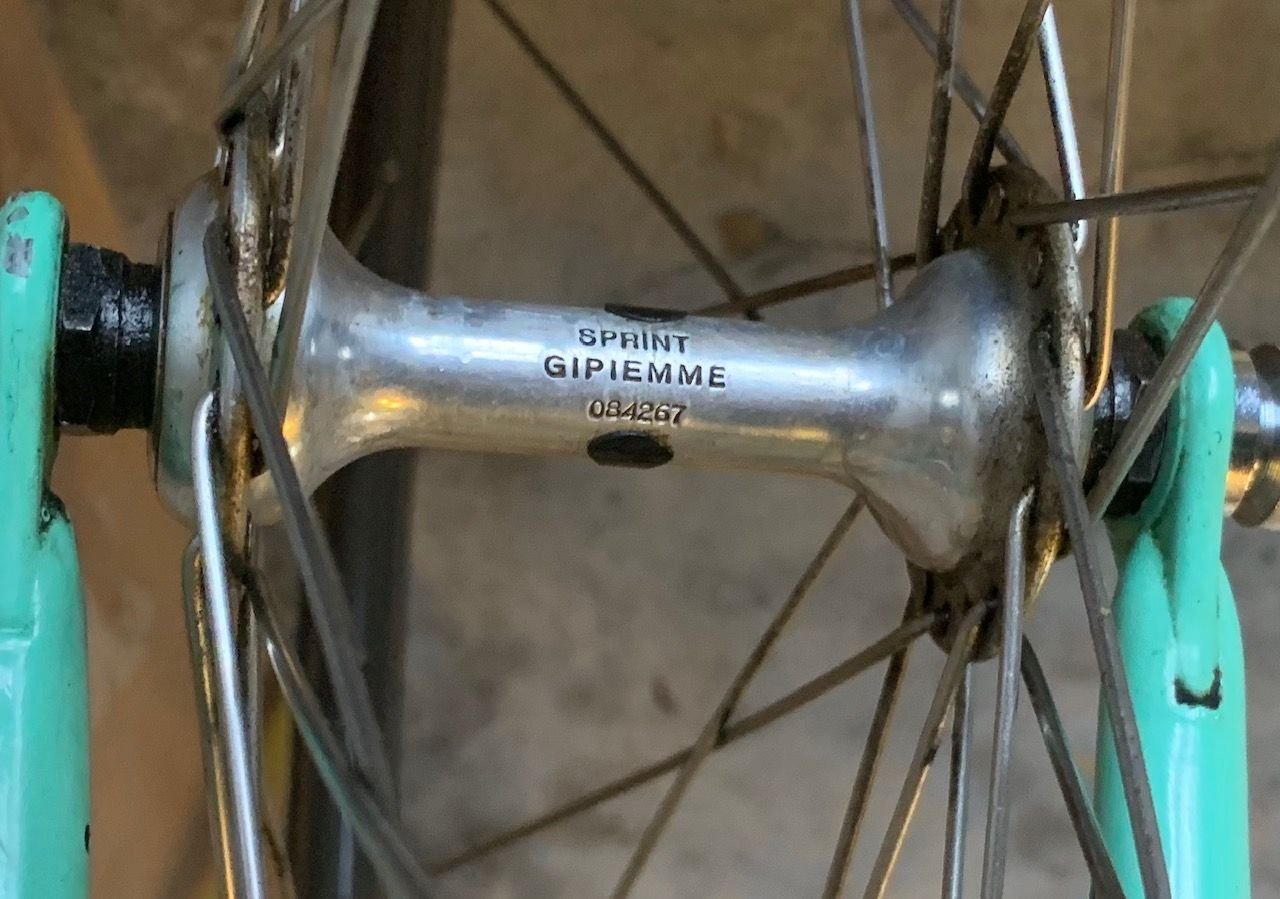

OK, friends, the moment of truth - though I believe T-Mar has already cracked the case without the benefit of photos. He’s certainly bang on with his Campy 980 prognostication, judging by images I’m seeing online against what’s on my bike. Still, I’d appreciate any input / theories / objections anyone might want to add, particularly with regard to the metal badge I haven’t seen in any catalogue. Note all components are original except for the brakes/levers and rims. BTW, I am under no illusions that this is anything but an entry level bike. I would just like to know everything I can about it, period. And, honestly, I can’t believe how well it runs after almost 40 years of heavy use - as well or maybe better than the second Bianchi in our garage, a late-80s Campione d’Italia with Columbus tubing (27.2 mm!) Or maybe I’m just partial to the first bike I ever bought with my own money.
walterb is offline
Likes For walterb:
Old 10-22-20, 05:48 AM
T-Mar
Posts: 20,868
The photos largely confirm the earlier assessment. It's definitely 1982 Italian manufacture. The frame is lower level and a lightweight hi-tensile steel, almost certainly Bianchi Calibrati 1-20. The derailleurs are level and era appropriate Campagnolo 980. Besides the previously mentioned rims and brakes, the pedals would also be replacements, as they are too new. I would have expected a swaged crankset.
Whenever we see these rectangular head badges, they always seem to be on European, early 1980s, lower level models. That would explain their relative rarity, as the comparable American models were sourced from Japan. As stated earlier, Canada sometimes imported some European spec models. Some larger dealers would also sometimes bypass the distributors and buy directly from Europe, in order to get better pricing.
Regarding the model, the degree of non-originality and an entry level European model complicates identification, as most forum members are American based and familiar with USA market models. A Sprint variant is still a possibility but it could also be one of the lower Rekord variants. Your best option might be an attic search for the elusive receipt.
