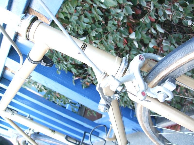

With the cooler, darker evenings these days, I decided to hoof-it 2-1/2 miles to the shopping center across town where Goodwill resides.
A nice 28 minute jog, and greeted by some newly-arrived bikes at the store. I selected a $49 Nishiki Colorado mtb having little use and from the era (1991?) of the older-style (push + push) Rapidfire levers. Good enough to have a cassette hub, DB CrMo F/F and alloy Deore 500LX chainrings, so a pretty good deal.
I then waked past the forbidden hallway that leads to the stock room, and peeked through the door window (that in itself nearly enough to get questioned at this store). I spotted a road bike in my size ~57cm with missing saddle and post and appearing to have a Phil front hub!
I inquired about it and found out that had been tagged @ $25, probably because of the missing bits. I got them to roll it out and was pleased to see it was a Nishiki Pro with very-mixed componentry: CLB brakeset, Phil/MA40 wheels and early 600 SIS shifters and rear derailer, plus Cinelli bars/stem and Mighty Tour Triple.
So I ran both bikes home after paying the sixty-something dollars after the senior discount. I took the long route back, further from traffic, 3 miles including one stretch of completely dark dirt road with many deep potholes followed by a very steep paved descent. I did this run in about 45 minutes with one bike's stem in each hand!
So after measuring up the bike and finding it was a perfect fit with preferred 74-degree race geometry and 10cm stem, I added a 27.0mm Record seatpost and one of my old saddles for a test ride including the gravel trail along the tracks.
I later measured the inflated tires on the MA40 rims. The Specialized Touring 28mm measured only 23.0mm wide and the CyclePro 25mm tire measured only 21.5mm wide.
New tires, cables and tape to follow in the near term (the bearings were all smooth and felt well-lubricated).
The mixed componentry I discovered is no accident, since these were only sold as framesets, so I dated it to 1978 by the "782" serial number prefix.
Sorry my camera can't take decent photos at night, or with direct sunlight nearby, apparently!

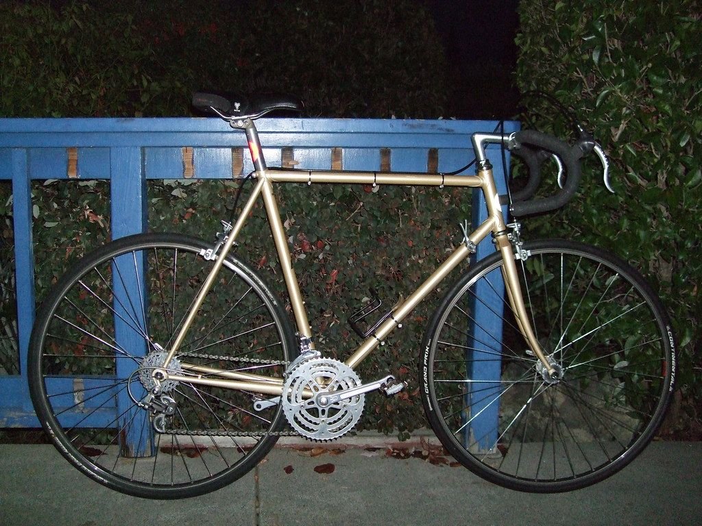

Adding a new photo after rehabbing the bike yesterday and today.
Wider, deeper-drop Cinelli 66 bars replaced the 38cm Model 64.
Full frame scrub, headset rebuild, new cables, and the 5s Winner freewheel got full (every tooth) grinding modification mimicking Uniglide's twist.
Bike-Ribbon cork tape was barely long enough for this Merckx-bend bar in a 42cm width. Conti 4000 rear and GP front in 25/24mm widths mounted on the narrow MA40 rims.
I'd always heard that these CLB sidepulls were weak, but with the new cabling and the old Dia Compe pads that the previous owner added decades ago, the brakes feel linear, smooth and strong against the anodized rims.
I weighed the bike after everything and got 22.1lbs including pedals and bottle cage! Heading out on an evening ride (back to Goodwill where I found it!) as I write this.
