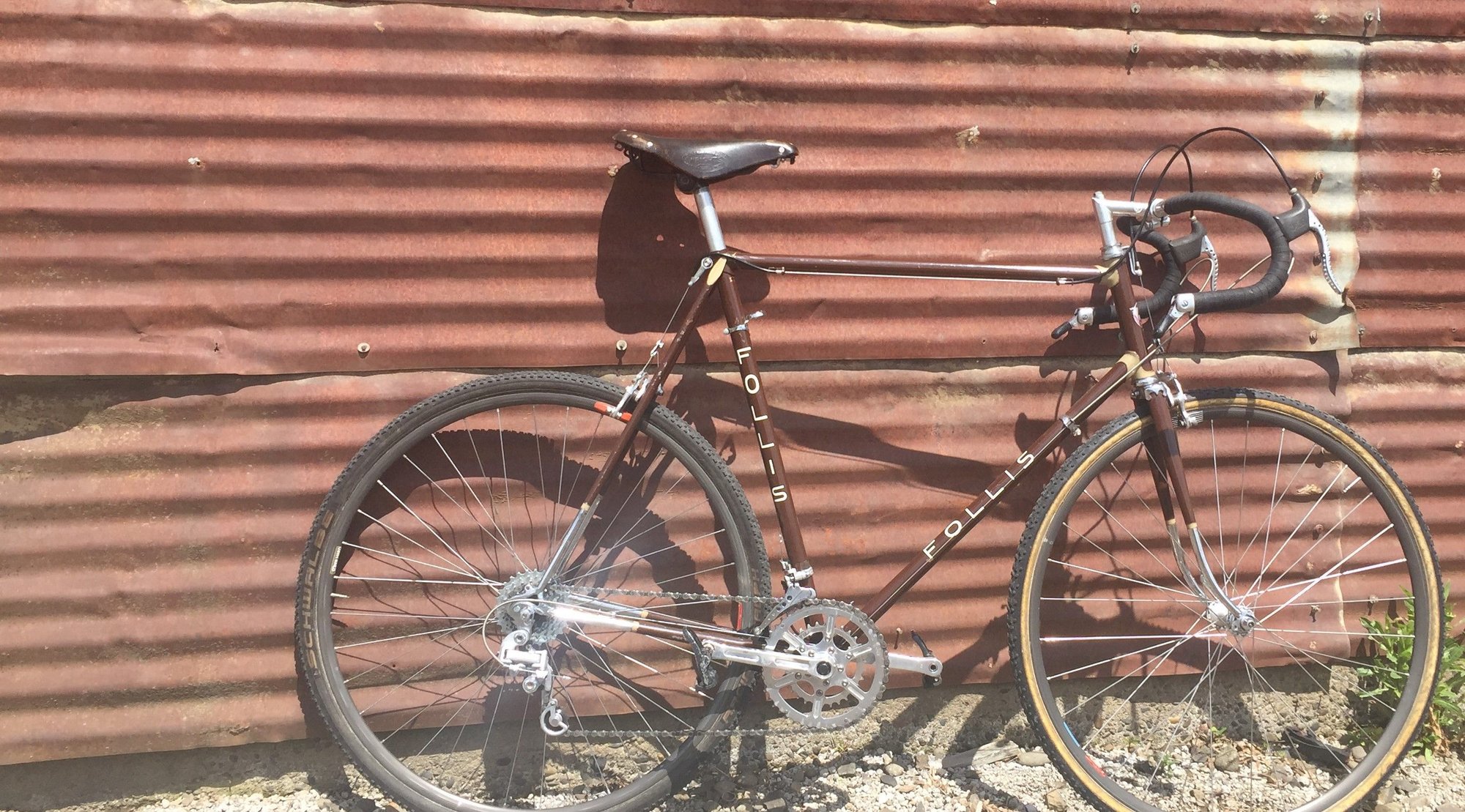

I have a 58cm French bike, less wheels, that you can have.
I would have to check standover, but maybe 'french fit'? HaHa.
Unfortunately, not as 'tuned' as a custom race bike.
Something maybe to try 650b, until you find a better way.
Follis brown.
Unflatering pic is all I got now. Ran 700cX33 with knobbies, so guessing 650b 38/40mm might work, but never done a conversion.
Follis brown.

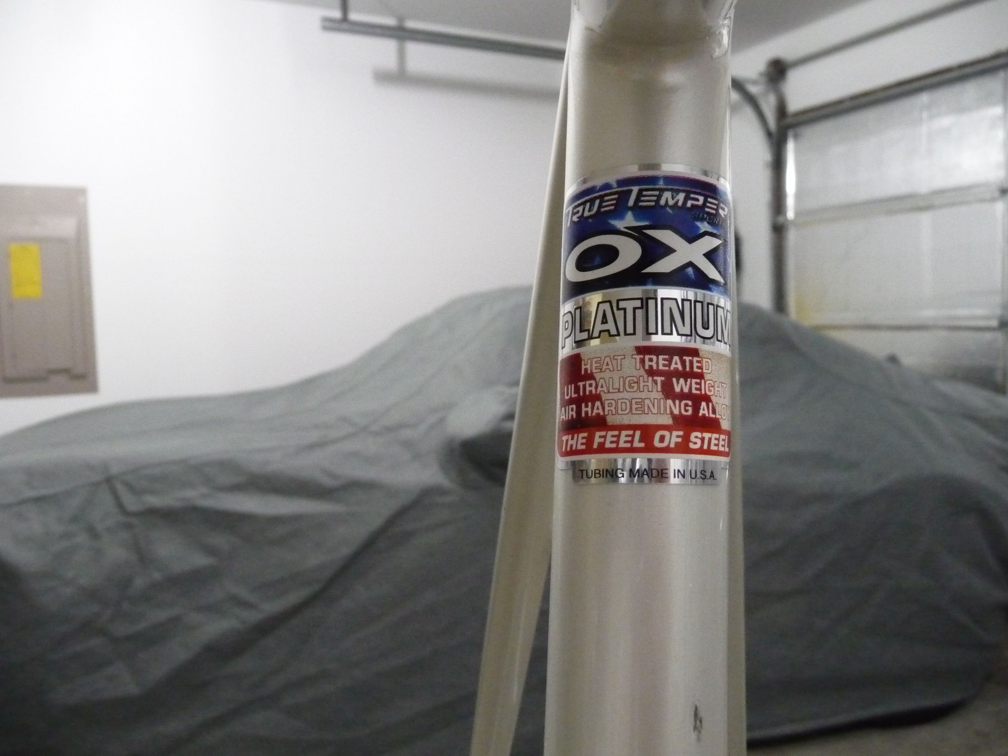

Stevenson photo?
Bill Stevenson, " WD ", was a big influence in my early days of cycling.
I grew up in Lacey, class of 80 Timberline High
it's on my bucket list to go back to the area and do some riding
Could you post a photo of your Stevenson?

Here are pictures of this frame, sorry no side on as it is at Bill's where he is building a lugged fork to replace the carbon fiber fork which was the rage around 2000. He will also strip the frame due to many many paint issues, so it will be repainted, new decals and his signature on this custom build from 2000.
And good as you could get tube set.
Long story short, return to original. This is a racing frame, made for 700c rims and at most, and it's really tight, 23mm tires, so make it as it was, but with modern 12 speed compact double and cable rim brakes.
Oh and yes the braze on, on the drive side chain stay, were intentional, for a stainless steel metal guard to ride over the chain stay protecting it from chain slap, no idea why, but that's what's great when you build your custom frame the owner got what he wants.

It's all opinion, but that fork wouldn't live on any frame that I have. It looks very limiting, not to mention the negative vibes on the aesthetics. In my experience, it really isn't that hard to find either a suitable fork, respectable rims, or caliper brakes for a build. Yes. you may need to build your own wheels, or order new, but it's neither rare nor expensive (in the grand scheme of things). I have bicycles built with 559 rims, 584, 590, 622 and 630. I think that on that frame, if you want wide tires, you can rule out 630, and may have issues with 622. 590 or 584 would seem the most likely to be workable with rim brakes. Tektro R-559's are awesome, attractive and very reasonably priced brakes.

USAZorro totally agree on the carbon fiber fork.
That's why I've asked Bill to build a steel lugged fork so that the entire bike is his build. Oh, and instead of the compression ring on the seat tube, which always rubs away the paint, he's going to add a real seat post bolt braze on.
