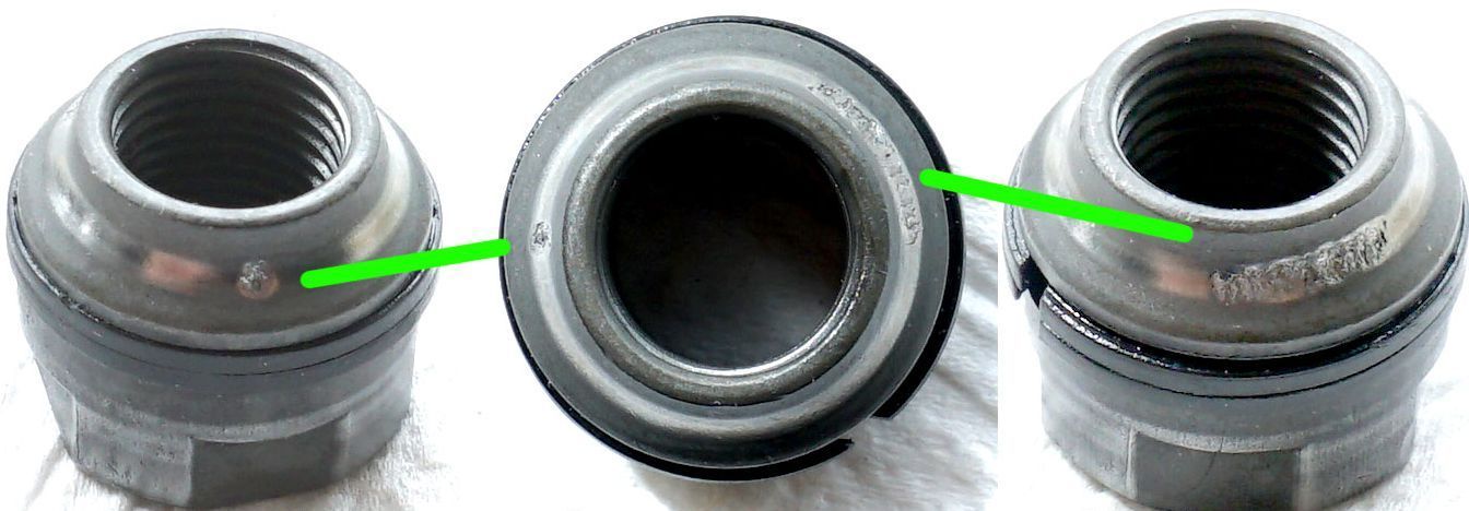

The rear hub was not turning smoothly, and the right side cone was severely pitted. I replaced the cone and the balls.

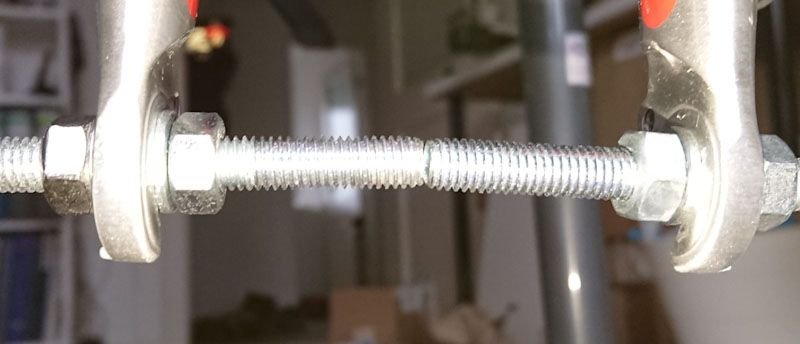

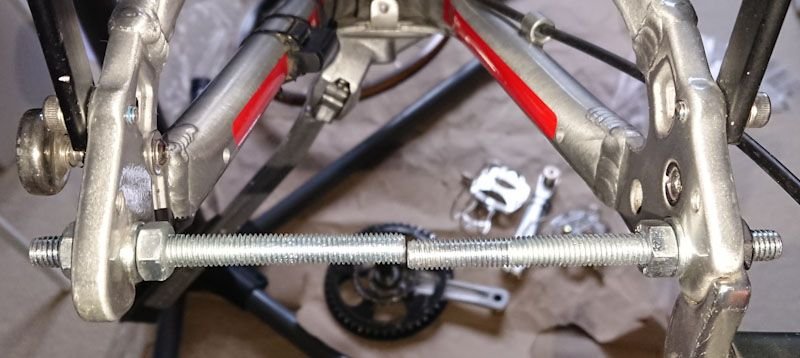

I checked the rear fork end alignment by nutting bolts to each fork end and letting the tips touch at the center, but they're off by a few degrees. The rear is maybe off 2-3 degrees and the tips are misaligned by 2mm. The dropout is 131.6mm at one side and 131.0mm on the other. When I squeeze the fork ends to 130mm, the angle and misalignment reduces a little bit. When I insert the rear wheel, and tie a string from the dropout to the seat tube, the distance between the string to each side of the rim wall is only offset by less than 1mm, so I don't think there is an alignment issue between the rear wheel and the frame.
The front fork ends are off by a higher angle by around 3-4 degrees, which increases a little bit when squeezing the fork ends to reduce the 75.5mm spacing to 74.0mm, but the bolt tips are centered.

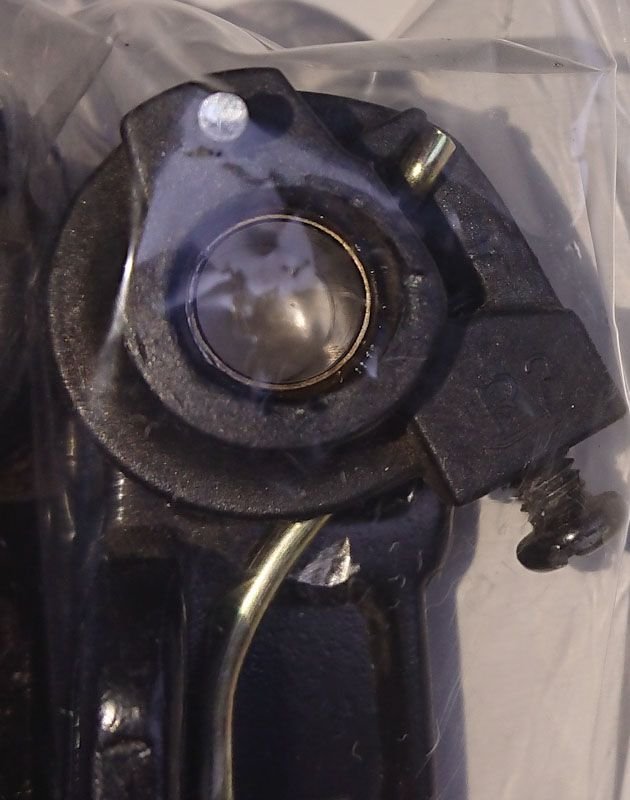

What I meant with the worn groove in the Dahon (Tektro 857AL) brake arm, is that during braking while the bike is moving, the spring digs into the groove and slowly makes it deeper. I suspect that when the spring gets stuck in the groove, it reduces the amount of spring force, so the movement speed of the arm is reduced. The groove on the right arm is much deeper than the left arm, so it's possible that when braking while moving, the pads are not engaging and disengaging at the same time, and the right arm is lingering longer on the rim.
When adjusting the centering of the brake pads while off the bike, the spring doesn't dig into the groove because I'm not applying as great of a force on the brake and the arms are not bending forward as when braking while riding. So even if I adjust the pads to center while I'm off the bike, when I am actually braking while riding the bike the pads may not be touching at the same time due to the spring getting pushed into the groove.
I've changed to the Shimano BR-T4000 brakes, which has an internal pivot, so it doesn't pivot on the boss and has less play in the direction of travel, and the springs run on the outside of the arms, instead of directly and behind the arms like on the Tektro.
The spring dug a groove into the back of the brake arm.

Well, it took 13 posts to actually say what kind of brakes these are and what kind of bike this is. On the other hand, this allowed you to figure out the problem by yourself, which I think you kind of did. I guess that this is an indicator of how the human mind works: the rim is worn asymmetrically, so we think its the rim or wheel or lacing.
I think that perhaps that the spring you noticed was the issue, but perhaps it was digging in or gouging, and not just wearing. Could this be happening? Rather than an issue with wearing a deeper groove, I would suspect that the spring was gouging out material (too short a spring) and that this formed a mechanical stop. So when you squeezed your brake lever, one side would advance to that stop - just short of the wheel rim, but then would hang on the de facto stop that the gouging spring had created. This meant that the other side would contact the rim but not the stopped side.
If you feel like it, reinstall the offending brake, take off the wheel, and squeeze the brake lever. If one side moves and stops while the other swings over the full range, that would be definitive. But if both arms swing the full range, then this is not the issue.
