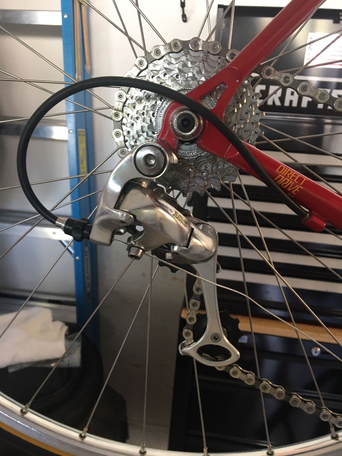

Chain line is good, cable is brand new, and this pic shows big-big.
I thought of the hanger being out of alignment, but visually it looks good.
Without the tool I don't know how I'd check it more exactly, or tweak it.

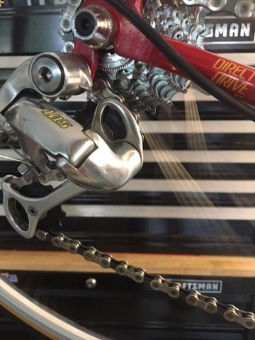

Show a picture of big (F) small (R)

That looks good.

Chain length looks right to me. I think you're good.
You might want to play with your B screw adjustment, and see how that affects things. Usually I shoot for the RD cage to be a bit more parallel to the chainstay.
RE checking your hanger alignment without a tool, it can be done. I've always had a tool and but like I said earlier, you can do it with a rear wheel. Here's a video from RT:
I like to adjust the derailleurs without using brifters at all to start with. Yank on the cable by the downtube to shift.

Can you post another image taken from the rear of the bike and looking towards the front? The one you posted earlier is too small to make out details.

The B screw shouldn't need to be super optimized just for the RD to drop the chain into the smallest cog. Assuming the hanger is now close enough to aligned, that really only leaves friction issues. This could be isolated by disconnecting the RD from the cable completely. Shift it into the 13 by moving the parallelogram with manually, ie with your hand, and then let it go. If it drops right into the 12, then you have a hang up along your cable somewhere. If it still won't drop in, there's not much left except a still bent hanger, stiff pivots, or a weak spring in the derailleur. Maybe a tweaked jockey cage. I'd make sure your cable is moving smoothly first.
Personally I advocate plenty of grease. No cable has not moved because it had too much grease. However, if you are using high tech prelubed cables, along with the correct matching housing, you don't need too. OT but this was a big religious debate when lined housing first came out.
Also make sure any linings are properly opened up with an awl, and housing ends are ground smooth.

I believe that the type of derailer housing is the problem here.
This is the old, very stiff 5mm housing that prevents the rear derailer from floating about the cassette properly under it's dual-sprung movement. No bueno.
If the housing were longer it would be less of a problem, but this derailer is from the 4mm housing era and needs more flexibility there.
By the way, did you perhaps use any grease on the cable? What you want for best shifting and strong return action toward the smallest cog is some original pre-lubricated SP-41 housing, 4mm in diameter and of sufficient length for the guide pulley to track the cassette profile.
And the cable guide at the bottom bracket should be plastic, or with plastic noodle at least guiding the cable there.
I bet this is the problem!
Although the cable is greased, the housing is definitely old, and stiff.
(The cable guide on the BB is plastic, and I even have that lightly greased as well.)
