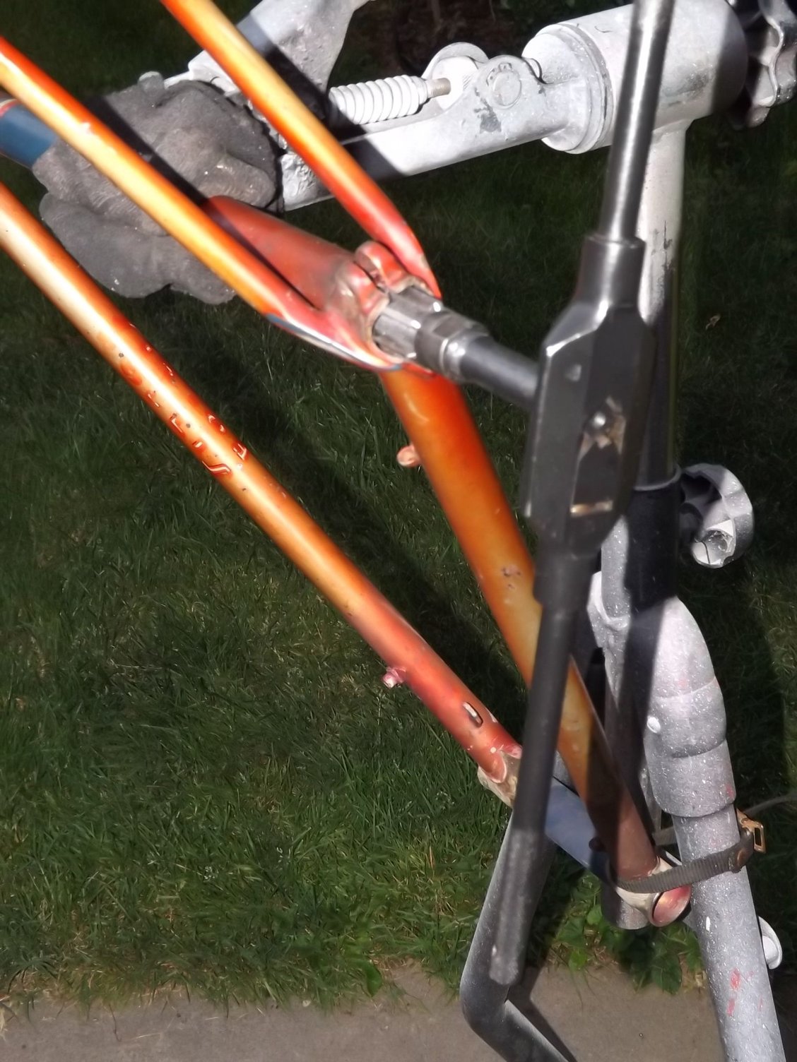

...here is the setup I used recently on a restoration of a 50's follis. It's pretty simple, but in this case requires a stand.
What seems missing from this discussion is the somewhat imprecise manufacturing of seat posts, and the historical fact that many of them are not sized exactly as marked.
So sometimes a 27.2 marked seat post actually measures smaller, like 27.1. And it's pretty important to figure out what the actual tube inner diameter is down in the seat tube, not up at th e post lug, which can get distorted by heat in manufacturing or by subsequent abuse, by the owner. Anyway, I usually just go with sanding down the larger post, as easier than reaming. But in this case the seat lug was ovalized, and the set tube was exactly 26.0 inside farther down.
