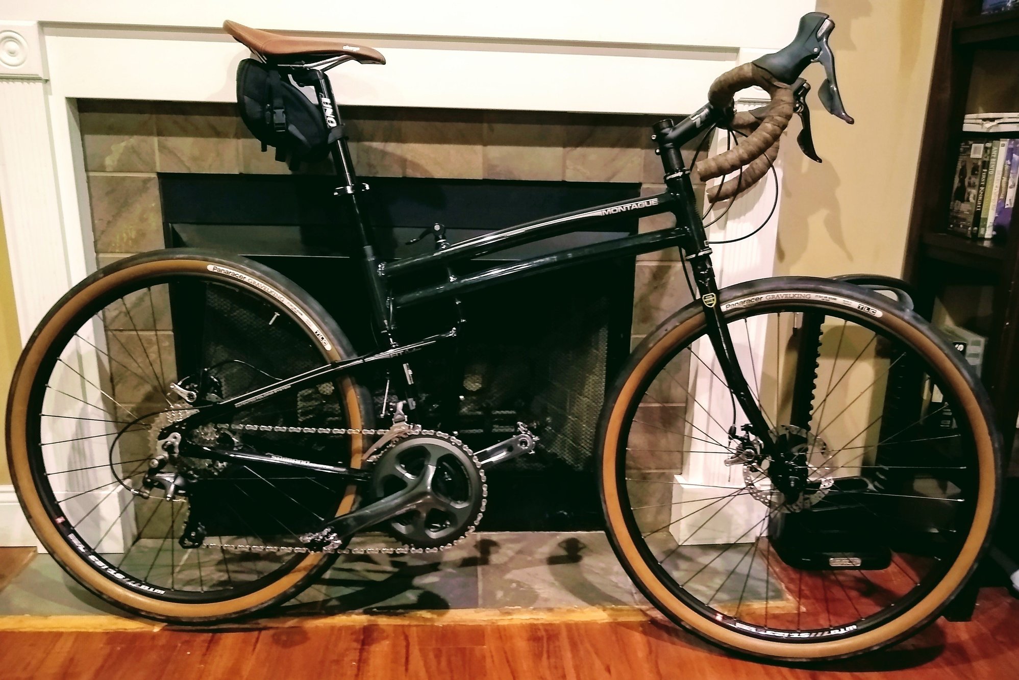

Originally Posted by pcb View Post
Baby got new wheels. I think I posted this over on the "Whatcha Wrenching?" thread, but since 650b is so integral to what the bike is today, thought I'd update here as well.
I started de-tubifying a bunch of old wheelsets, and got myself a neo-retro set of "new" wheels built with vintage Campy 36h high-flange road hubs, liberated from a trashed tubie wheelset, and brandy-new Pacenti Brevel 650b clincher rims. Swapped the road axles to track, used a bb lockring to snug down the fixed cog on the freewheel threads, and Bob's yer muva's bruva. The wider Brevets get me a little more width, now about 33mm at 75psi-ish riding pressure.
Updated photo shows the right-side dummy brake lever, a huge help on the road. Since this photo I scored a 172.5 Campy crank to replace these 170mm arms, and a set of BMX MKS chain tensioners that fit the fat/thick rear ends/dropouts better. Not much of a visual difference, but I like longer crankarms, and when you can't stop spinning, the extra 2.5mm is a help. And with a shallow bb drop only 55mm or so, the extra 2.5mm crankarm length shouldn't give me any cornering problems.
Finally got a proper ride on it with the new wheels, and it works really well. Fairly well-mannered on the road for a frame purpose-built for track racing, the 650b wheels/tires scrub off the harsh edge of skinny 700c tires without much muting the frame's aggressive nature. This is definitely not a 650b conversion that has me floating over all manner of road irregularities, and though trail-able, it sure wouldn't be my first choice for that. But I managed a respectable 28mi ride feeling worked pretty good, but not beat-up.
Very, very pretty and it has to be vastly more enjoyable on real world roads, even if you couldn't fit big rubber on it.

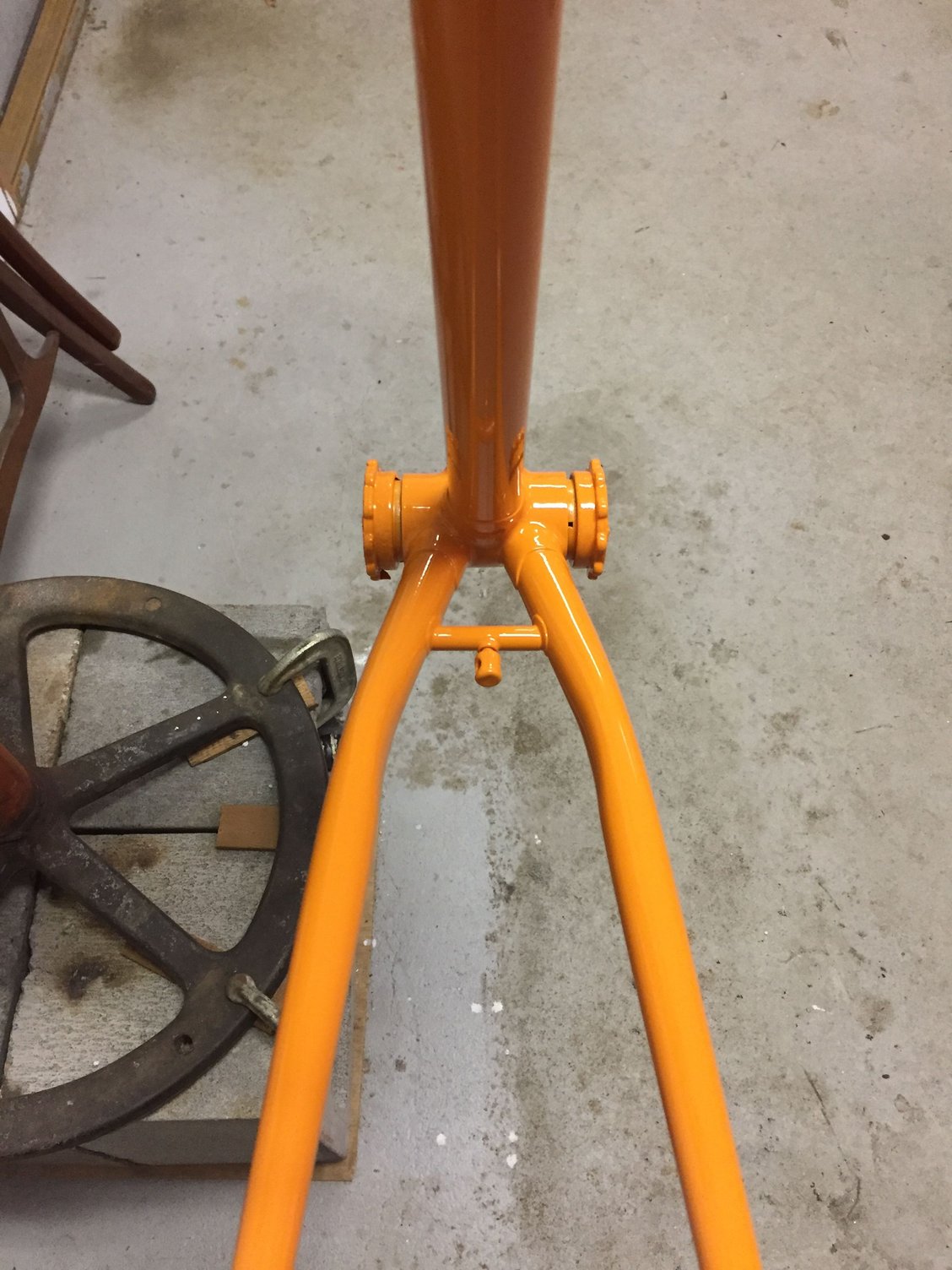

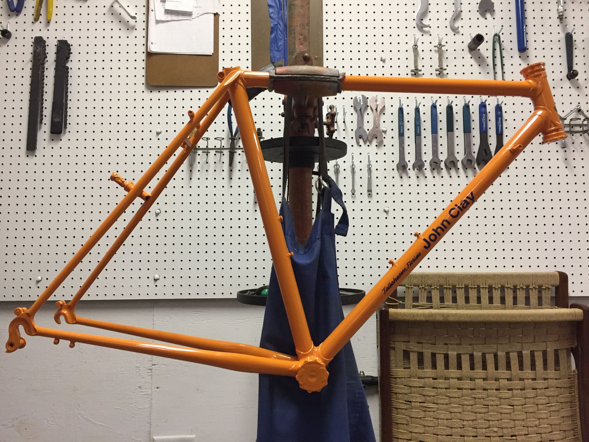

Not a conversion, a new frame from my shop...and not 650b, but spiritually and functionally singing loudly in the same choir. Still, I thought y'all might like a look. The 559x50mm Rat Trap Pass tire is a better 650b than 650b, though a bit more challenging to fit! This is for one of my brothers; the one still in Tally; but it's entirely possible that an encore will end up in Modena, Italy for my oldest brother... though he already has one of my frames, if for the relatively skinny McClure Pass tire. And you didn't know that "Clay" was an old Italian name? This is the first one with my name on it; I've focused my energies exclusively on the frames, not the advertising. But it's time. How'bout that nearly Molteni orange! And the chainstays...Big room for big rubber, and associated fenders. The paint's been curing in the attic for a few weeks so I recon it's about time to build it out.
Happy New Year, all!

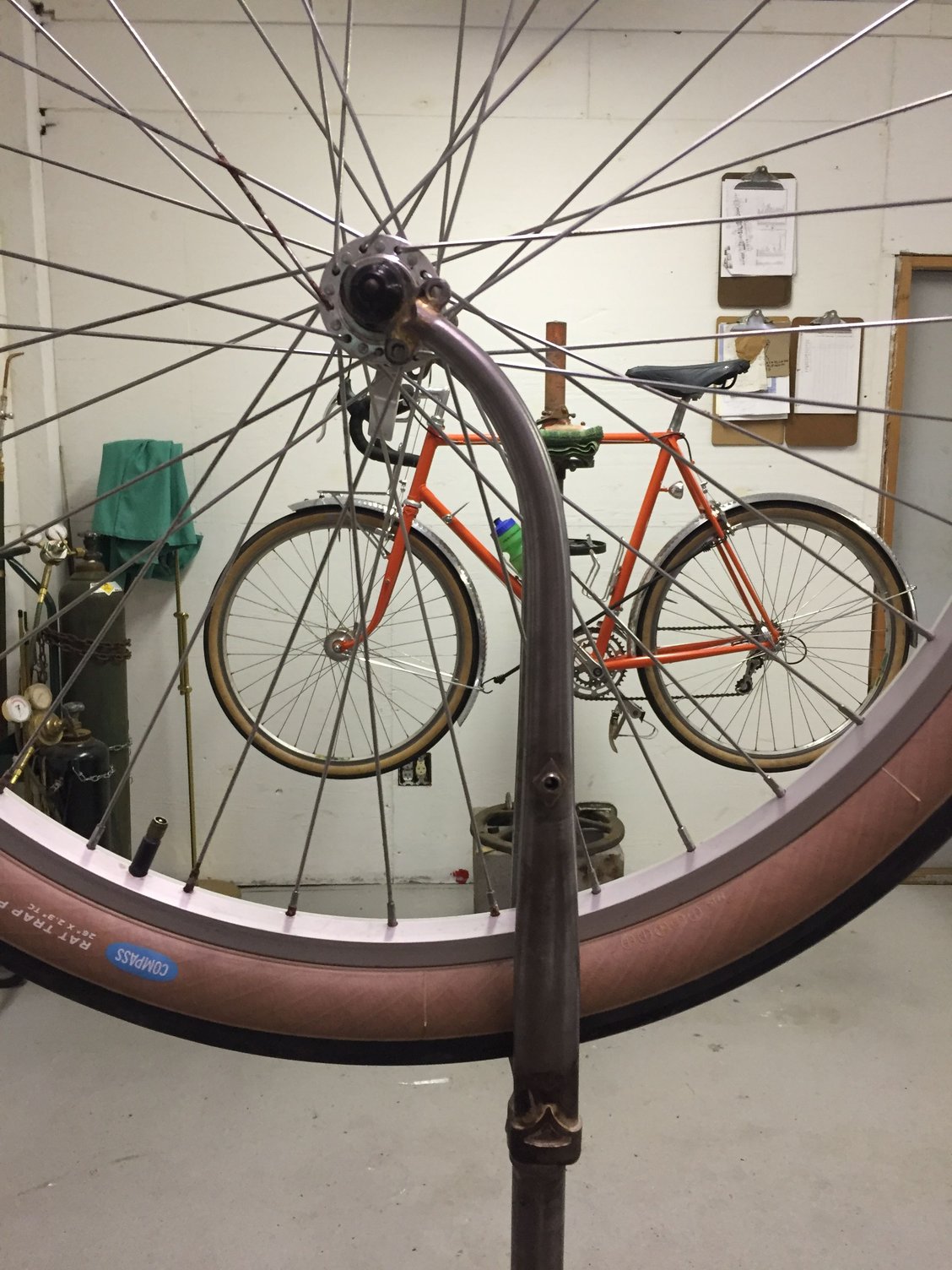

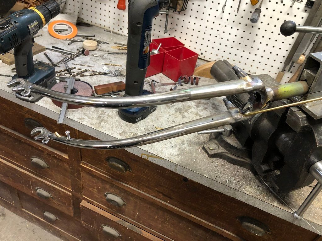

PSA: Low and tight fork raking available; ping me off-list if you need such.
I'm also refining my ROR chainstay bending to accomodate 60+mm fenders none/minimal stay crimps. I can do that on an experimental basis for other builders; some in-process photos, here: https://www.flickr.com/photos/216244...57717250289361
Electrical Slip Ring fabrication photos for general how-I-did-it info (the Hirose approach, smaller hole in the steerer tube), here: https://www.flickr.com/photos/216244...57710996851941

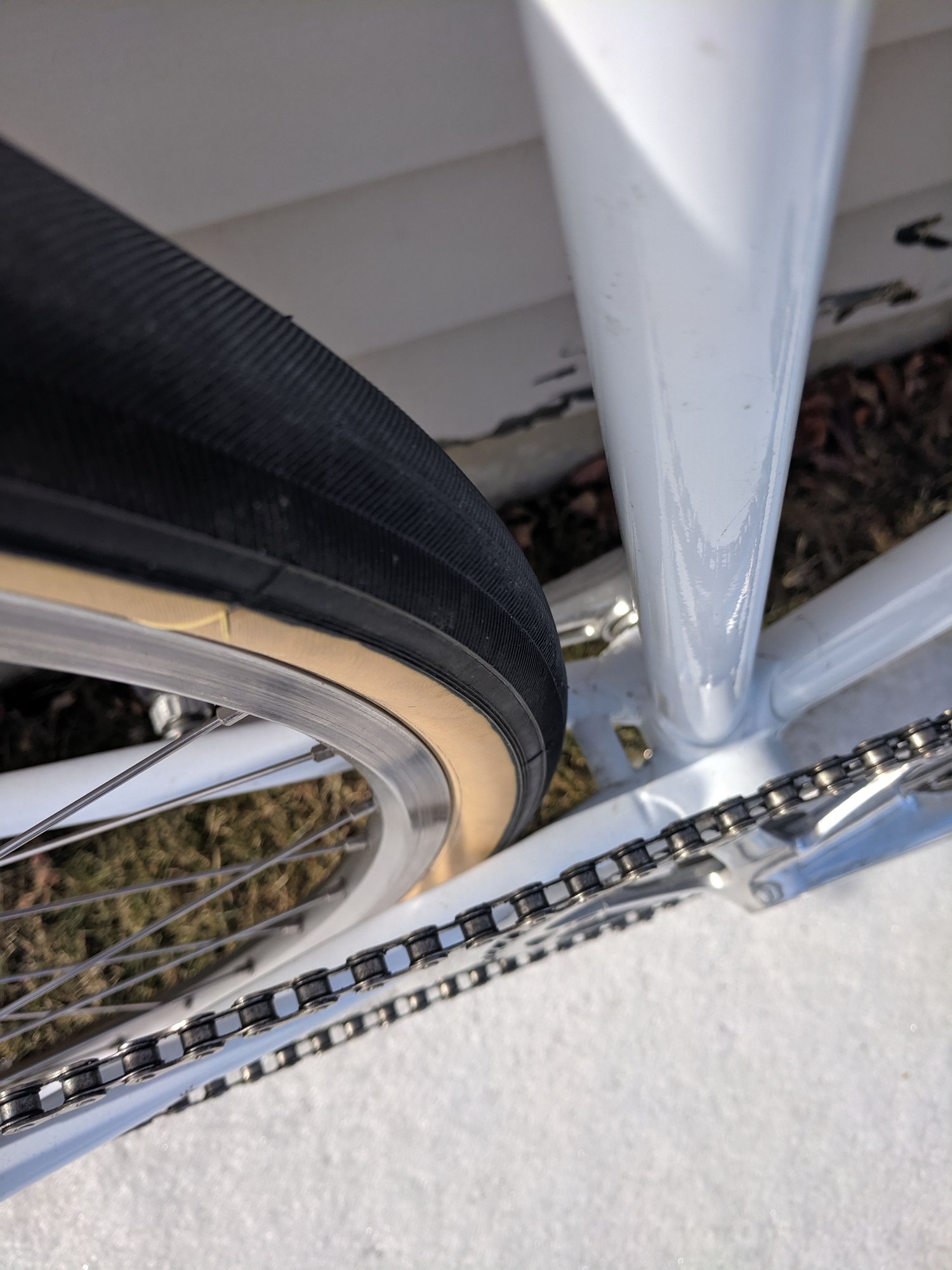

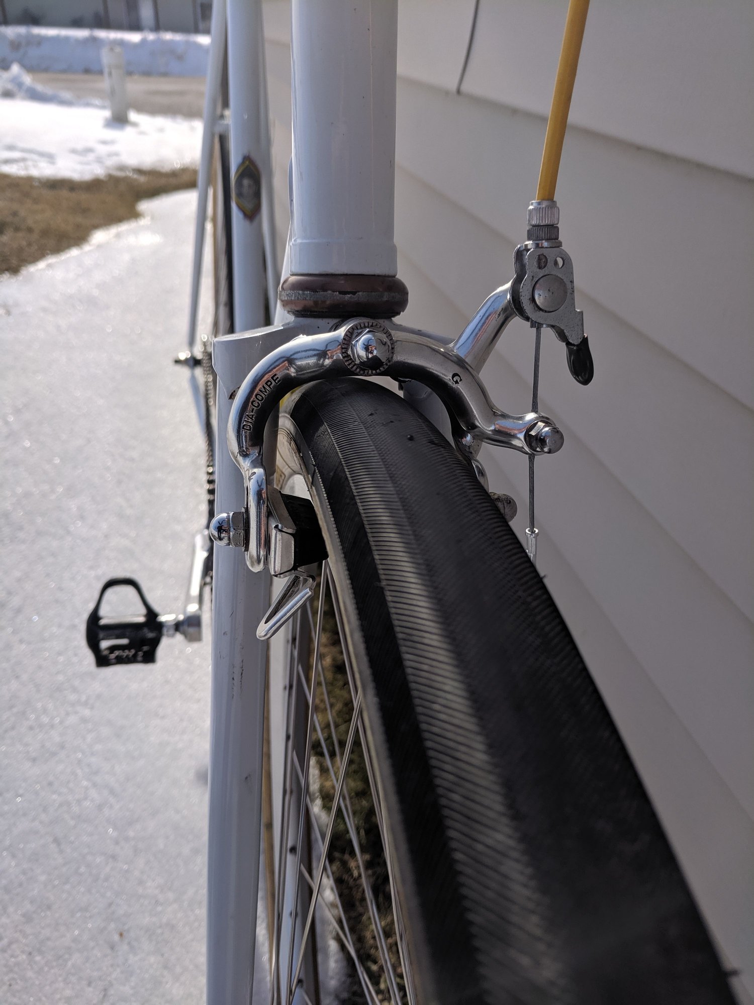

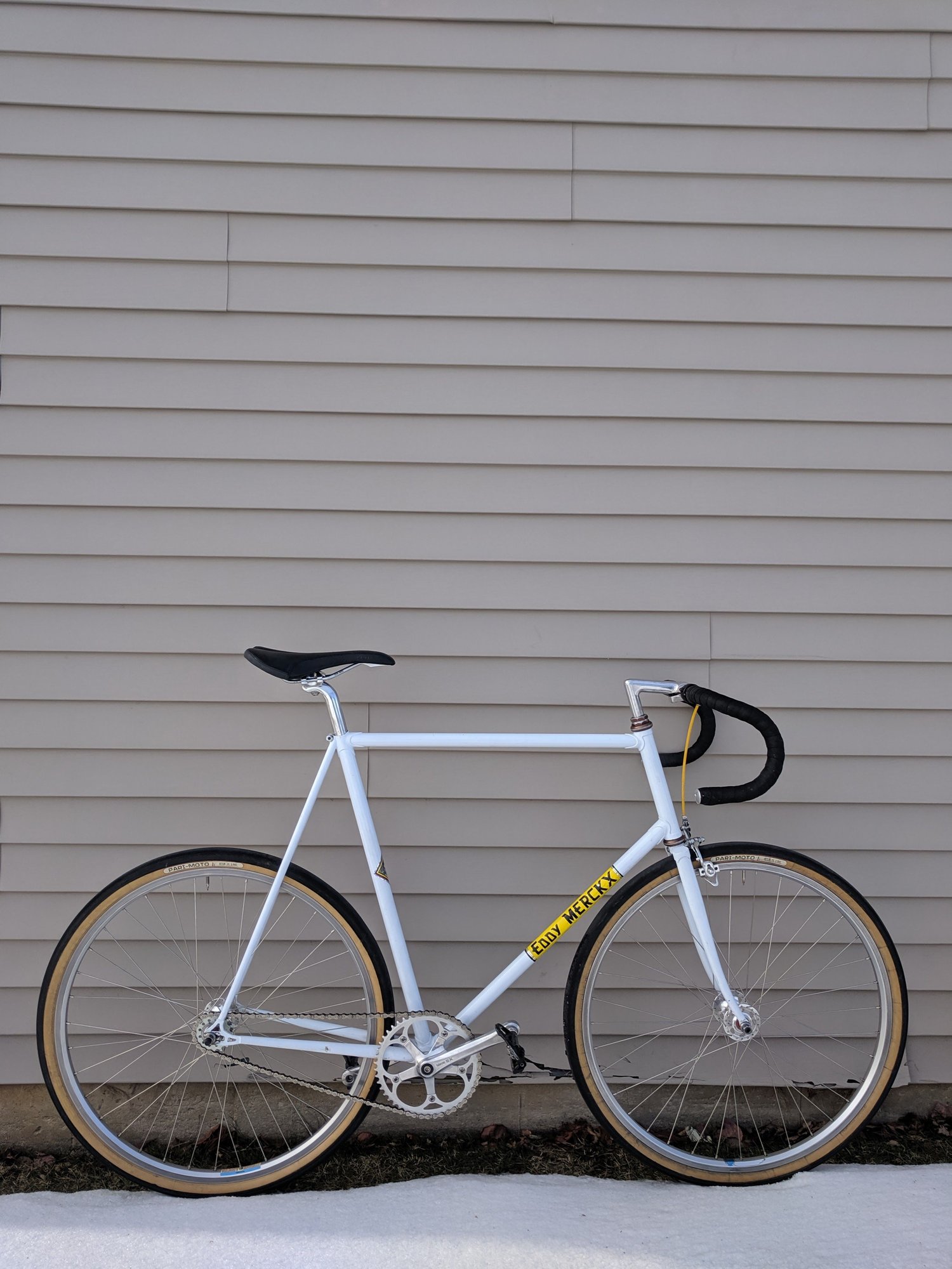

Something a bit different - an amateur built Columbus SL track bike with 38mm Pari-Motos. This fork would just barely clear 700c X 23 and there was no clearance for a brake, hence the conversion.
48x17 gearing should land me in the 72" range.
37mm actual in the rear and 39mm actual in the front. Barely enough room in the back, I'm hoping the wheel is stiff enough to not flex too much. A little ride around the neighborhood last night gave me some optimism that it will work.
Now it just needs to not be 10°F so I can go have some fun
That fork bend is really nicely done! And I've been following your electrical slip ring project... really nice stuff there!

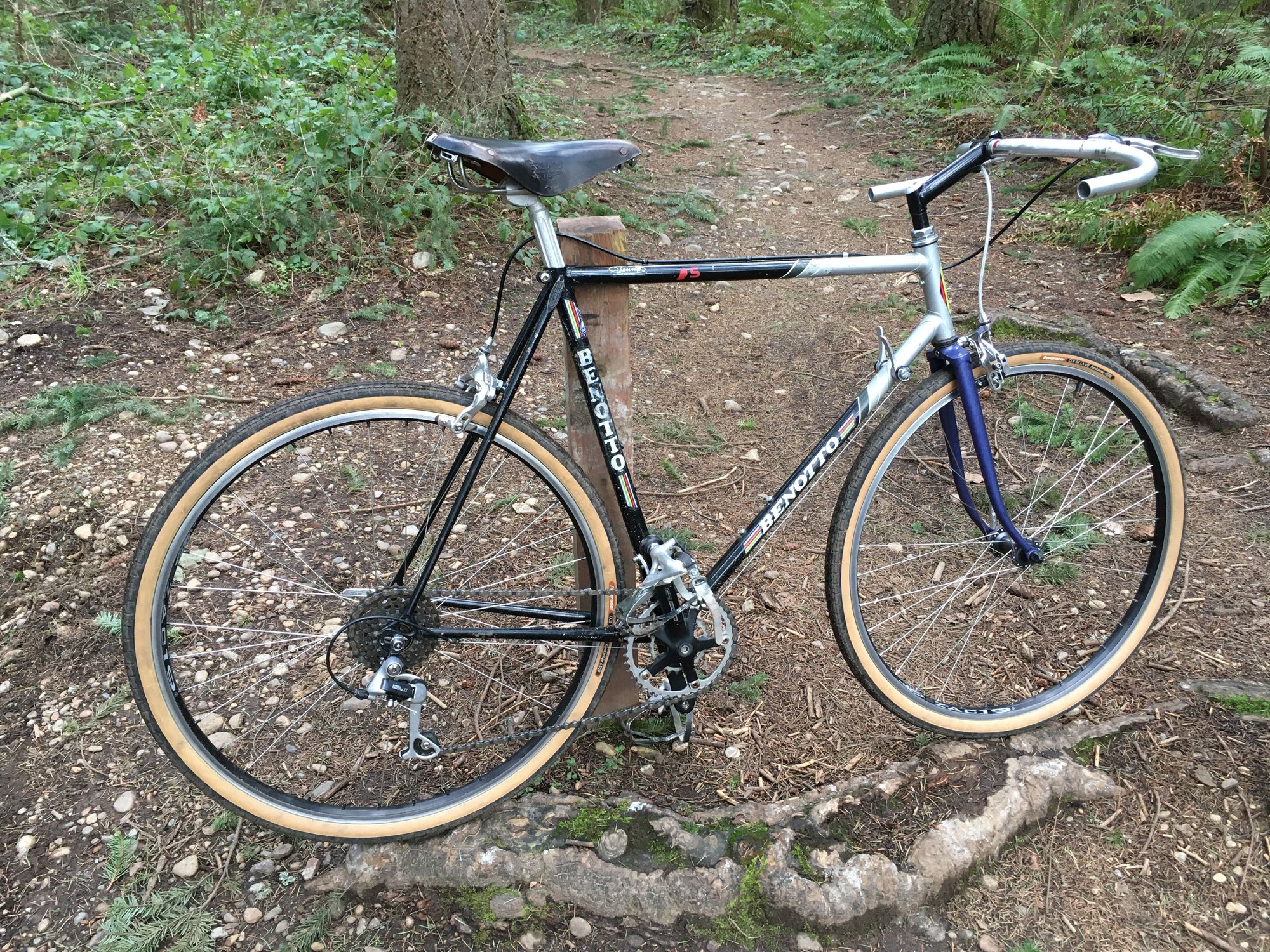

Not exactly vintage, but I was going for that effect anyway. The Montague Fit is designed around 700c wheels, but the disc brakes made for an easy swap.
I could only get a 30mm tire on the back, the vestigial brake bridge being the only obstacle. With the 650b wheels, I've easily cleared 48mm Gravel Kings.

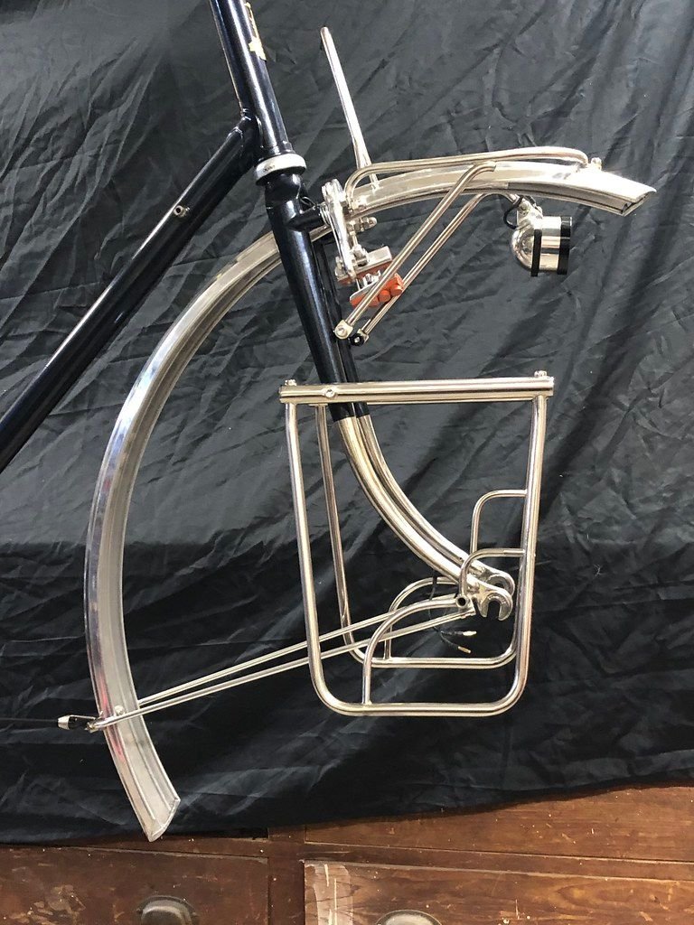

Raleigh Super Tourer - now with 10% more Gugificazione!
This one started out as a "standard" 650b conversion + powder coat. Customer decided that a custom front rack was desired for randonneuring, but why not some custom lowriders to turn it into a campeur when desired?
Here's the list of mods:
1. Reraked fork to obtain 35mm trail
2. Repositioned rear triangle bridges for proper fenderline
3. 3 sets of Bottle bosses, BB cable guides, shifter bosses, relocated brake cable slots and used slotted bits for ease of rinko
4. Modified Lezeyne road pump (added spring) and brazed pump pegs on the non-drive side
5. Custom handlebar bag rack
6. Custom low rider racks
7. Patched a few small dents
8. Internal fork wiring for generator hub
9. Seat tube tail light by Velo Lumino (our own @southpawboston, proprietor)
10. Spread rear dropouts to 130mm for modern cassette usage
11. Brazed in a 7 o'clock stop on the 4 o'clock stop on the Huret derailleur hanger
And then, a curveball.
Ever since I saw a description of Rene Herse's slip ring conductor method of supplying power to the tail light, I've wanted to do it. I've been playing around with some ideas on how to do that. Then Jamie Swann posted step by step instructions. Customer wanted this badly, I decided to give it a whirl. I didn't do an SL dropout conversion, instead I brazed a brass tube through an enlarged vent hole near the dropout and had it reappear just below the fork crown. So we decided to do that as well.
Randonneur mode without low riders
Campeur mode. Note that I only have the upper bolt installed. Properly fitted the bottom attachment co-locates with the fender stay attachment, which would use a longer bolt.
Centerpull posts, polished MAFAC RAIDs, rinko'ed fender, pump pegs for Lezeyne road pump (modified with spring
The M4 screw is brazed into place and used as a "ground" or return path for the generator. The entire frame is part of the electrial circuit on this bike.

Benotto 2000 -- 650b x 38 cdv
What's the first thing you do when you convert a notoriously fragile road frame to 650b? Take it to the city's mtb trails of course!
Freshly build wheels are budget-friendly Zac19s I laced to a Nouvo Tipo rear and a ritzy shimano slx disc front. Moustache bar gives it an XO-vibe. Always great when shakedown rides leave nothing but a slipped brake cable to fix.
I'm still not completely sold on this frame being the home for these wheels. As of yet, it's near the top of my list but there are a few others I may have to move everything over to test out.
No cracks yet!!!
