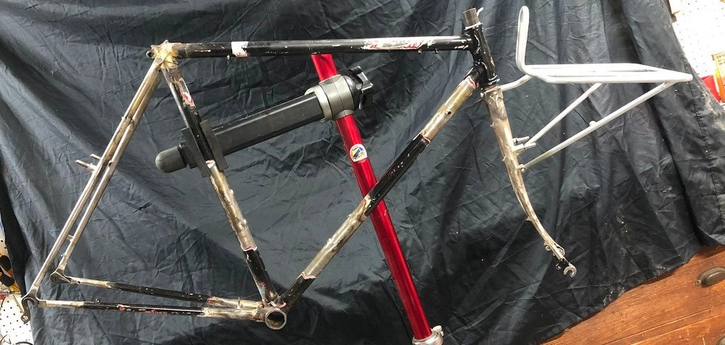

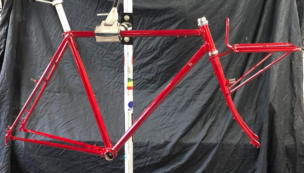

The Maltese Falcon
I picked up this dingus awhile back for a song. Just like the McGuffin in the title, it had been painted over a few times, which disguised the full 531 frameset. Details from the eBay ad made me think it was an early 70's Raleigh Gran(d) Sport(s). A clue:
Black, white, red then finally some lagoon blue
Headbadge was intact, so it's definitely a Raleigh. Serial number stamped on non drive side, stamped dropout. Yeah, Gran(d) Sport(s).
Local Portlander wanted a 650b townie bike. We talked, this fit him, it was on.
Here's the list of mods:
1. New vertical dropouts and seat stays
2. Spread to 130mm
3. Cantilever bosses
4. Wiring guides for generator hub, internal downtube to non drive side wiring - tail light to be installed on non drive side seat stay near dropout
5. Fender bridges/fender hard mount points
6. Bottle bosses, cable guides
9. Slightly modified Haulin Collin rack, fitted to bike.
10, Oh, let's powder coat it candy apple red
Pre-powder coat:
All dressed up:

All dressed up:
That’s a sweet little firecracker.
