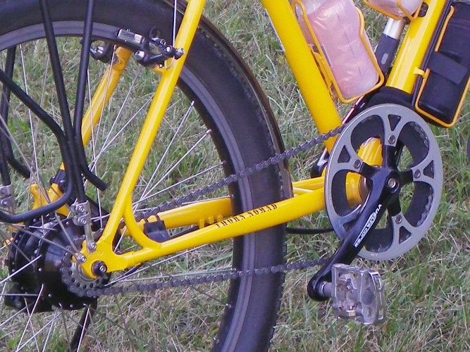

After the photo was taken, I sprayed it black to match everything else. This is on my Rohloff bike, thus no front derailleur, only a single ring.
