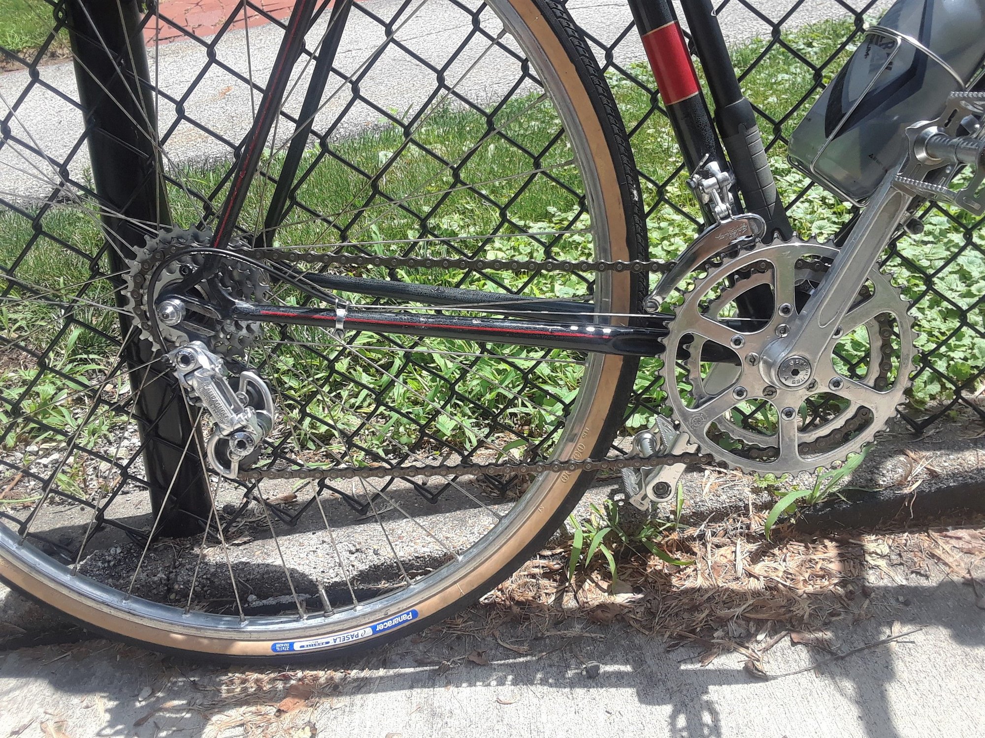

I was planning on dropping my gf off at ohare wednesday and picking up the paramount i was buying in milwaukee. My gf couldnt go because of all the current turnoil. So i was going to go up earlier but the guy canceled the sale for some reason. Turns out right near there is an old motobecane grand touring in my size with the vitus 172 frameset. So i went up and picked it up for waaaay less money and figured anything i did with one i could do with the other. Plus it might be less likely stolen. Anyway, i got it home and got the crank off, the non drive side was very stubborn. Also someone had tightened the seatpost bolt into oblivion. I drilled it out and it looks like shell hold a post. Cant believe i can have fun with little stuff like this while the world spins crazy.
Frameset 1978 i think

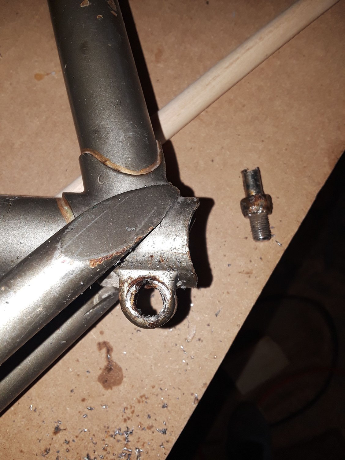

Looks like somebody spun a bolt in there pretty good.
Straightened the slot a bit.

i havnt got the guts to use plumbers helper yet.

If you don't have the drive side BB off, don't rule out Swiss threading. Same size as french, but left hand thread on the drive side.
I routinely pick up beater Motobecanes solely to pick up Japanese Swiss BB, Japanese forged french sized stems, and nice Suntour RDs. Different than the other french manufacturers, I have found Swiss BB on Motobecanes spanning many years, from the mid to late 1970s to 1982.

i am going to eventually remove it as i would like a different crank axle and possibly a different bb altogether. Have u any experience with the vo threadless ones?

The "older" Motobecanes were French threaded (70s and earlier I believe) but the "later" ones (80s?) were Swiss. I'm not sure of the dates when the switch was made but there are some threads here on that topic.
Do you need to get the fixed cup out? You can clean it up and ride it as is. This is a stronglight BB, right? Stronglight spindles are easy to find and the BBs are very good quality. I wouldn't be in a hurry to run an expensive threadless BB. Plus French and Swiss BBs are available new. French is a heck of a lot easier to find than Swiss though.
What kind of gearing do you want? Didn't this bike some with a stronglight 99 crank? That is a very good and very versatile 86 bcd crank. It can go as low as 28 so it makes a very good vintage compact crank. Chainrings are readily available at reasonable prices since so many of these were sold.
Bottom line is I wouldn't spend money on parts for this bike before figuring out whether the existing parts can do the job you want.

great advice. It came with a motobecane branded 130mm bcd crank of asian origin. The bike is a 1978 if i am not mistaken. Seller thought 76 but the contrasting paint and crank say 78. Gearing wise i just want lower. I would use as is except i cant use my triplizer with the current crank and crank axle. Also it is one that uses fixing nuts instead of fixing bolts.

Is it a stronglight BB? It likely is. Measure the spindle. I'll bet you can mount a stronglight 99 and then you have good gearing choices. You need a special puller for those but the later ones used a standard puller. You can put up a WTB thread or keep your eyes peeled for a Peugeot UO 9 or 10. Those came with stronglight 99s. You can harvest the crank and flip the bike. I recently picked up a UO 9 for $49 so I could harvest the crank and flip the bike.

i have an old t.a. i may try on it. It would give me lots of gearing choices. I am slo trying to suss out the seat post size. Im guessing 26.0 but i havent got the seat tube completely round yet.

After removing dirt, it is a tange bottom bracket and it looks like the chainline might be ok with my t.a. 50.4 crank. Ive got a few rings for it but if i decide to use it i will buy the removal tool. There is one at the coop but tools go missing there some times.
What are the gear ratios on the TA? What are you looking for? TA chain rings are available (at least for cyclotourist via eBay) but they tend to be more expensive than Stronglight rings.
ive got 26, 30, 40 and 46. I can certainly come up with something there. I'll make a compact or super compact double.

Are there any markings on the cup? Sometimes, thread spec is indicated in an arcane manner:
Source: Sutherland's 4th Edition
The 46 is an outer and the others inners? A 46/30 or a 46/26 is a good set up. I'm running a 46/36 on my Motobecane Grand Record and I've been looking around for a 32 or a 30 inner since my campy NR RD doesn't have the capacity to handle much more than that. If you're running a long cage RD, you can run a 46/26 and that will give you good gear ratios.

+1 this.
one side says tange 35 p1 (adjustable side)
other side says sakae 35p1(fixed)
No s1
52telecaster is offline
Old 03-17-20, 09:00 AM
52telecaster
ambulatory senior
52telecaster's Avatar
Location: Peoria Il
Posts: 3,389
Quoted: 1053 Post(s)
Liked 435 Times in 253 Posts
Should i assume right hand threads based on the sakae cup marking?
