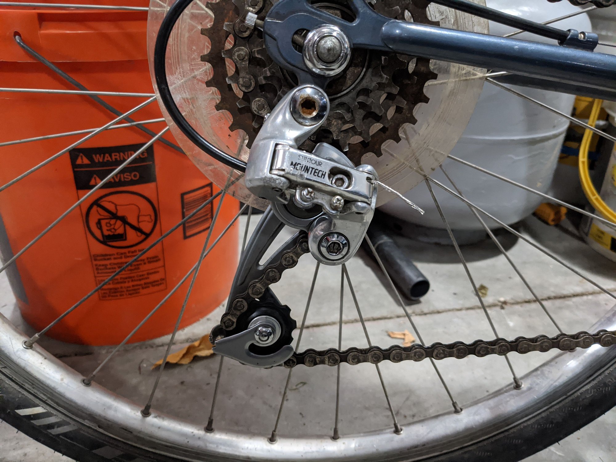

I had been thinking about posting a picture of my bike with the Mountech RD & asking how long I would have before it exploded on me, but that ship has sailed.
I was out on a ride this morning when I felt some grinding when pedaling. I looked down & the chain was bouncing something fierce! I tried trimming the rear derailer as I could see the front was fine, but no improvement. I hopped off to see if something was caught in the chain or RD. Nothing. Back on & same thing! Hopped off again to check the RD. Lower pulley moves fine, upper barely budges...
Phone call for a pick up.

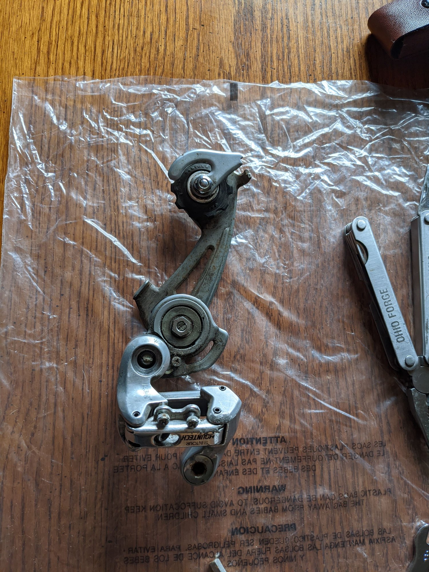

Later in the day I found some time to take a look. I didn't debate long in trying to overhaul despite the bad reputation. Since I was away from home & didn't have a backup RD or store nearby to pick something up the options were repair or no bike rides.
Anyway, here're my picture notes for reassembly:

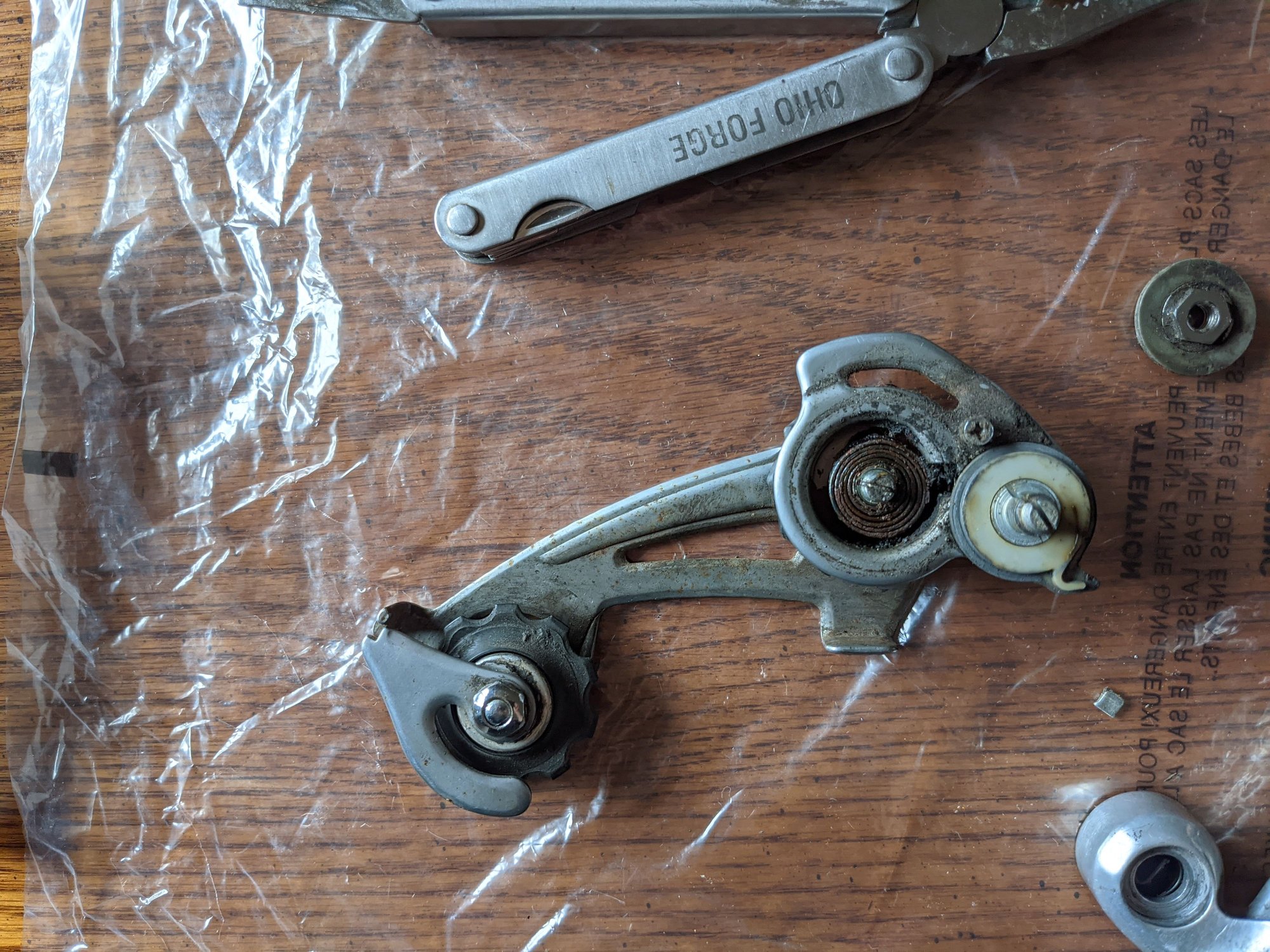

Above: position after first spring is unwound.
Above: position of second spring under tension.
Above: position of second spring when unwound.

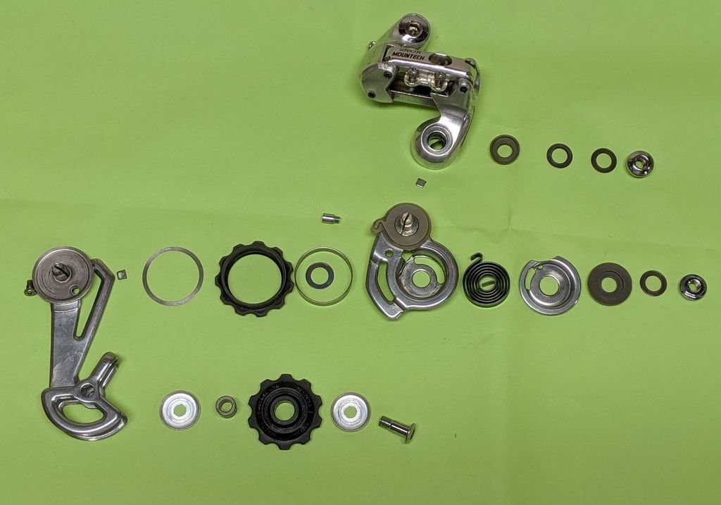

Above: RD reinstalled & shifting through all five speeds just fine.
I had to take it apart twice as the first time I didn't wind the second spring up quite right & the chain would get pinched between the derailer & largest sprocket. Second time was the charm, but the real test will be tomorrow when I actually get it out for a ride.
After having seen the insides of the Mountech, I see how it earned it's reputation. Way too easy for dirt to get in & way too time consuming to routinely clean. It's really a wonder it got approval for production.

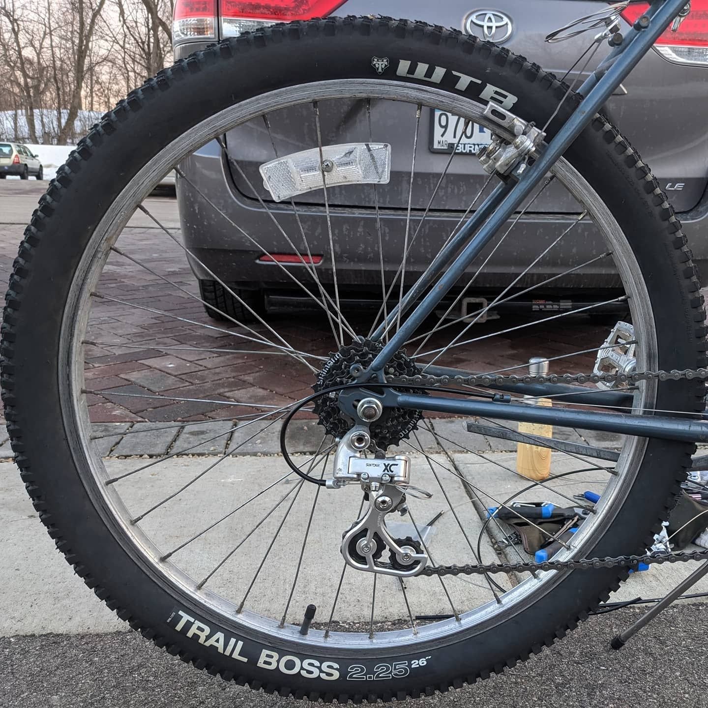

Finally got the rear derailer I was looking for:
Haven't had a chance to ride it yet because of the Tomaselli brakes - they used motorcycle cables & housing. I'm not sure if the smaller cable end will work in the larger brake or if I have to get actual motorcycle cables & housing.

Not familiar with the Superplate, You can see the abnormally huge rubbing surfaces on the upper pulley below:
