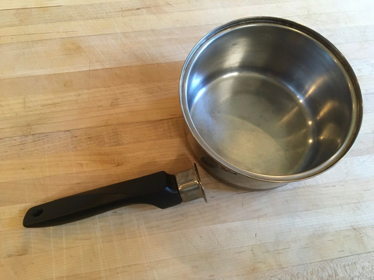

JB Weld users -- cookware?
I know a lot of people on the forums use JB Weld for a host of bike stuff, but has anyone used it to affix a saucepan handle, or some other cookware?
My wife has some vintage Eckoware pieces that came from her grandma in Chicago, and the handle just popped off the small saucepan today. It was apparently bonded together, metal to metal, with something that lasted decades, but simply wore away. It's still a very useful piece, and I'm sure we'll be keeping it one way or another due to the sentimental value, so I'd love to keep it in service.
It looks like the standard JB Weld product is rated for 550 degrees, which seems like it would provide a safe threshold. Thoughts?

I would start the hunt for a spot weld service. It should be quite reasonable and quick. Have the item with you when you ask.

I would prefer some kind of mechanical bond, I'm in my 50's, and every single time I can remember gluing something, it failed. Usually sooner rather than later. That episode of Gilligan's Island where Gilligan invents the "miracle glue" to fix the SS Minnow always comes to mind.
Maybe the handle could be brazed on. Photos?
JB Weld, IMO, is more useful as of a filler than a glue. FWIW.

#1. I've tried JB Weld in high heat applications. It always turns darker colored and cracks.
#2. If the pot handle is far enough removed from the heat of the stove, it may work . . . until
#3. JB Weld and other epoxies don't carry a whole lot of weight by themselves. If that saucepan and it's contents are somewhat heavy, the JB Weld at the handle may let go at anytime while lifting or moving the saucepan.

I would check the listing on this one to see what is in it, certainly not food safe.
When I worked in the fish tank industry there was a type of epoxy we used very similar to JB Weld that was food safe, no emissions. My concern with it would be heat.
If this is an iron or 'real' steel pot the welding should do nicely. If it is actually 'pot metal' it won't take a weld.
Have you performed a search specific to the brand to see if it's a common occurrence and some true fix already in the wild?

Look, at a certain point, it is useless to "restore" something like this to daily use... if you like the pot, for looks... glue the handle back on, and set it aside to hold kitchen utensils etc.
Then get a nice new pot, with riveted handles, for daily use. You would not want "grandma's repaired pot" to fail just as you move a full pot of hot liquid off the stove.

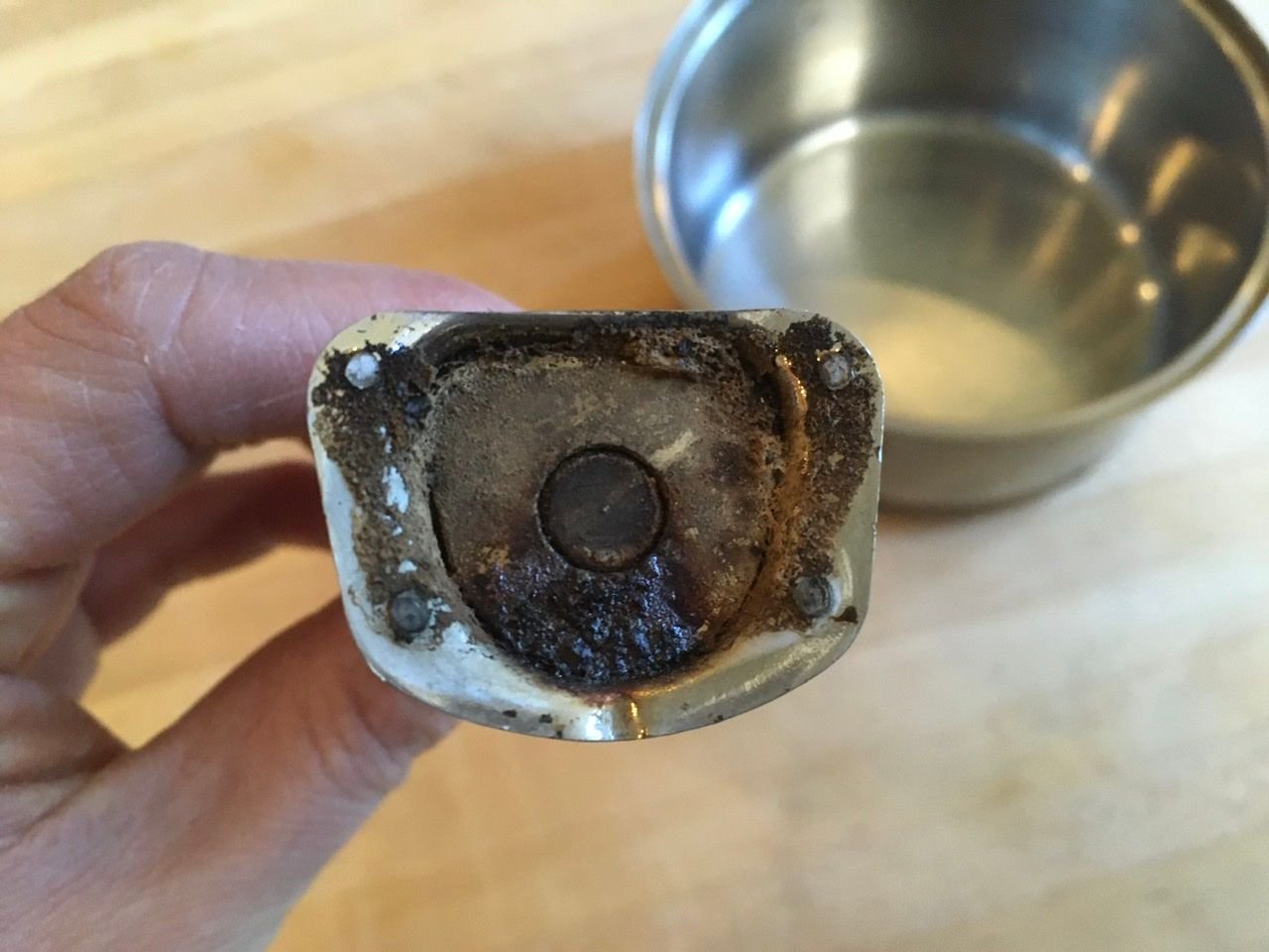

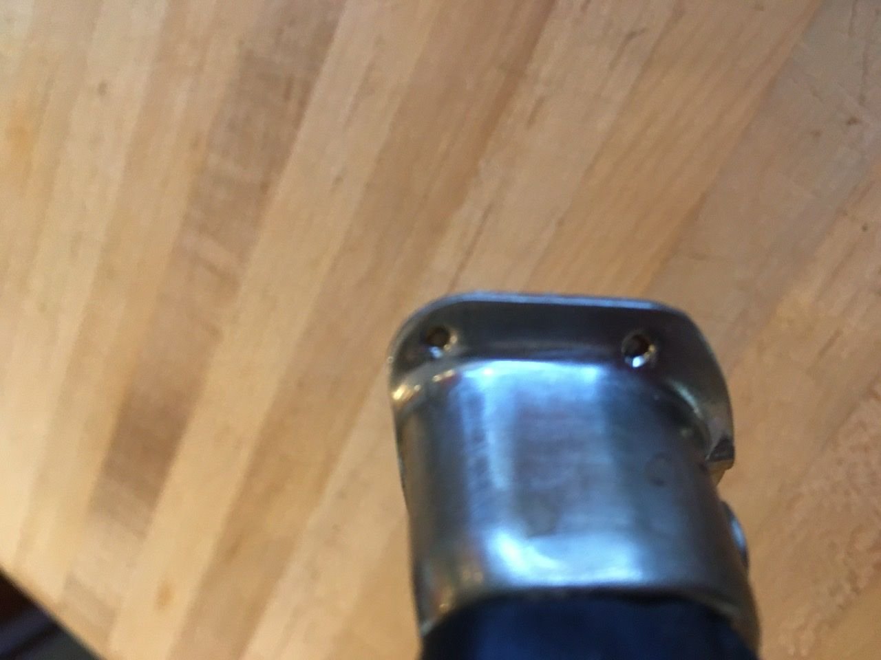

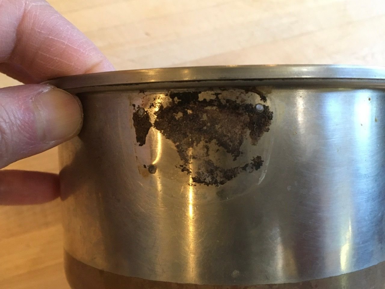

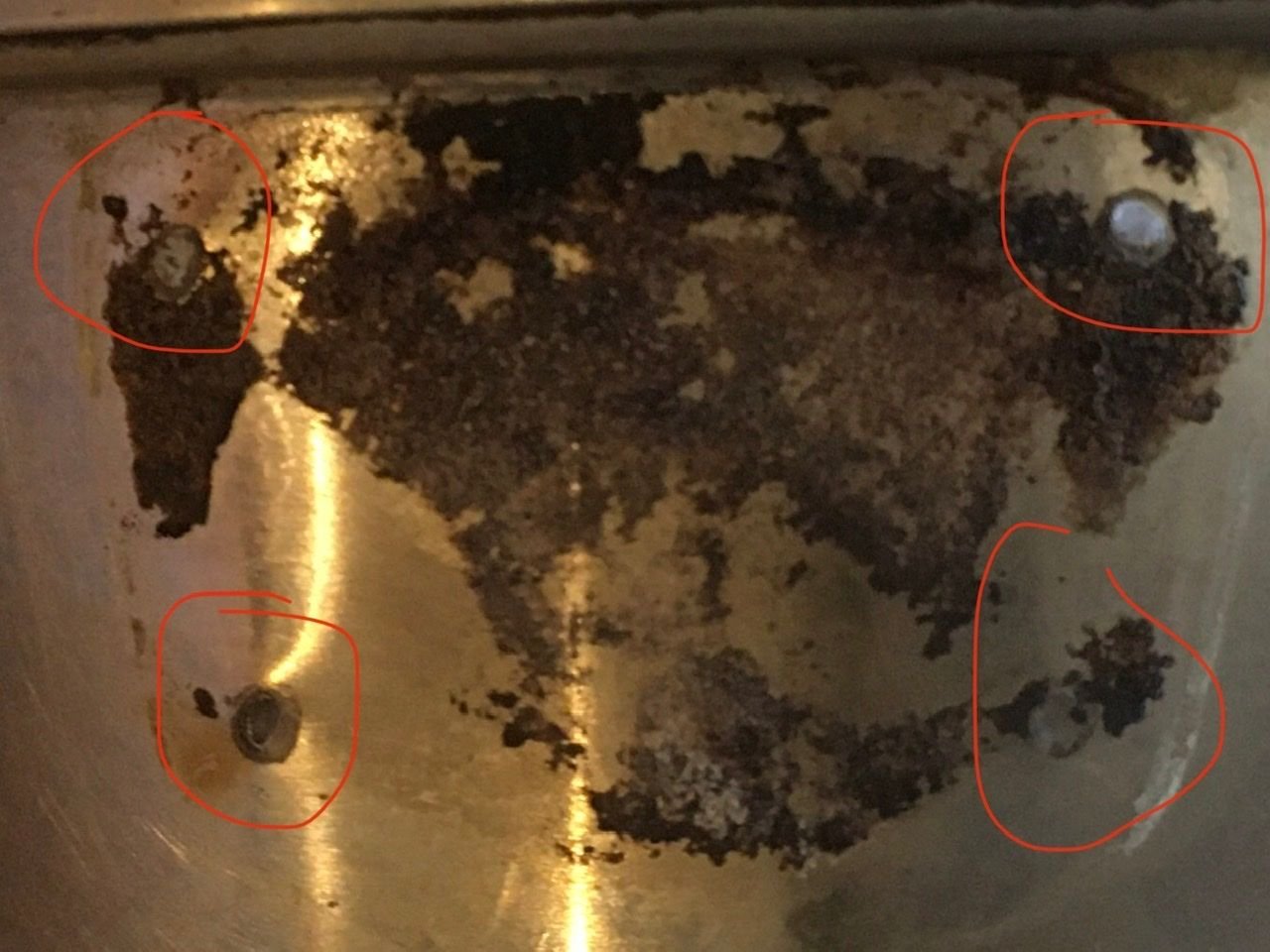

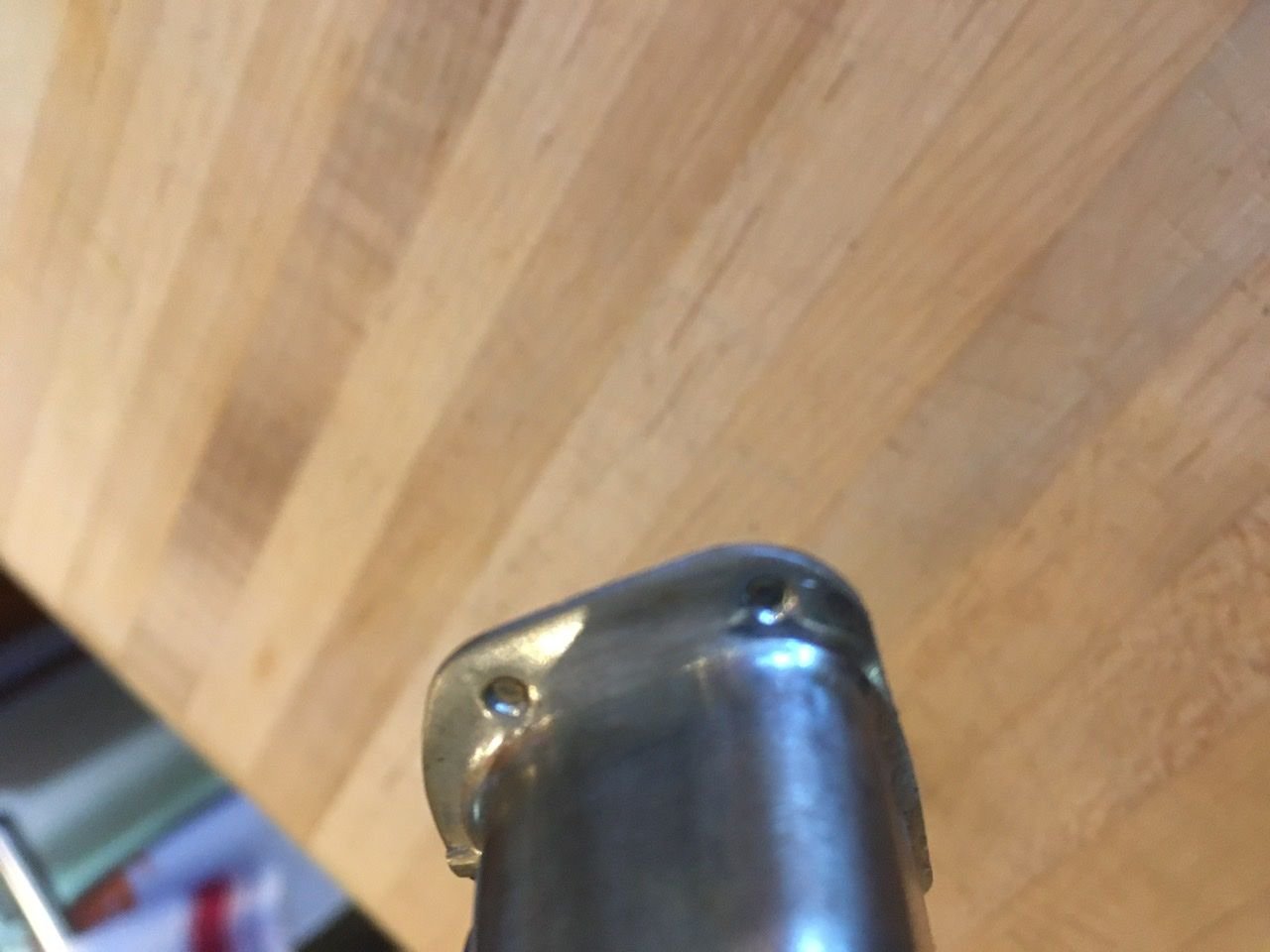

I knew I would get informed opinions steering me toward common sense. I will try to get a couple of estimates for a real weld, and if not, we’ll relegate this to decorative status. We were lucky in exactly the way suggested above — the handle popped off as I was removing the pot from the cabinet, but it easily could have happened with boiling water.
EDIT: Now that I examine these close-ups, I see four rivets. Is it possible those sheared? That makes it seem even less repairable than before.

That looks like what you thought was glue is simply goo and corrosion that built up over time in a place that was difficult to clean.
Are you clearly seeing rivits on the inside and outside? That might have been done on aluminum cookware, but less frequently on steel.
It could also have been spot welds. Which, as mentioned, would be an easy enough repair with the right equipment. Just clean it up and spot weld again.
Edit: That pan is not one that I would glue unless being used only as a display piece. IT WILL FAIL, SPILLING BOILING HOT WATER/FOOD ALL OVER THE PLACE.

Seriously... do a web search for stainless steel copper clad and buy a new one... but if you love the old one... (part of a set) they are available on ebay.
But frankly... I would get a modern riveted pan... not spot welded.
And I honestly would not bother with what you have. "It's dead, Jim!"

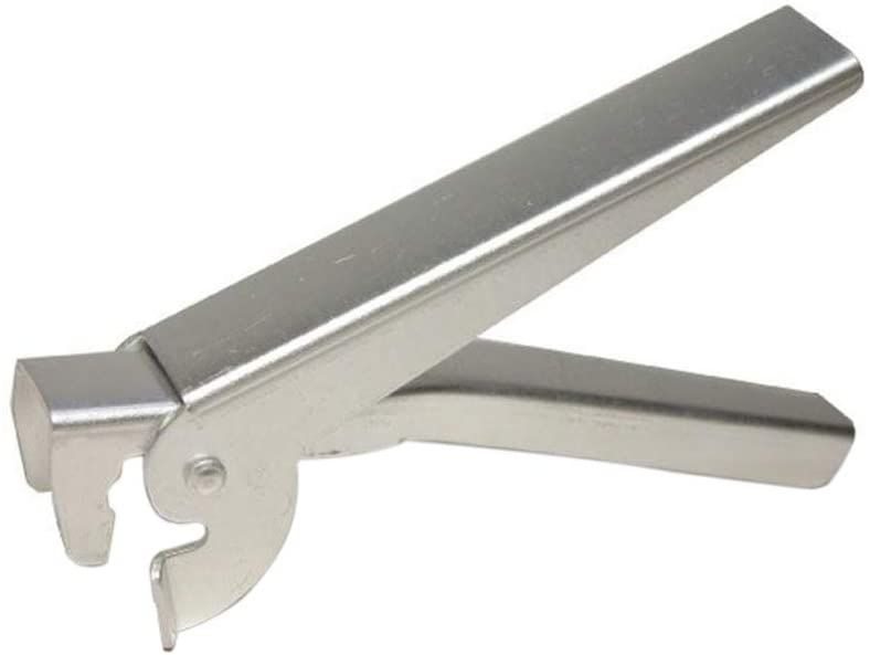

You can keep using it with a pot grabber/lifter.
They are typically targeted toward camping or backpacking so you can get a ultra low weight titanium one. There are many options available.
Titanium $25:
or Aluminium $3.50:

My guess is that handle has been loose for a good long time. It looks like the lower two spot welds had broken loose potentially years ago, and it just took time for the rest of the welds to break loose.
You might check your grandfather's head for a few lumps. It looks to me like the metal in the side of the pan has deformed as if that pan was hanled roughly a bit.
As far as your other pans, check the handles are tight. Perhaps try to squeeze a knife blade under each corner of the handle without damaging or prying. And, feel/inspect the inside of the pan near the handle attachment for deformation.
If the handle is tight, with no signs of damage, it could give way any time, but that could be years, or decades in the future. I'd use the others without a second thought. Of course, handle hot stuff with care.
