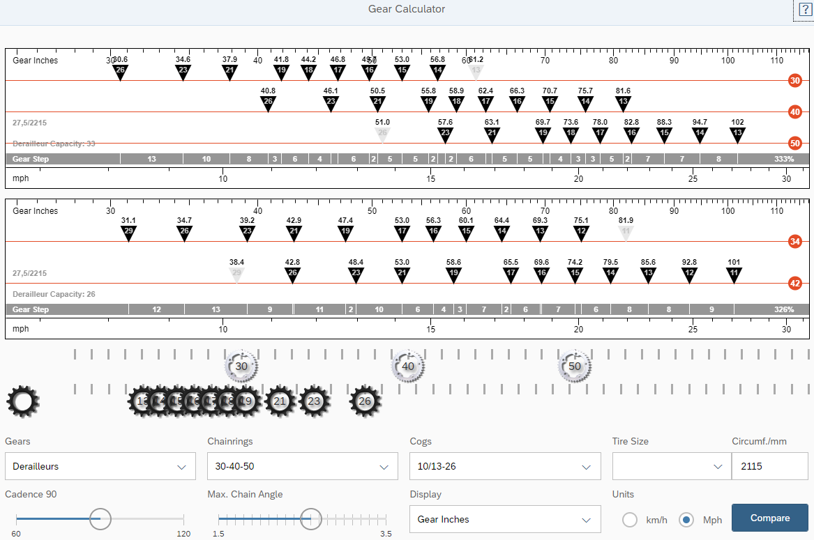

For the time being, I'm set for cassettes that start with 13T. But I plan to adapt if/when I move on to 11/12-speed. By substituting a smaller-than-traditional big ring, here's 12-speed reimagining of Drew Eckhardt 's gearing that doesn't give up anything, I think.
