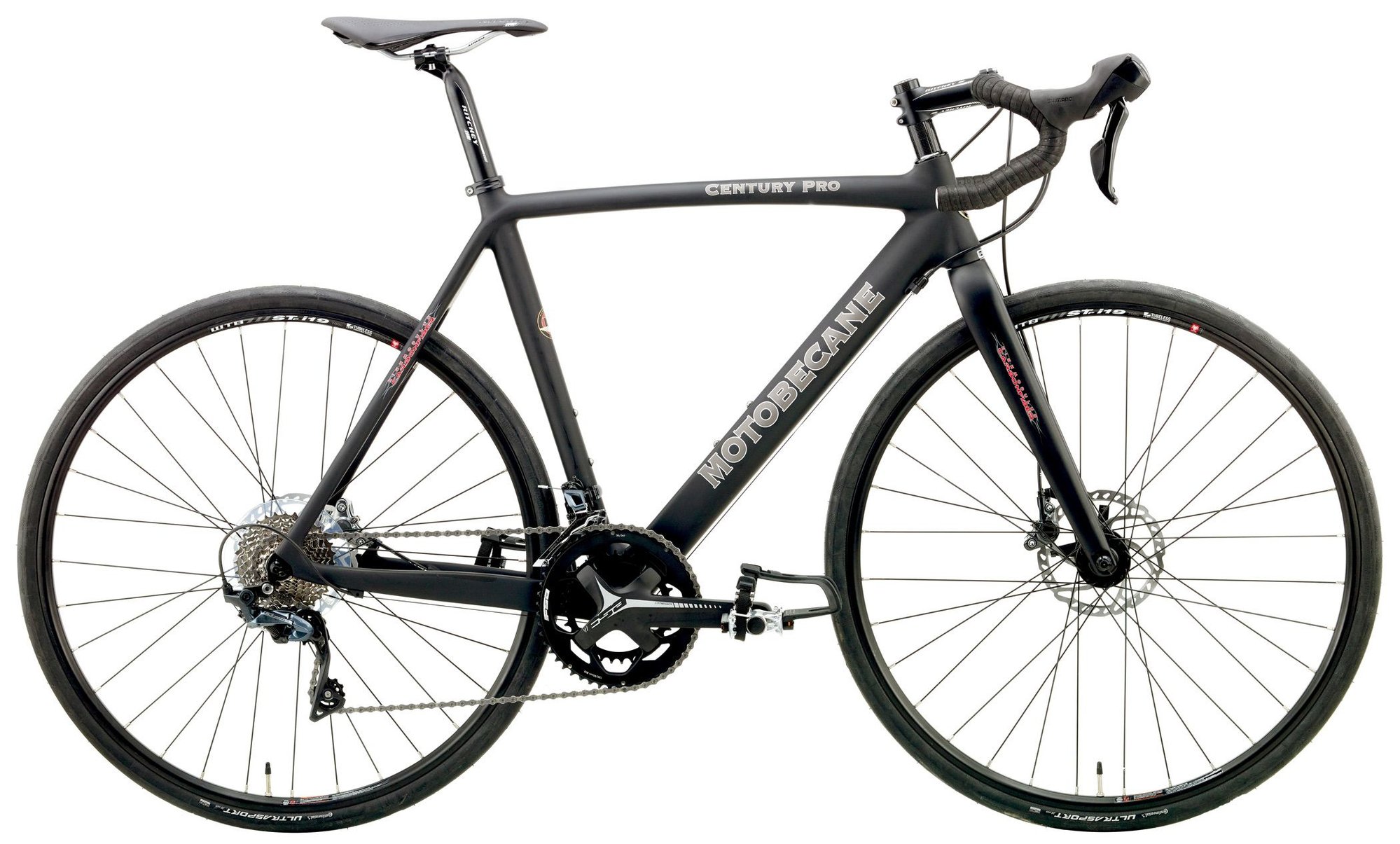

I'll probably get flamed for posting a BD link, but whatev's - I've had nothing but good experience with them - hard to beat the bang for buck
Save Up to 60% Off Disc Brake Road Bikes - Motobecane Century PRO Carbon Hydraulic Disc Brake Road Bikes
Fits up to 40c tires
Ultegra R8000 , carbon frame/fork, under $1300 shipped
