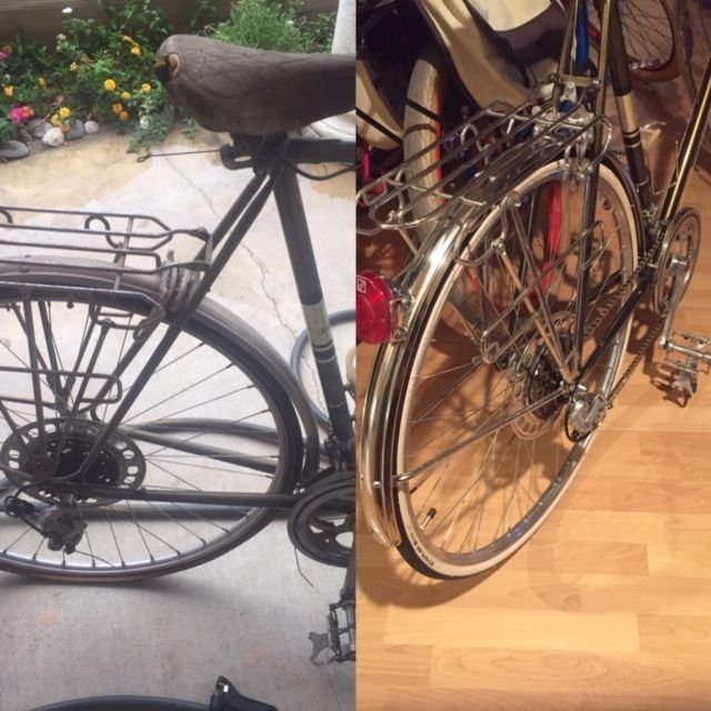

Nishiki Safari almost finished
Well worth the time and effort!
