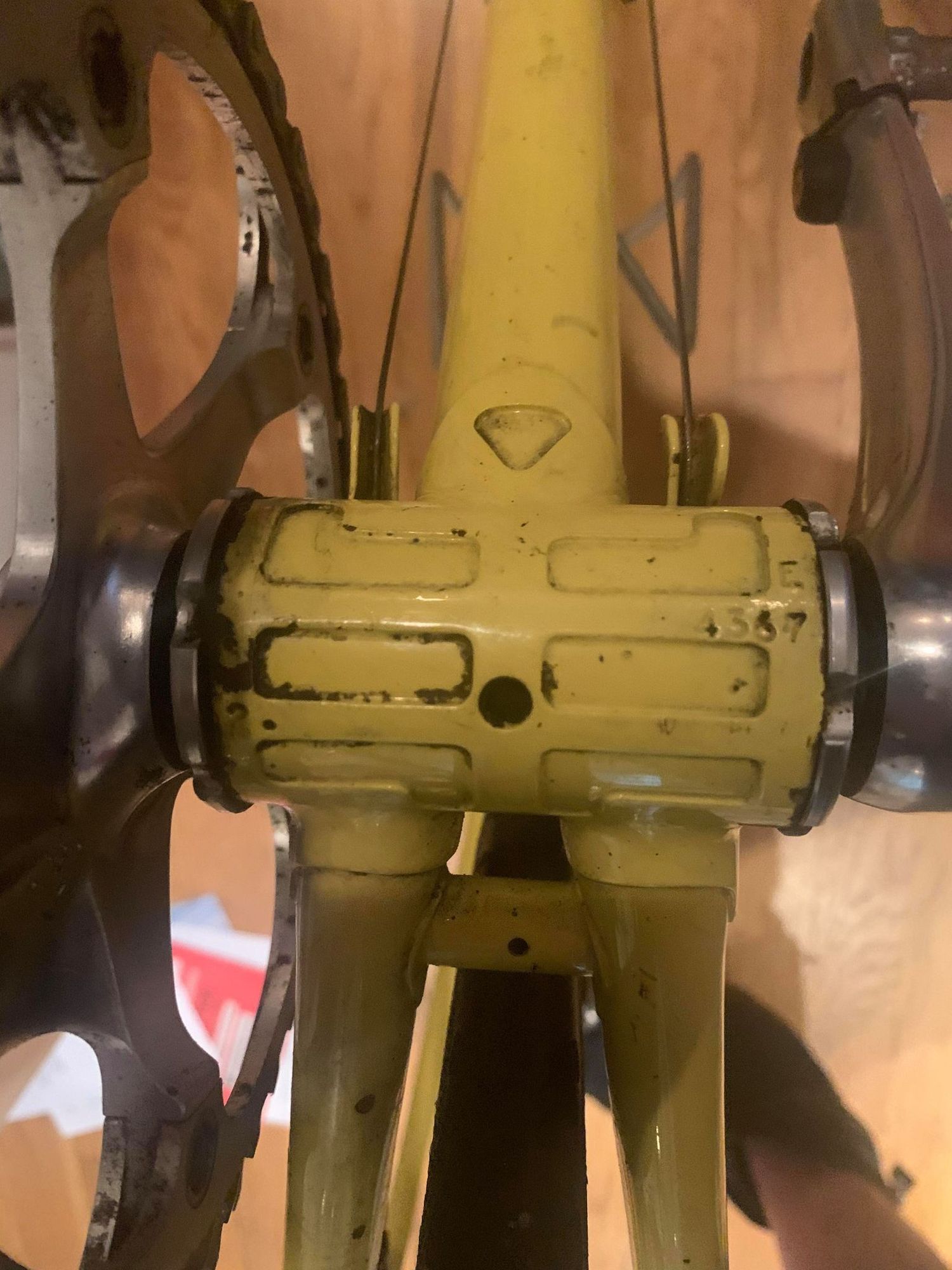

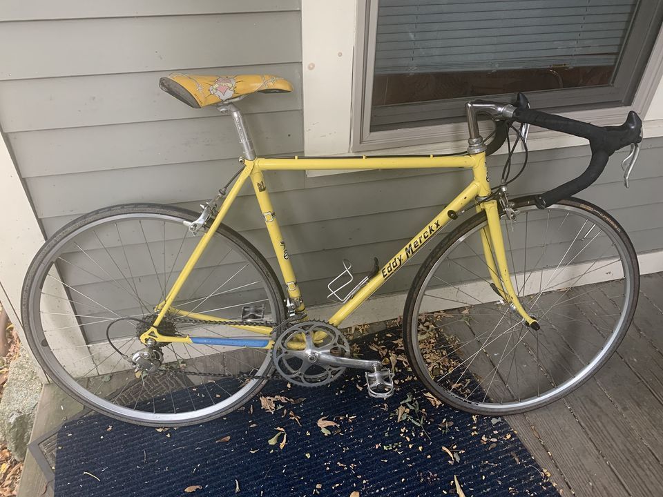

What would 2 on one side and E with 4367 below
color is yellow.
Again....all your knowledge is greatly appreciated
bikemike73 is offline
Old 01-07-21, 12:04 AM
  #362
CyclesMakaron
Join Date: Oct 2016
Posts: 481
Quoted: 128 Post(s)
Liked 222 Times in 159 Posts
Professional model
2 = 52 cm seat tube (c-c)
E4367 = serial number, frame built in 1982
The frame has been repainted, some stickers are inappropriate
CyclesMakaron is offline

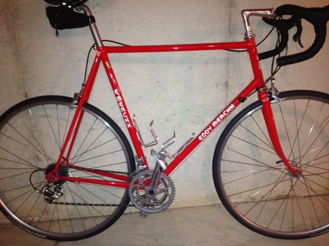

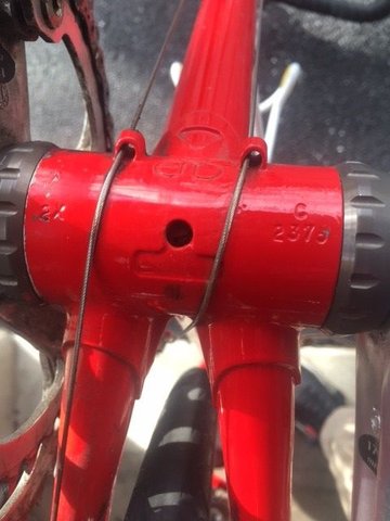

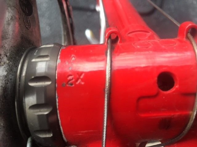

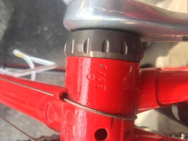

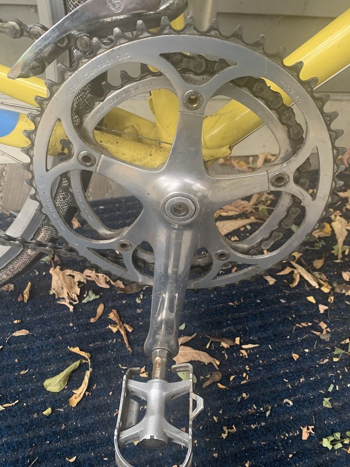

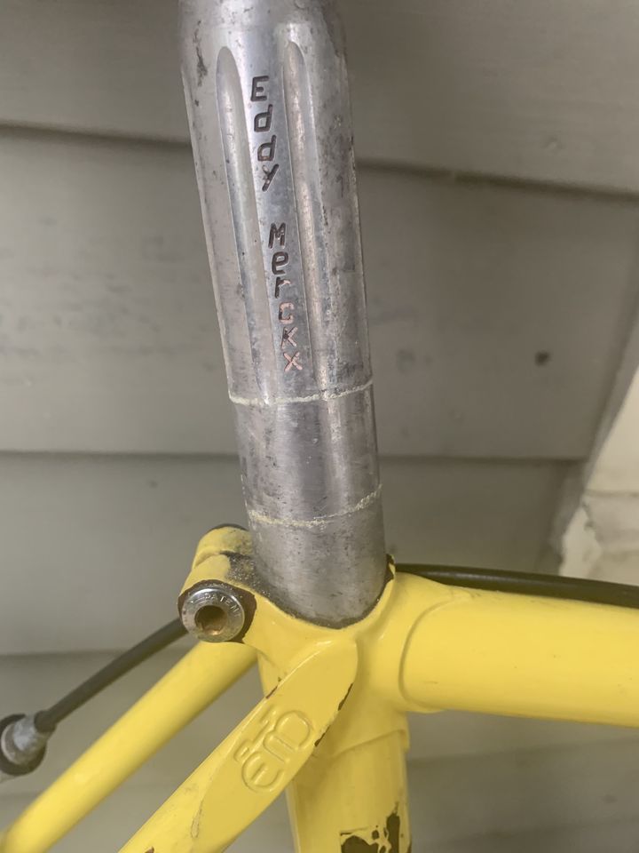

I've been meaning to put this up here to see what the date and info is. I've had this since 2001 when I purchased it from a fellow in South Carolina. Unfortunately it had been used on a trainer and sweat accumulated around the top tube pump and created a significant amount of rust and bubbling in the pain. Off to hot tubes for paint. I've not been a fan of chrome so had the frame fully painted covering the chrome. This is a daily rider so is showing chips and scratches but rides like a million dollars.
1980's Spectrum (Currently in a Box awaiting a modern build), 1995 Merckx Campy Centaur 10, Co-Motion Speedster, Bushnell Tandem,
Paul J is offline
