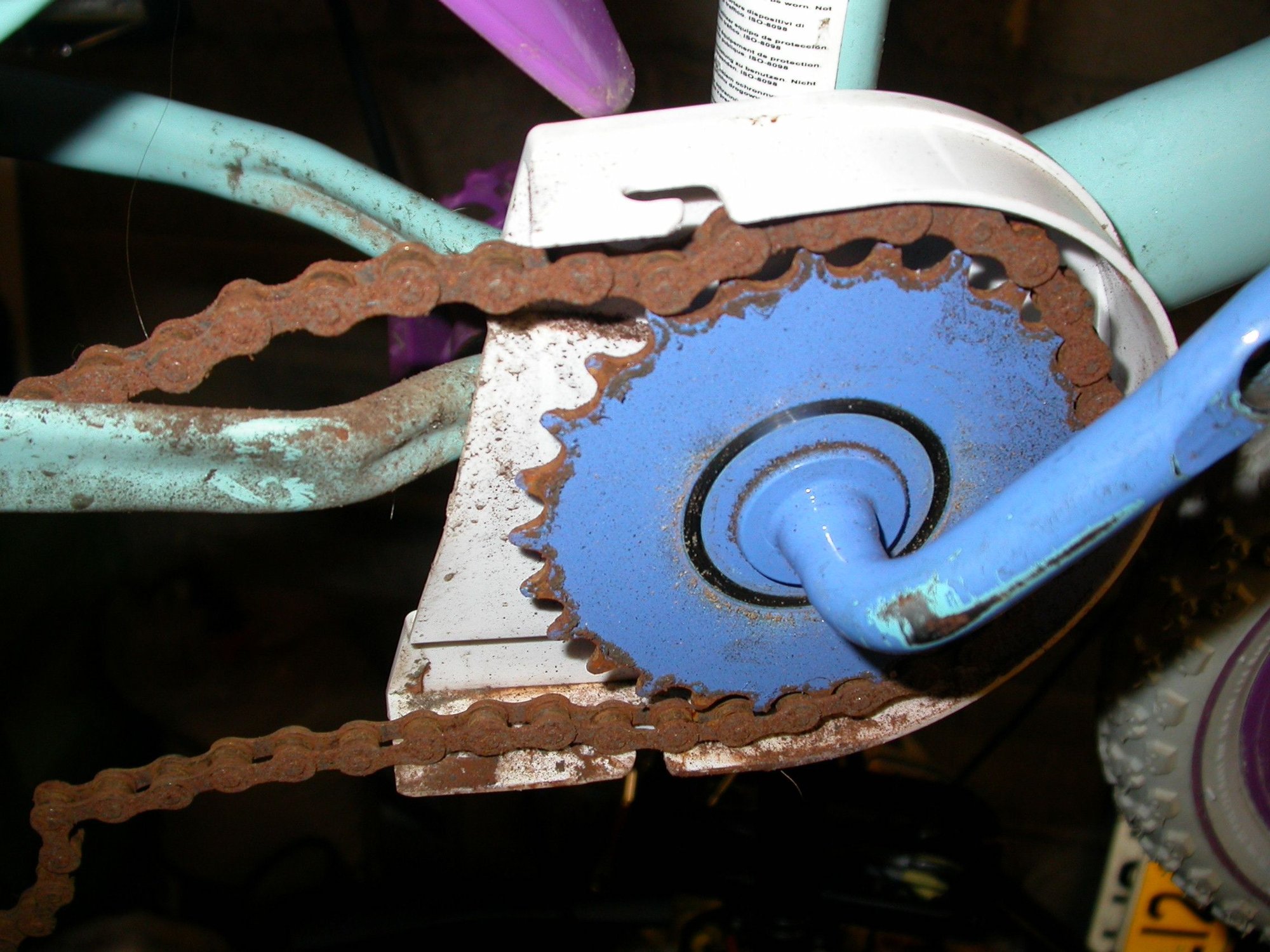

The wheel is completely seized and from what I can see under the guard, the chain is badly corroded. Surprising considering the bike is only 1 year old.
I would prefer to get into that chain to at very least clean it, or if necessary, replace it. But I'll try what you suggest to see if I get some movement on the wheel.

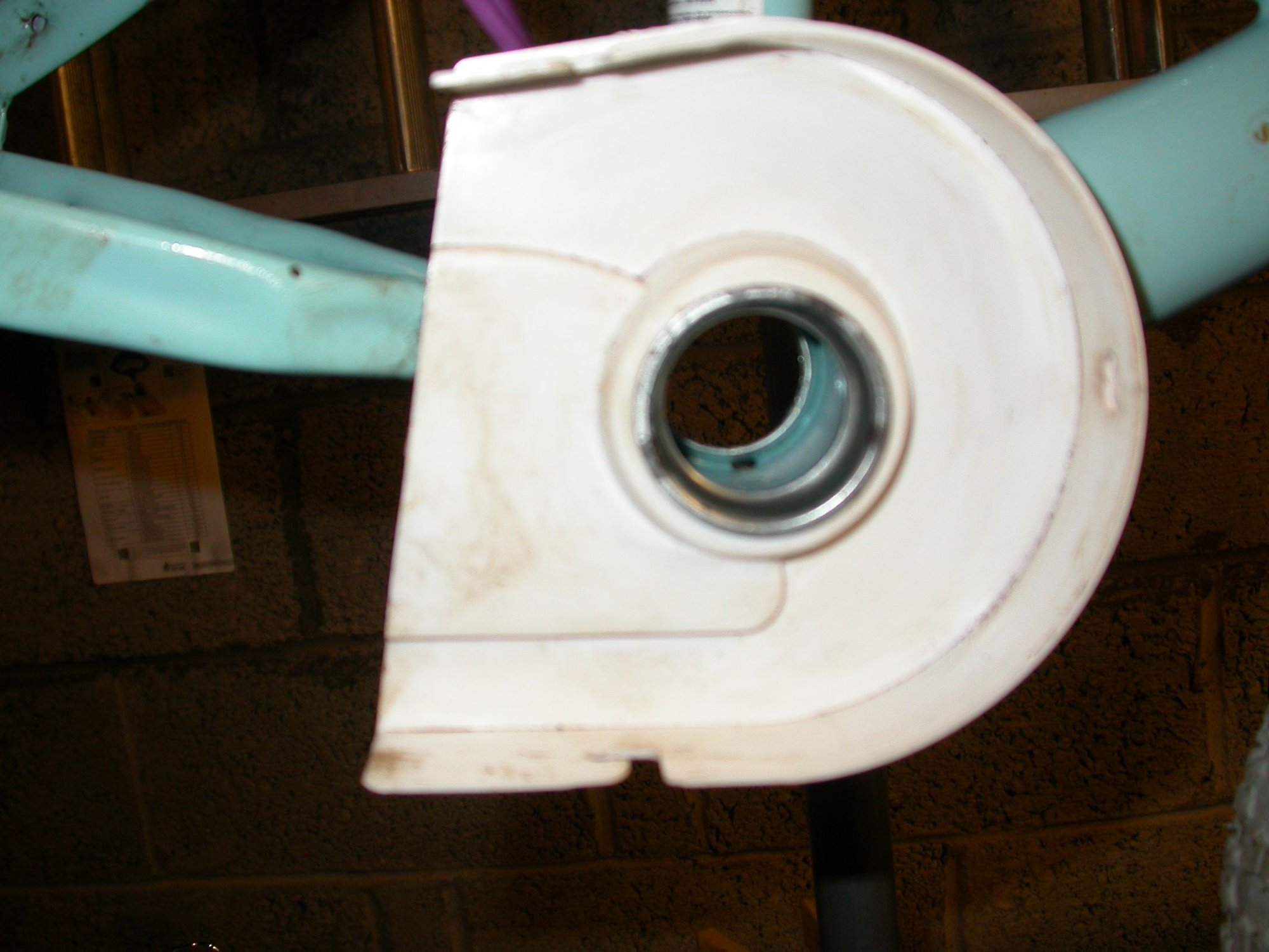

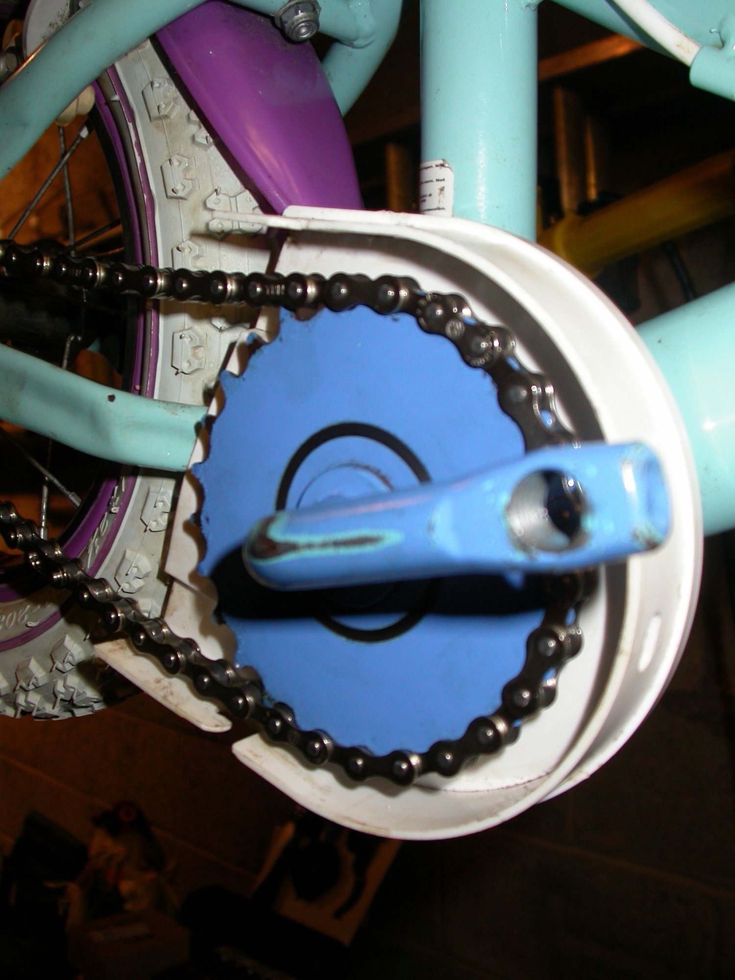

Managed to get the guard split enough to let me work on it. I'll add some pics if anyone is interested in how it is joined. It is a simply lug and slot connection and by pushing the outer shell of the guard towards the front, the lugs clear the slots and the guard can be separated. Now to get a chain to run on that chainring. I suppose it is not really a chainring, so whatever that is called.

Nice work! In that last image is small section of of the chain case behind the pedal crank. I can not for the life of me figure out the tool I need to remove it. Following along to see what you do here. Great bike!

I am pretty sure that the only way to remove that section without cutting it is to dismantle the bottom bracket and pull the crank out. I did not intend on doing that as I have access now to what I need, but as I am waiting for a chain to arrive, I may give the cranks, etc a clean too. If I do, I will let you know how things went.

Is a single piece crank? The one I have just needed the bottom bearing retainers, remove the none drive side bearing and then draw the none drive side crank through the bottom bearing. They are quite basic, and then you can see if the bottom bearing needs regreasing. The bearings in the rear wheel were a bit toasty on my one, so regreasing all round is not a bad idea - and everything is so light!

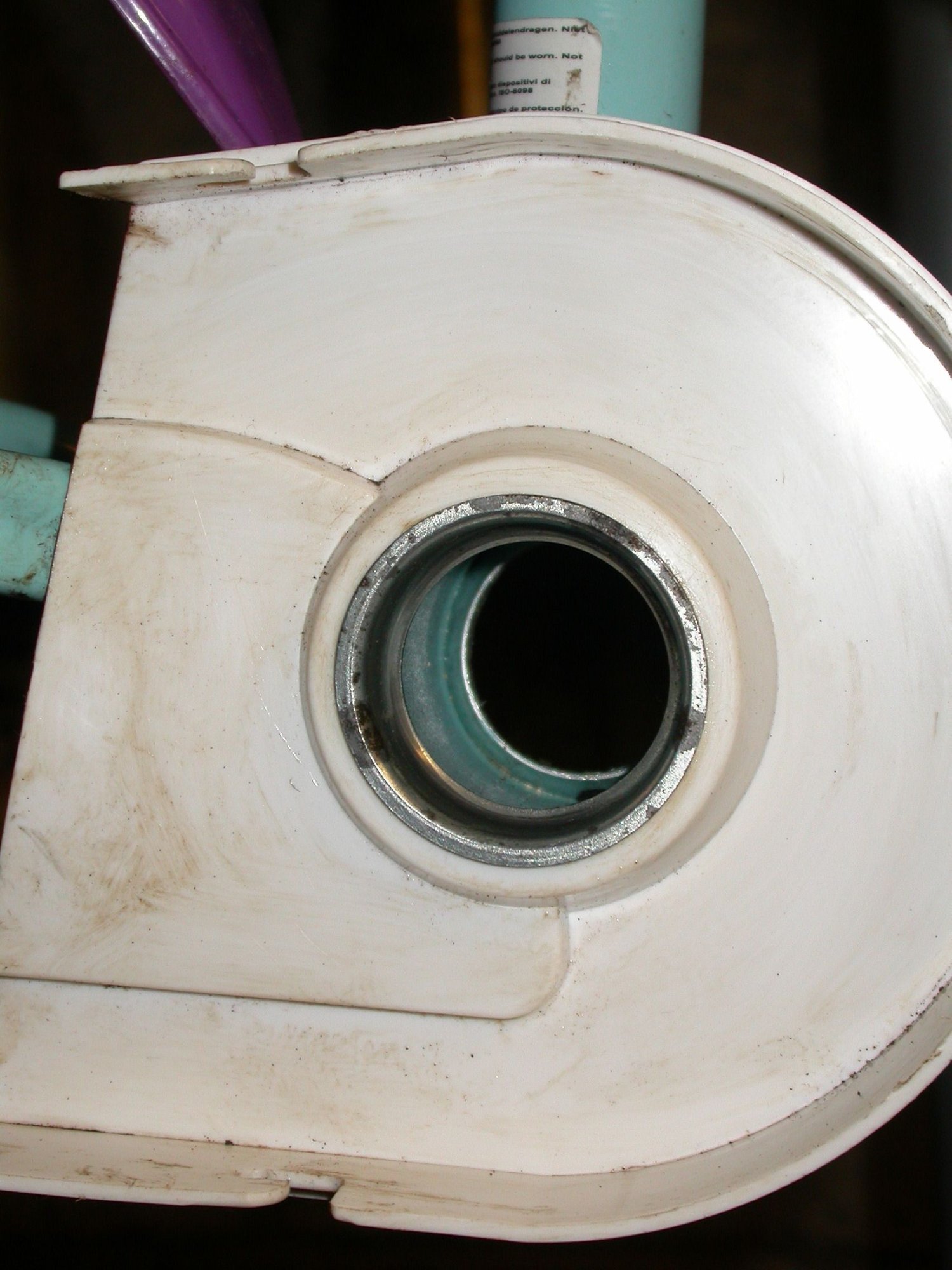

It is a single piece crank. I stripped it out this afternoon and greased up the bearings and replaced it.
However, the inner side of the chain guard is held in place by the bearing cup and that was not for coming out! So, I left it where it was rather than try to force it out and damage it. I'll settle for this.

Sadly, the chain is not playing ball. I have soaked it in penetrating oil; tried to flex the links using my hands and pliers; even tried pushing pins out and back in. It is remaining stubbornly stiff and not worth trying to save. A new one is on its way and hopefully it will fit and do the job.

Getting the bearing cups in and out are a minute's work with a punch and a hammer, but hardly with the effort here. My folders have similar bottom bearings, and I usually only take the cups out if I am going to switch to another bearing type that allows the use of a different axle type.
You might drop the frozen chain in a cola bath, I used some to free up the spoke nipples on a recent project. With the new chain coming you might not need the old one, but news of your kiddie bike expertise may spread like wildfire down at the nursery

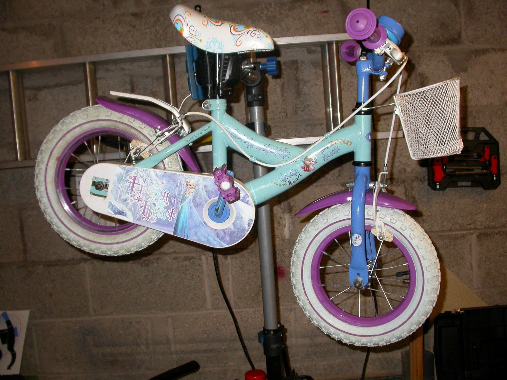

All done...... almost!
Chain replaced. Bearings in rear wheel and bottom bracket out, cleaned and lubed. Everything cleaned. New stabilisers ordered. Brakes set and adjusted. Runs smoothly. Yay!
But I dd screw up a bit. I cut the chain having placed the rear wheel back into the frame. However, when it came to refit the guard, it would not fit back properly. The wheel needs to sit exactly in its original position for the guard to slot home. So, I had to add a couple of links and draw the wheel back in the frame. Bit embarrassing that!

Excellent! And by the time she outgrows this one, she'll be old enough to watch and help on the next one. Watching my dad overhaul a second hand bike was how I first learned bike repair and general mechanics.

Cool to see it repaired and back into riding hopefully many more bikes and many more useful repairs and a lot of great learning down the road.
