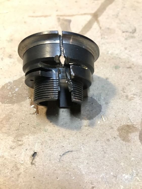

Hi there
Does anyone have an idea to best loosen a freewheel from a hub that is not mounted in a wheel.
I have tried using a chain whip but no luck. I have tried fixing the body with a bunch of cable ties, well that didnt work either
i have also tried loosening the lockring but after approx two turns the lockring seizes. Not coming off.
Any help would be grateful.

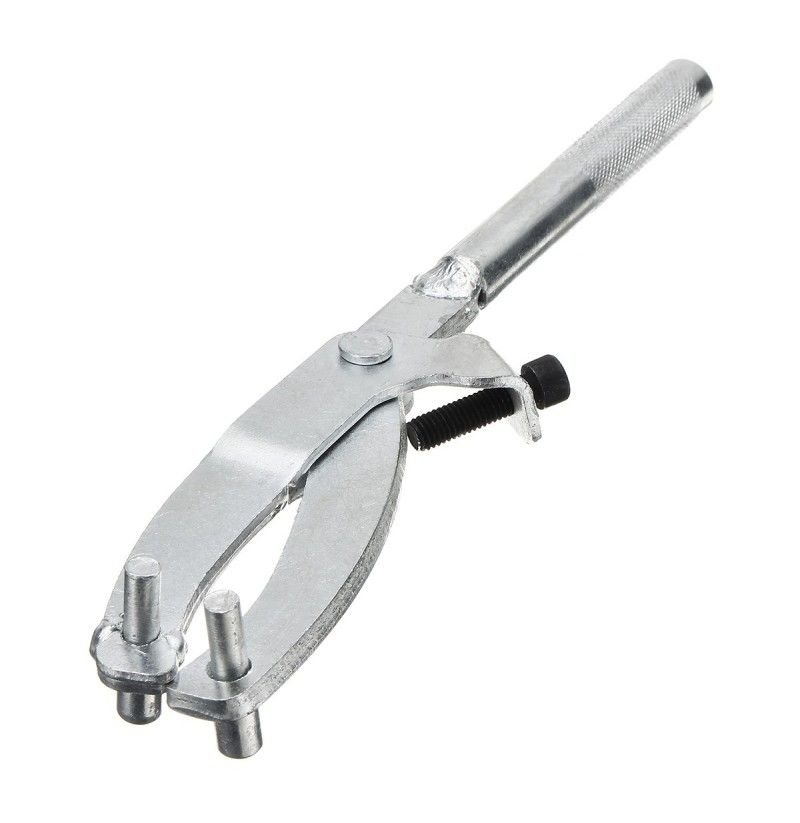

Photo in post #1 is a high flange hub; could a u-shaped tool be made from a bar and two bolts to project through the holes in the hub, hold that in a vise, and remove freewheel normally? Kind of a giant version of the two-pin tools used on adjustable cups for a bottom bracket.

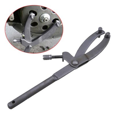

this is a good idea. there are automotive tools (rentable at auto stores) designed to hold pulleys on the front of the engine so you can remove it's mounting bolt. there's a lot of torque on those bolts sometimes, too..eg. crankshaft pulley
and, if there's not a pulley tool to fit, maybe fashion a two or three pin (using bolts) spanner to engage the flange holes behind the freewheel cluster and use a long breaker bar on the freewheel tool. that's what i'd do.
edit: yeah, shoot.....i've got a headset spanner made of flat steel about 1/8 in thick. with a spanner like that, drill some holes, put in bolts.....boom!....that would work

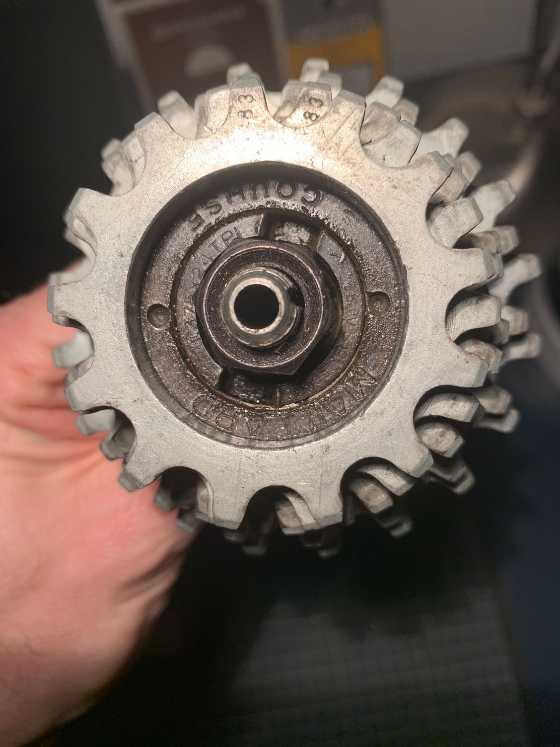

A bit embarrassing but I was actually looking at RJ's channel to find a solution as I also find him very informative. I tried his method of creating some Z-Bend spokes and lacing the NDS. Worked really good but the damn thing is ridiculously tight. Will have to try with some leverage later on.
Is your intention to save the freewheel or the hub? Or both? Depending on your answer I have different solutions which might solve your conundrum!
I would like to save both but have a slight feeling that the freewheel will be toast as I cant remove the lockring. And yes, loosened it by going clockwise.

...I would like to save both but have a slight feeling that the freewheel will be toast as I cant remove the lockring. And yes, loosened it by going clockwise.
If you didn't remove the threaded sprockets first, the retaining ring will thread off towards the underside of the sprockets and become jammed. If this is the case, this is why it made two turns and then it would not continue to thread off. The sprockets need to be removed first.
If your preference is to save the hub, removing the sprockets and outer body will provide plenty of space to facilitate a temporary lacing of the hub to a rim for leverage. You then have a choice of using the removal tool and attempting a salvage of the freewheel or use a pipe wrench to grab the inner body. Attempting the second option could damage the inner body and thus ruin the freewheel.
Before attempting either of the above, try heating the inner body with a torch first. The expansion of the steel body from the aluminum hub threads might provide some help.

pretty darn sure with the idea of pinned spanner tiger and i posted about you can save both the hub and freewheel. i've worked on a lot of cars, dude, and the application here is not much different. i think it'd be easier than using a temp lacing of a wheel. it's up to you, though
oh, and the freezer suggestion by old's'cool....it's also a good idea. leave it in several hours/overnight. you need the expansion and contraction to relieve the surface tension on the threading. a torch, while it will very likely work, will destroy the freewheel. a freezer is also more readily available...hopefully

automotive pulley spanner examples....
clutch pulley spanner/adjustable
flywheel spanner in action
you can/should be able to rent any one of these at an auto store...ie. free!!
