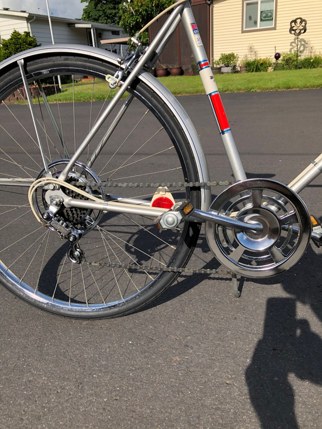

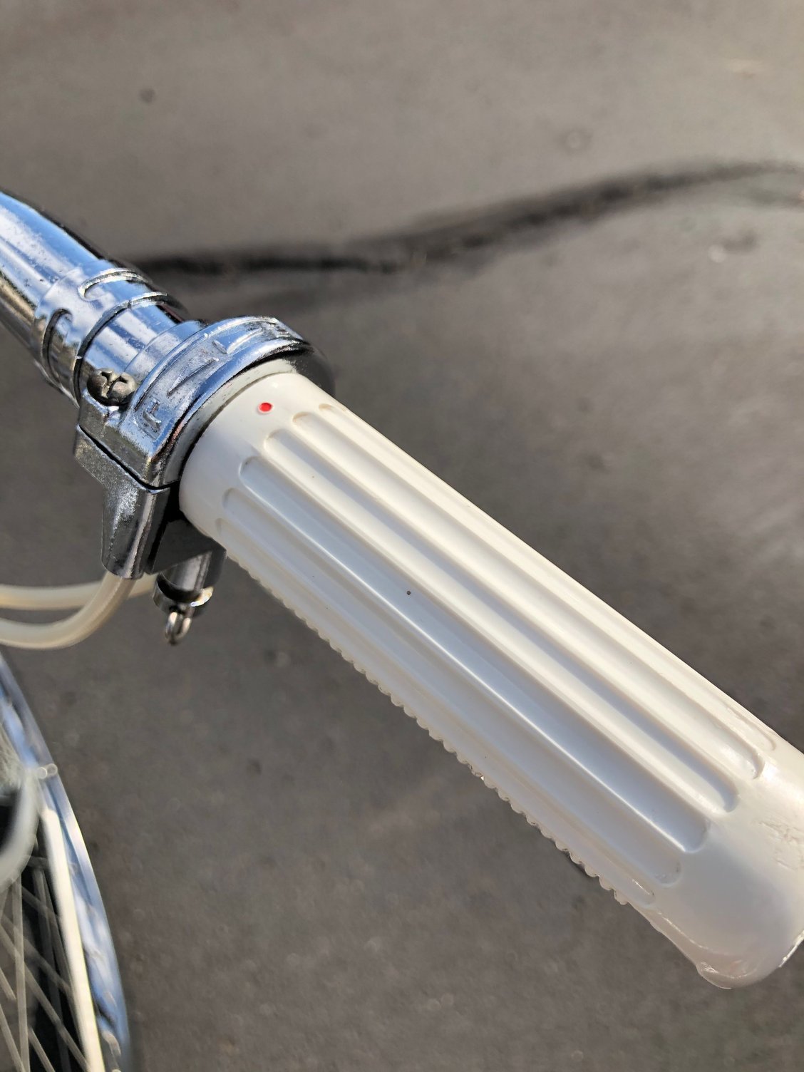

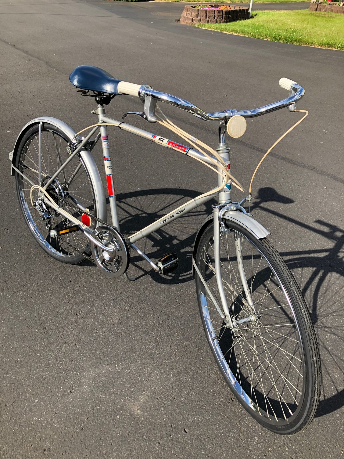

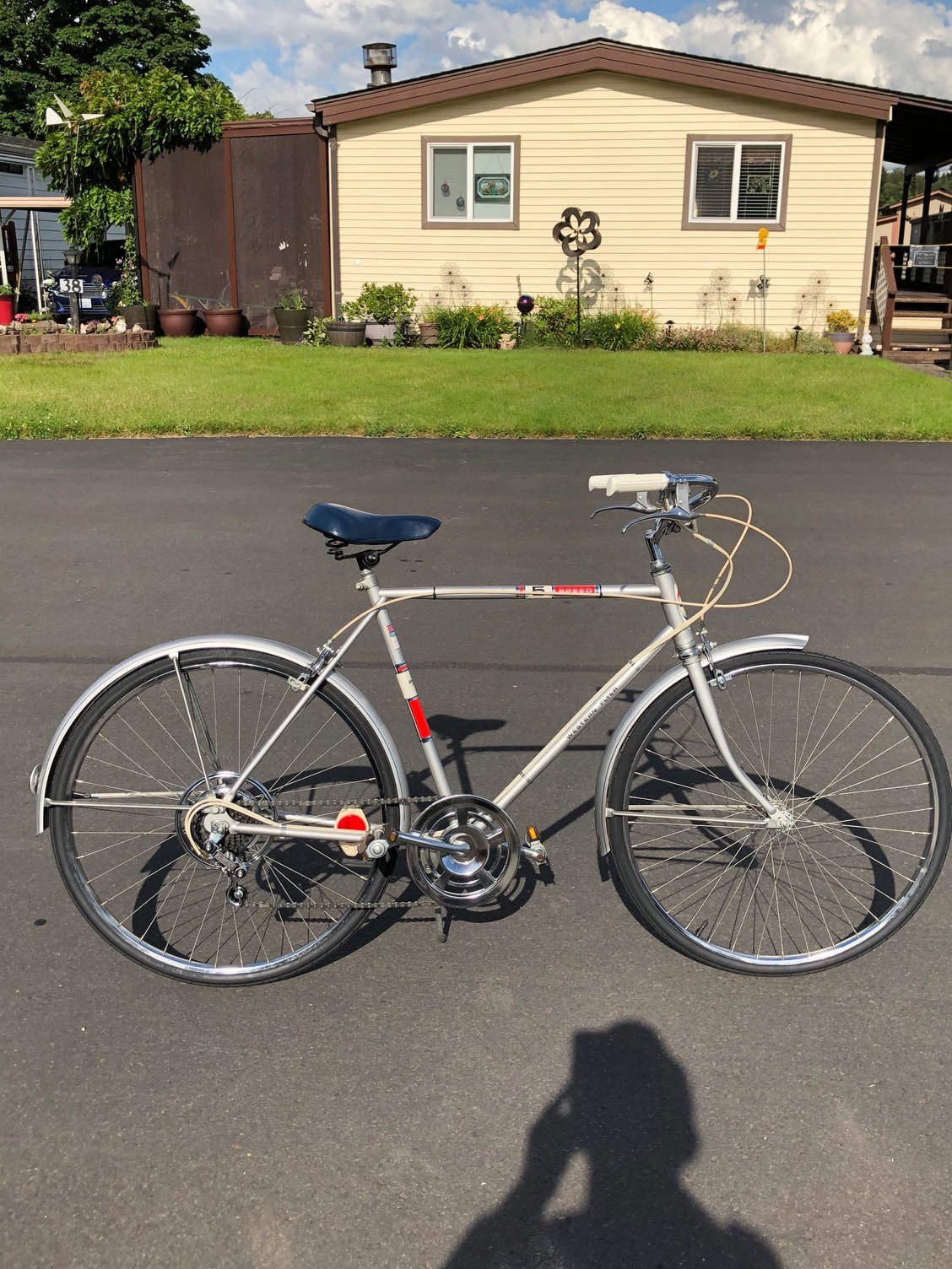

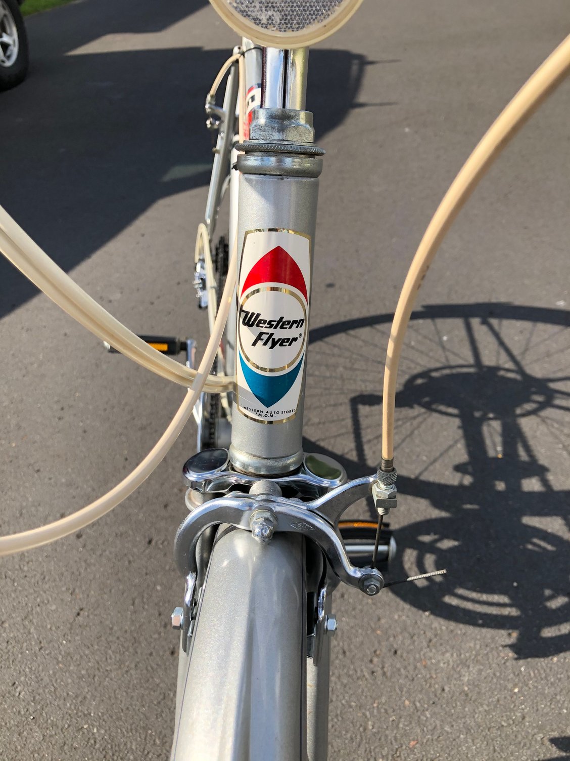

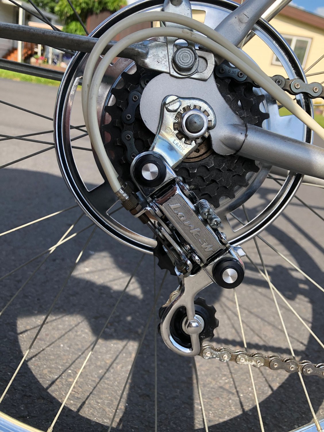

I'm just getting finished up on these his-n-hers early-'70's Western Flyer 5-speeds, warehouse finds from up in Centralia. I know it's like finding a pair of pristine AMC Gremlins, but that's what these bikes are. Millions were sold, very few remain, having mostly rusted into dust. These had been in a heated warehouse for at least 20 years, and literally all I had to do was clean them and lube them. New tires and brake pads, but everything else is original, probably sold from the old Western Auto store in Centralia. This one is the 26-inch men's Lightweight 5-speed, 22" frame; the twist-grip, twin-cable Lark-W derailleur dates the bikes to '71-'74. The 19" women's is in identical condition. The ride takes me back to my childhood; I rode several of those '60's-'70's Western Flyers right into the ground. These 5-speeds are also pretty rare; everyone bought 3-speeds or 10-speeds. I know, they're nothing special, but they are a part of American cycling that is vanishing. In the classic car world, these would be called "survivors." They're going to be great riding around the campgrounds.

I've not seen a double cable rear derr like that before, how does it shift?

It's actually pretty cool. My understanding is that there's no spring in the derailleur, and the tension between the two cables is what maintains the parallelogram. It's actually a pretty sweet setup, since you have to find the gears on these as you go, there's no indexing (I think I'm going to get this pretty closely dialed in, though). Instead of having to take your hand off the grip and find a shifter, the whole thing is right there in your palm. You get a lot of feel.
