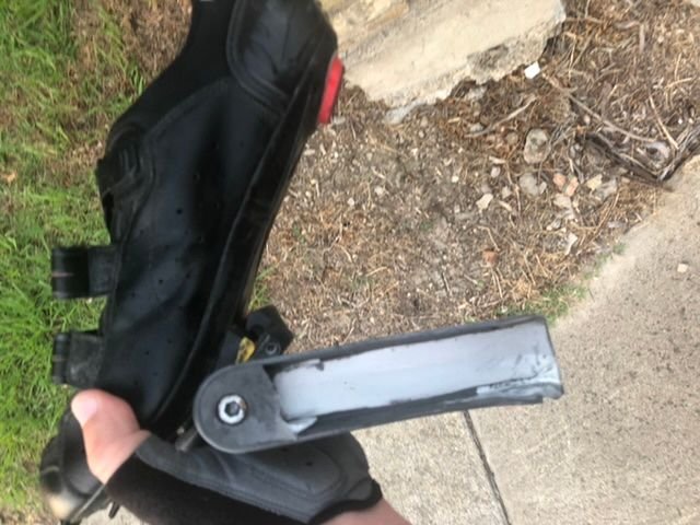

I was JRA on flat ground this morning and this happened
Its an Ultegra crank with only about 5500 miles. I admit I am a heavy rider, but I still think I should have gotten more then 5500 miles out of it. The crank had felt funny the last few days, but I thought it was an old cleat and replaced it. Guess I should have looked closer. I was fortunate that I was on flat ground and not pushing hard so I didn’t fall when it broke

This is actually not a terribly uncommon occurrence with these bonded Shimano cranks. I would check with the shop where you got it and see if they can do anything - there's a good chance that they can't/won't, but it's worth stopping in or making a phone call.
I'd send that into Shimano and see what they'll do for you.

That's absolutely nuts. I'd definitely send that to Shimano. Wow, so much bad stuff could have happened there. Glad you were unscathed.
whoa! That could have ended badly. As far as duct tape??? I would opt for gorilla glue instead or maybe flex seal...

Pretty bad and glad you weren't sprinting or something, but yeah, it happens. I broke a Nuovo Record crank BITD due to crevice corrosion in a small scratch, which invisibly ate halfway through the arm. If stuff never broke it would be too heavy.

What's nuts is that this is a known flaw, but Shimano hasn't fixed the issue. I believe it's still happening to 8000/9100 series cranksets..

Try to warranty it even if you are beyond the 1 year mark. I've read others have had Shimano cover this even when out of warranty.
Do you live in a damp, humid climate? There is a theory and some anecdotal evidence that moisture collects inside the bonded arms causing oxidation that eventually leads to failure. Was there a white powdery substance inside the arms?
Luckily, you weren't climbing or sprinting when this happen which can lead to a catastrophic crash.

Check with Shimano. They were pretty interested about such failures a short while ago.

I have a thread somewhere here where that happened to my wife. I wrapped it with dacron cord and coated with epoxy for one more ride until the new arm came.
