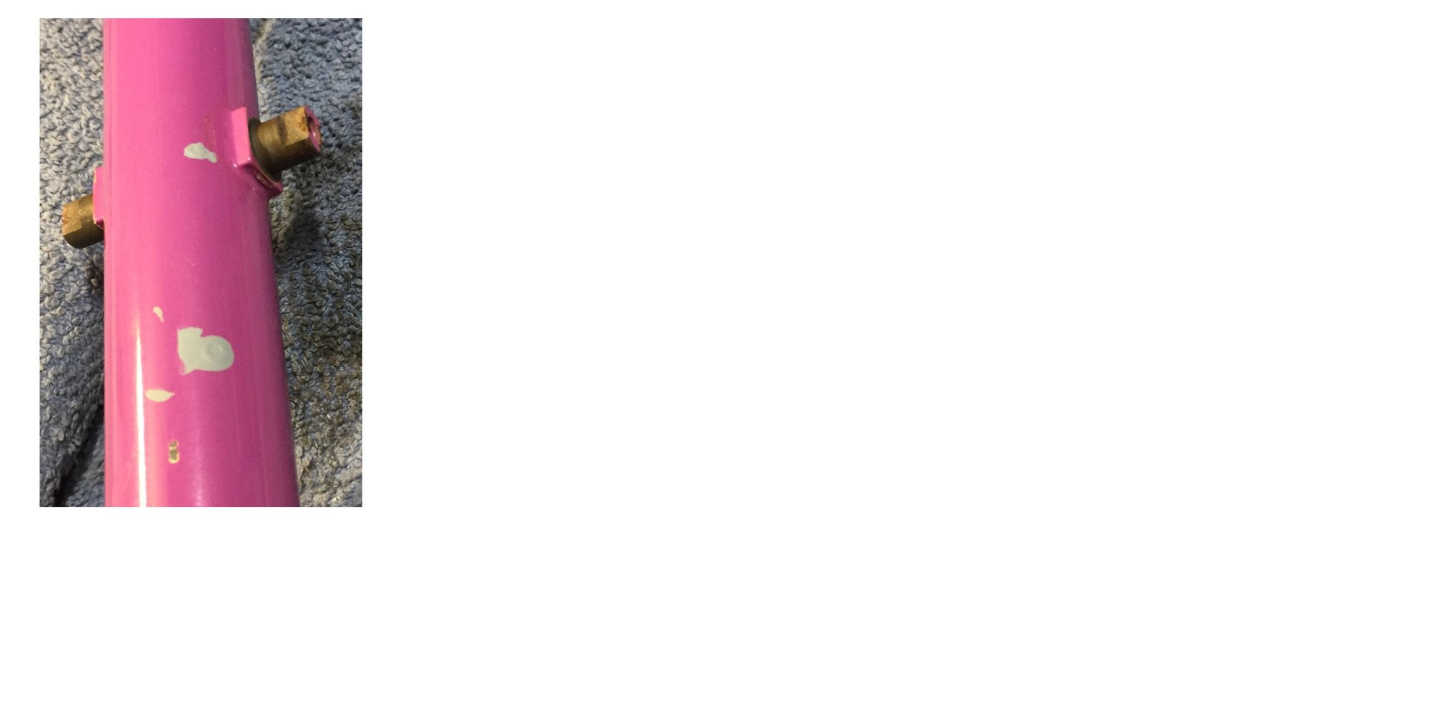

I put the 52/36 crank on and something doesn't look right. It looks incomplete. I figured it out. It will take about 30 seconds to change.
Much betta! Use a thick pointed Sharpie/permanent marker. Fill it in, then wipe off the excess quickly with a paper towel. But now I see the bare, maybe rusty spots on the chainstay. To treat those, clean them up with some metal wool. After that, put some rust stopping primer on such as this. Brush/poke it on with a Q tip. Let it dry and apply touch up paint, or not. Finally, put on a clear sealant like fingernail paint/polish.

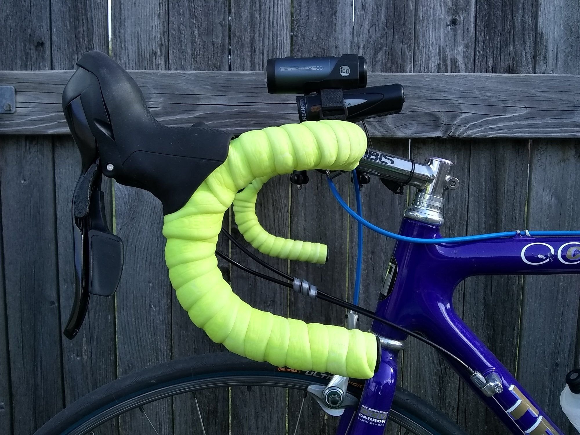

It reminds me that someone said I should raise my Brifters...so I did.
The thing is, with regular brake levers I line up the bottom of the bars and the bottom tip of the brake levers. However the Brifters are longer and when you do that, the hoods are too high for my liking. But I went ahead and did it the regular way . It's ok so far.
