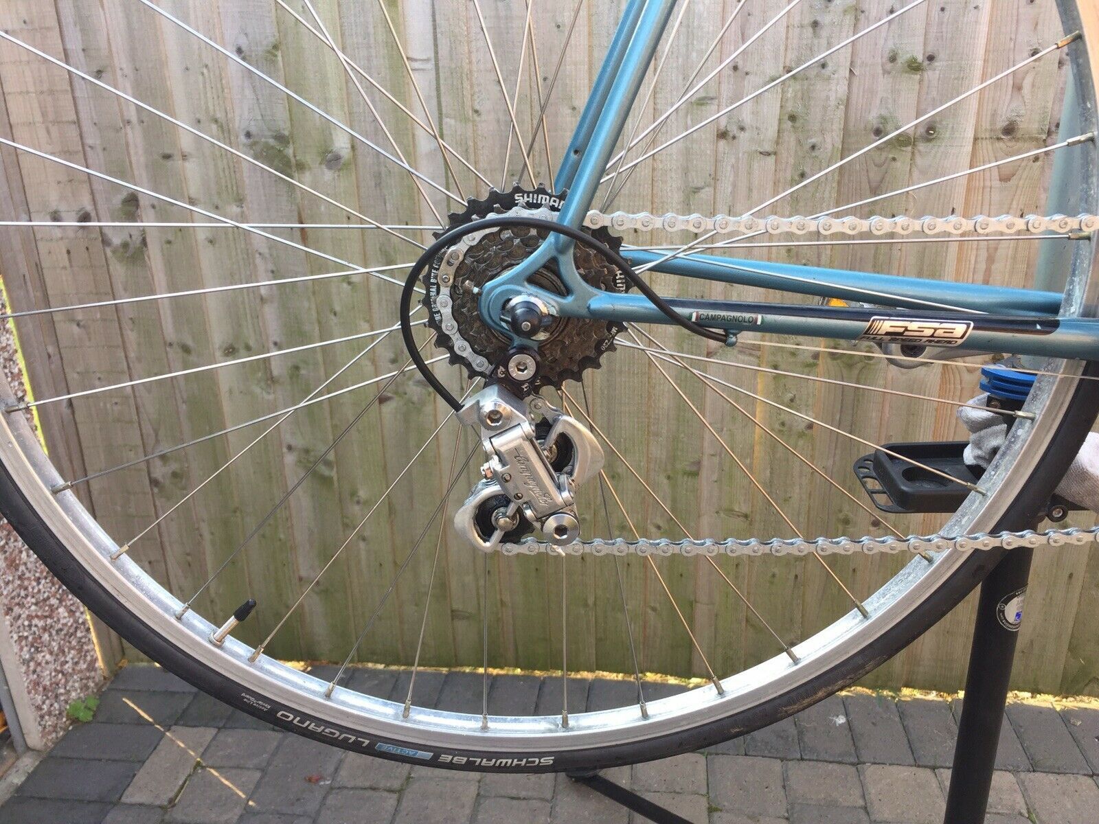

Originally Posted by Malcolm View Post
Hi there Bianchi experts, just trying to identify my old bianchi SX sports. It's light green in colour, the serial number is JB 870362, it has a Marco Polo white and gold trim on the seat, the diameter of the wheels is 700mm. Can anyone help with year of manufacture and l am looking to sell it as been in my loft unused for a couple of years. Where would be the best place to sell it, and find a price guide.
Thanks in advance for taking the time to respond..
Mal Otto
Ps if you need any more info please let me know.
Hello and welcome to the forums. A Celeste Sport SX would be either a '88 or '89. They look very similar but have different frames and components. Tell us more about yours. What brand and model are the components? What is the frame material? Yeah I know it is steel but what does the tubing sticker say?

Hi there all, any help in identifying my frame would be greatly received!!! I've been trying to work out the model via online pics and catalogues but to no avail!It has Super Set ii in SLX, Celeste, plain bianchi decals with white signature on top tube, and with chrome rear stays, lugged all round, all chrome under paint, race tab, internal routing at the top tube, unstamped drop outs, no panto's at all and serial A232233. I was told years ago on acquiring that it was a factory built race frame, race tab looks factory, so maybe a Reparto Course?
Thanks for any help
I have pics but not enough posts to attach yet.

Good Morning and welcome to the forums. Is this SLX or SBX? A SuperSet II frame would likely be SBX from ‘92ish. A lot of these had chrome rear triangles but I doubt the whole is chromed. Where are you and the frame? It is possible it is a factory supplied team frame from a group purchase or some sort of sponsorship.
[img]blob:https://www.bikeforums.net/f1526cd7-fcf2-46d7-b99b-87e271c19d70[/img]
