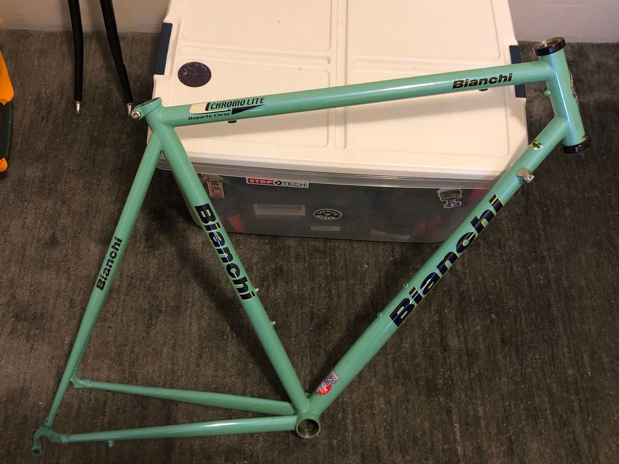

Hello,
First time poster. I just picked this up and wanted to know more about it. Serial # WBK255484T. More specifically the dimensions and the fork that came with the bike
Thanks in advance!

Good Morning and welcome to the forums. Can you tell us more about your Bianchi? Is it a road bike or a mountain bike? Does it have a model name on the tube across the top of the frame? Do any of the parts on it have names on them like Simplex, Modolo, DiaCompe?
I suspect it is one of the many fabulous Bianchi bikes built in Japan or Taiwan. OH what country are you and the bike in?

Bianchi RC Late model
Hi Bianchi Girl,
It is a road bike, and I picked it up as a frameset. The labels on the tube say Reparto Corse Chromolite and Bianchi. It has the chromolite mega pro concept sticker on seat tube, and a made in Italy sticker on the neck. It looks like the Veloce frame when I look it up, but I wanted to be sure. I am in the US, and wish I could pose pictures, but the site would not allow me to.
B_Fung is offline

Originally Posted by B_Fung View Post
Hi Bianchi Girl,
Chromolite puts in the later '90s. If you upload pics to your album we can still see them you just can't post them in the thread. The fork was very likely 1" steerer

Bianchi RC late model
I hope this work. I just uploaded the photos on my albums. Thanks for your help bianchigirl
Hello,
Thanks in advance!
The serial number format is consistent with model manufactured in 2001 and imported into Denmark by (Borge) Kildemoes. European market models often have different names and specs than the USA models, This complicates identification, along with the fact that a common frame was often used for two or three models. So, unless you have some OEM components it will be difficult to narrow it down to an equivalent USA model, let alone the proper Danish model. However, based on the Cromolite tubing this would be upper entry level to low mid-range. By this time the Reparto Corse decal was primarily a marketing feature to lend some prestige. Frames at this level would not have been built by Reparto Corse.
Would you happen to know off the top of your head which models used that frame?
