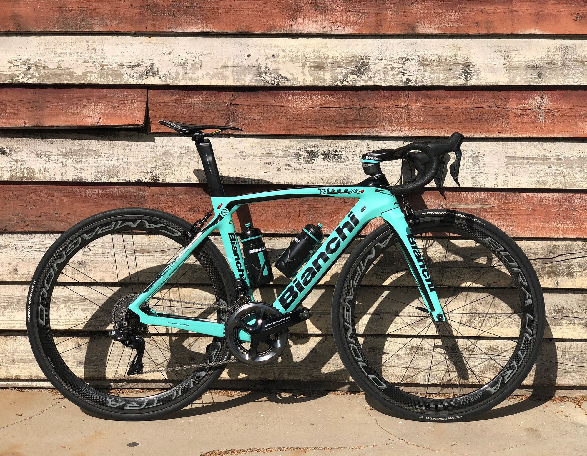

My "Aero" Bianchi Oltre XR4 is 15.0-lbs with pedals, and bottle cages. In all fairness the brake calipers are lightweight Cane Creek EE brakes and saddle is raw carbon.
