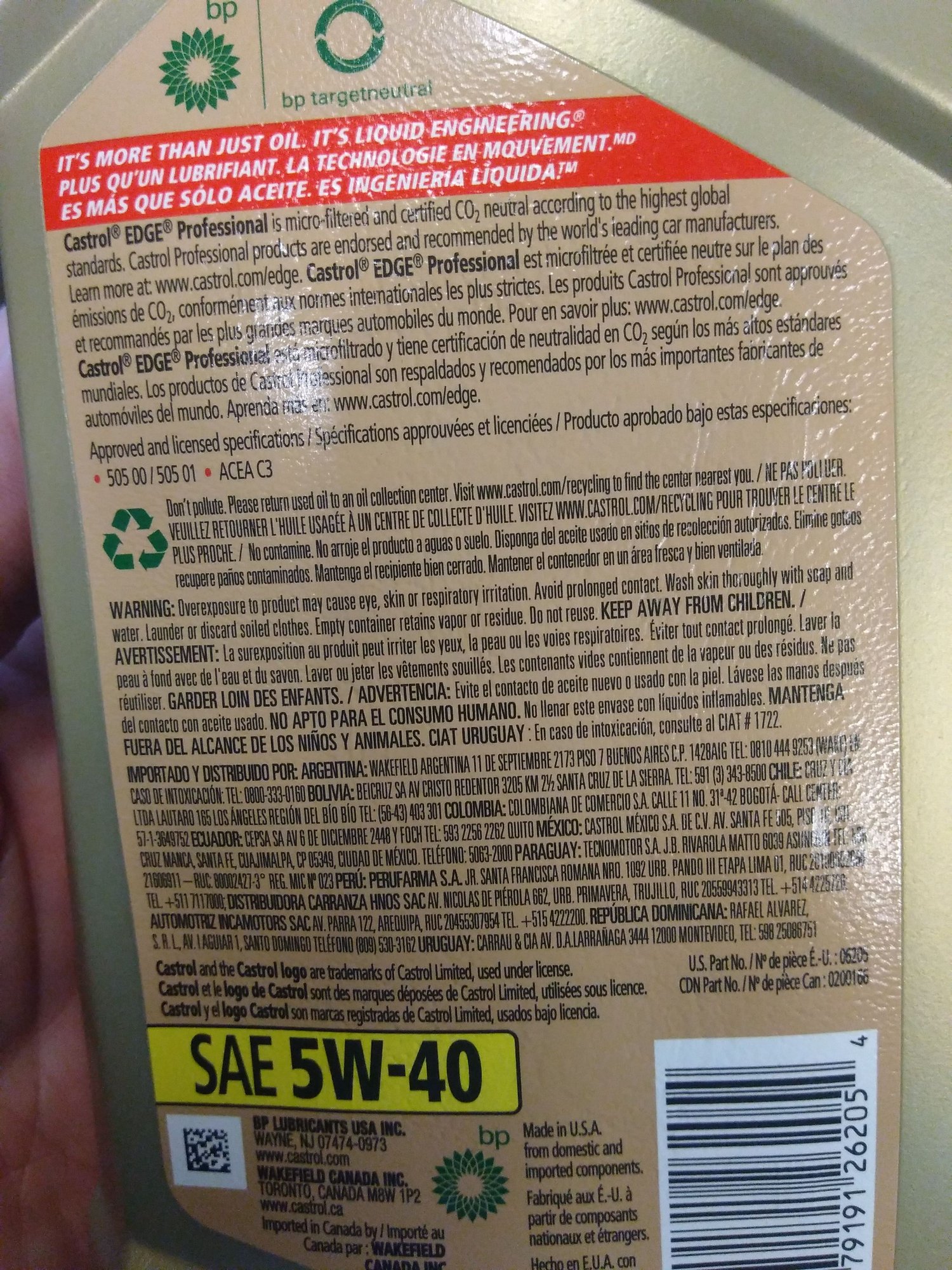

I've never heard of "VW 502", is that a standards document VW publishes or something? I have for a long time been a 5Kmi oil changer, and I usually do it myself, which I guess is good because I have full control over what oil to use. Although I have heard that extended warranty companies can sometimes try to weasel out of a claim by blaming owner for improper maintenance.
Oil standards have been upped since the last time I looked. The picture of the latest Castrol Edge 5w40 oil with newer VW standards approved and licensed specifications 505 00/505 01. Look at the back of the oil can, make sure it says at least 502 00 or higher for your engine. It used to say VW 502 00, now just 505 00/505 01
If you do your own oil changes keep the receipts and a log for the proof of ext.warranties .
Not quite. 505.00/505.01 does not superseded 502.00, but is a different VW oil standard. Depending on use it may be a better oil that 502.00, or it could be worse. The best advice I've heard is to use the oil spec'd by VW.
RGMN is offline
OK cool I'll check the user manual.
