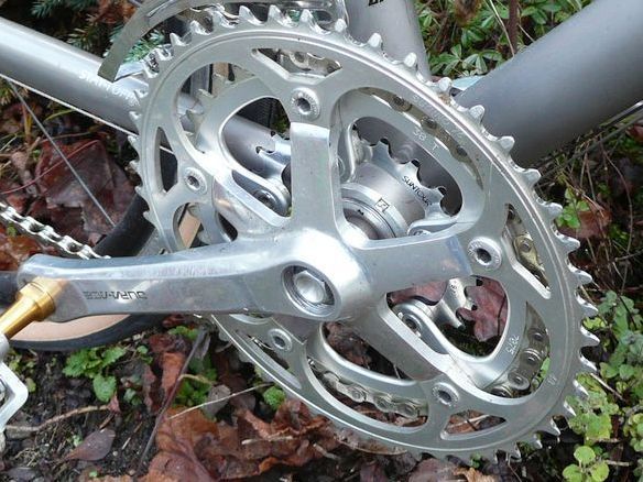

Here's my wife's Dura-Ace 7400 in 165 mm, with a Stronglight triplizer.
I like the Stronglight, but it's more work than the TA, Willow or Thorn, because it doesn't have clearance for the 5 shelves off the inside of the spider arms, so you need to saw the shelves off. Not too difficult if you're handy, and you have a vise with soft jaws, a hacksaw, and a flat file to dress down the saw marks. Takes me about 15 minutes, but most people would be reluctant to take a hacksaw to a nice crank. Especially when there are other triplizer rings that don't require any sawing/filing.
My advice is get a TA. They're very well made, out of good hard alloy, and look great. $54 plus shipping from Bike24 in Germany https://www.bike24.com/p2141592.html
or $88 plus cheaper shipping from Peter White in the USA https://www.peterwhitecycles.com/ta-...ings.php#alize (scroll down to "tripleizer" -- that's the way he spells it)
I leave it to you to decide which is a better deal once shipping is added in, but shipping from Germany will probably be slower too, a factor if you're in a hurry.
Good luck, let me know if I can answer any other questions.
If I completely misunderstood your situation, then -- never mind!
Mark B in Seattle

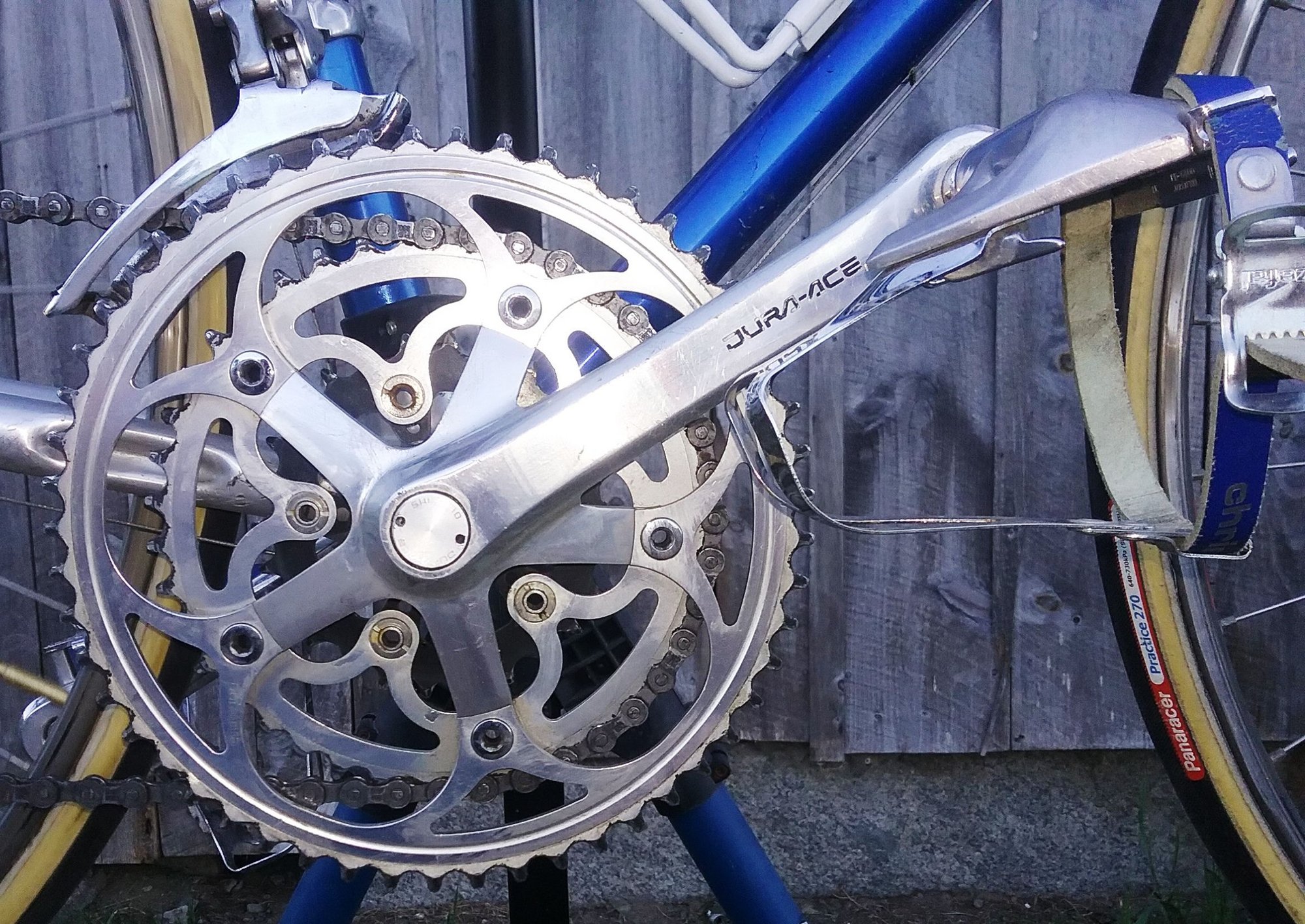

+1.
Willow triplizer on Dura Ace 7400 crank:

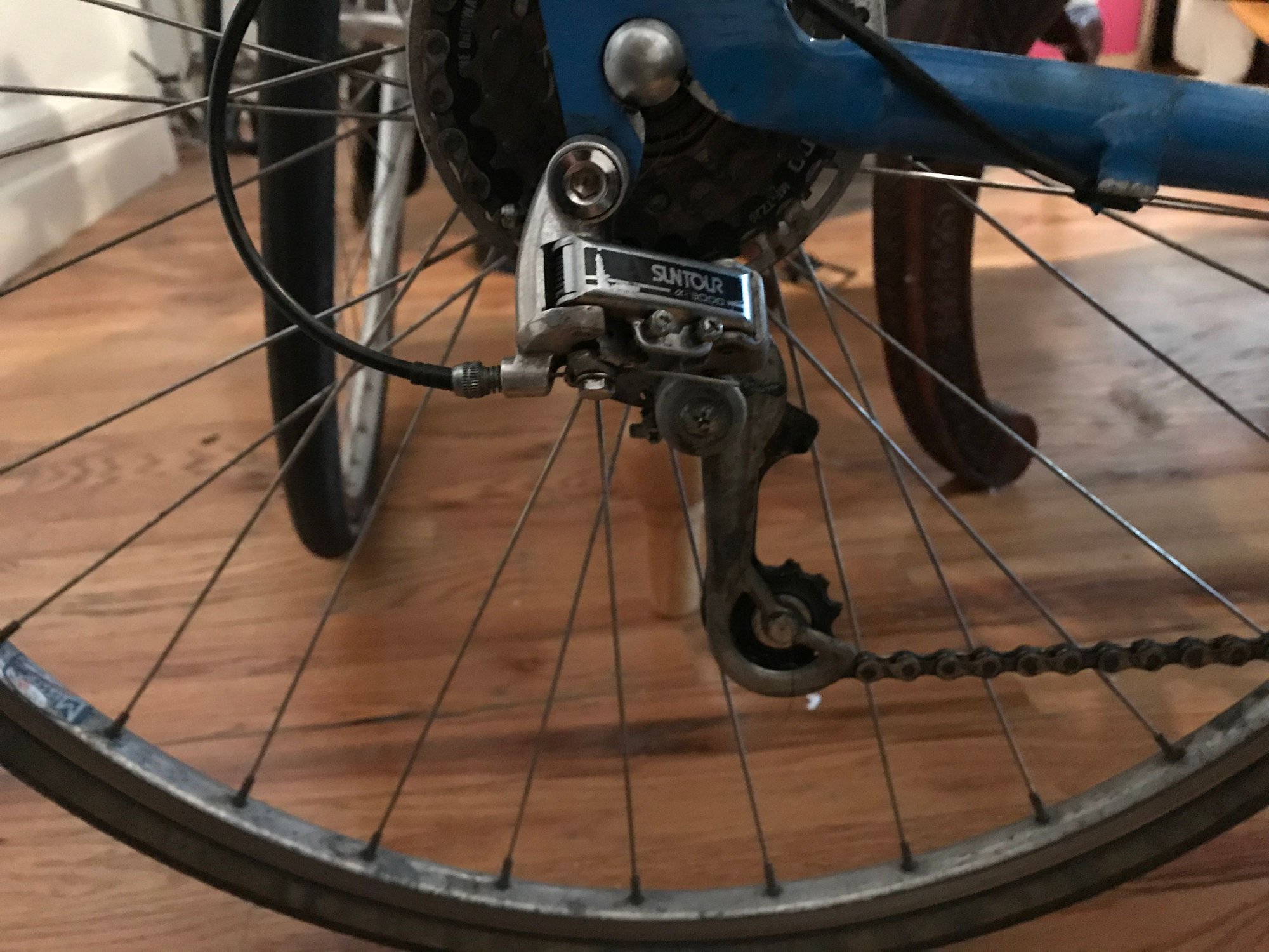

This is what I'm working with, it came with a long cage OEM, and the original crank had the spot for a granny, I just swapped it out to use the 165 crank arms for her.
