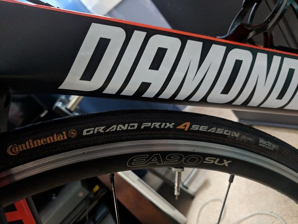

Quoted: 128 Post(s)
Liked 3 Times in 1 Post
Originally Posted by jam7958 View Post
Hello! I am looking to buy a podium rim brake frame set, but I want to make sure that it would fit cont gp4000 25mm since they are my favorite tire. I use prime 50mm and Mavic SRL wheel set. Any thoughts would be welcome
The rear is super picky with 25c 's, make sure they are of the shorter variety. Check rolling resistance data on tire height.
Only had luck with Hutchinson's and Giant Gavia 25c tires, my Schwalbe Pro One's on Boyd Altamont wheels were too tall .
Here's mine with Hutchinson Fusion 5 Galaktics .

motosonic
motosonic's Avatar
Join Date: Feb 2017
Posts: 630
Quoted: 275 Post(s)
Liked 3 Times in 2 Posts
I have a Rally/UHC Team Podium and I'm running Conti 4-seasons in 25 on the back and it's fine. As you can see in the pic above, IMHO it's the front that's super picky. I'm pretty sure my tires come a little closer to the frame than that. But they still fit. lol
