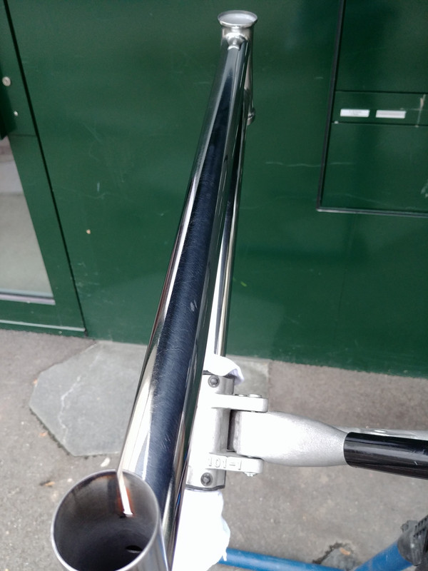

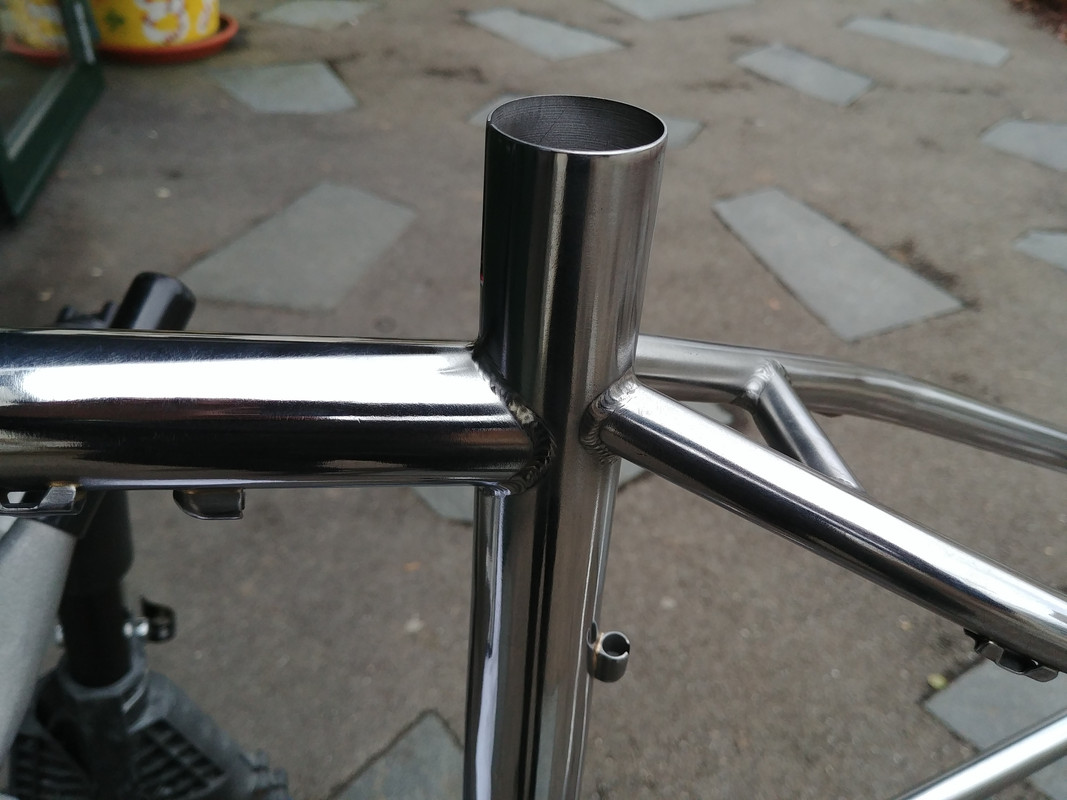

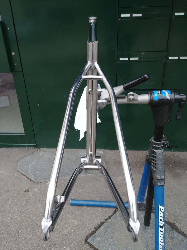

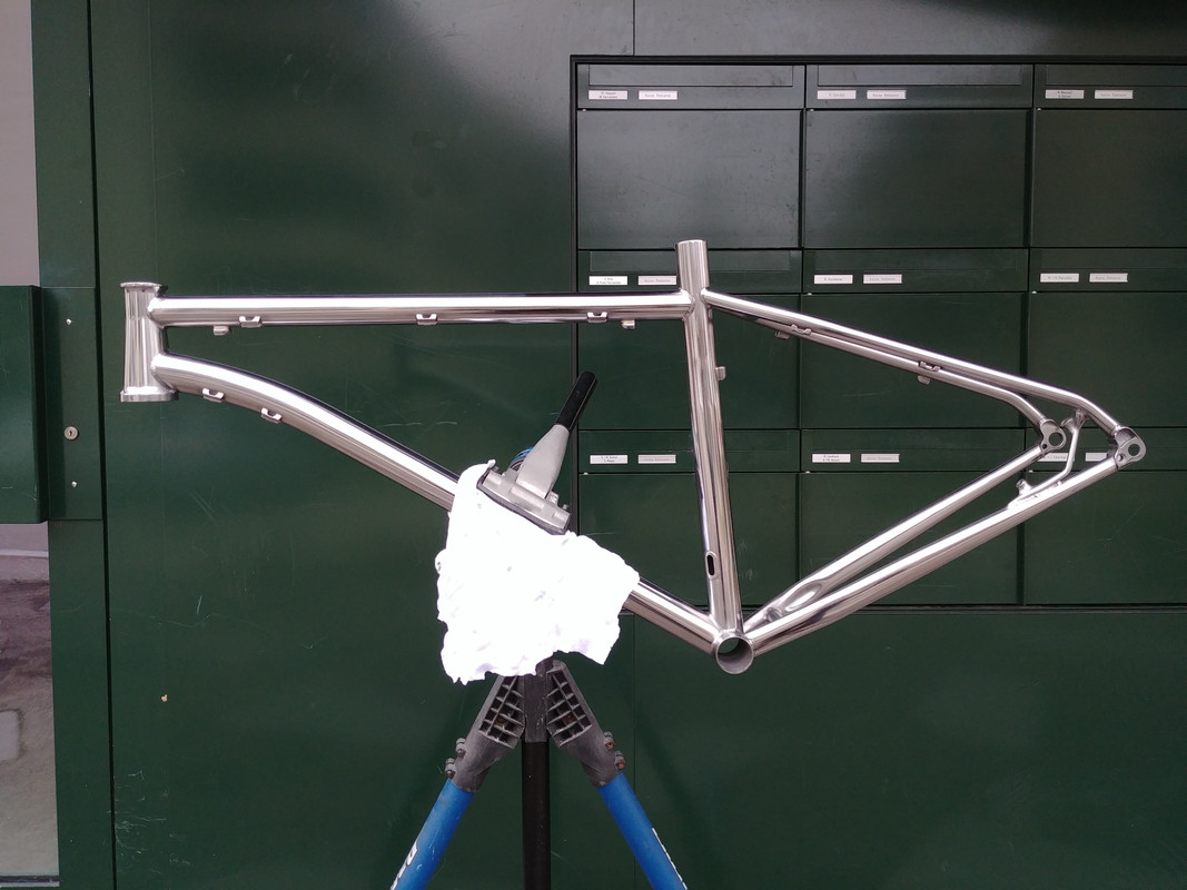

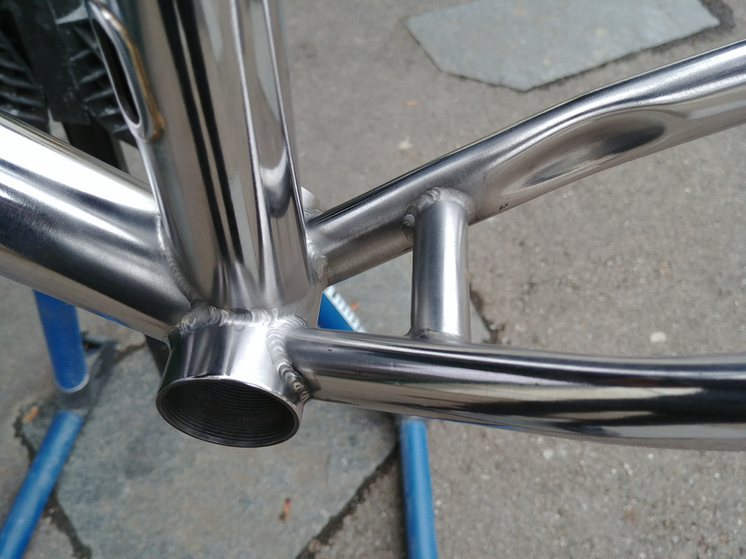

Today I finished with the polishing. It looks good but admittedly I messed up on the sanding. No going back now though. I have lost my motivation as this work is grueling.
The plan is to hand it over to the chroming firm and have them finish up the details before chroming. The last chroming company did not make such a good impression so I am getting quotes from a couple of reputable German companies.

Realizing my mistake with sanding, I went back and removed many of the fine scratches. Went over the whole frame with up to 1000 grit and started buffing today. Should be done and ready for chroming some time soon.
The photos don't say much but here they are:

Finished with the sanding and polishing. Frame and unpolished rims going to a German firm for a final polishing for both and chroming for the frame. The rims will be left as naked aluminum and I will treat them with metal polish / protectant from time to time.

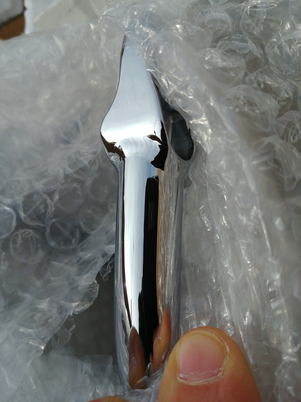

Received the hubs/spokes/nipples this week. Can't build the wheels up yet without the polished rims..

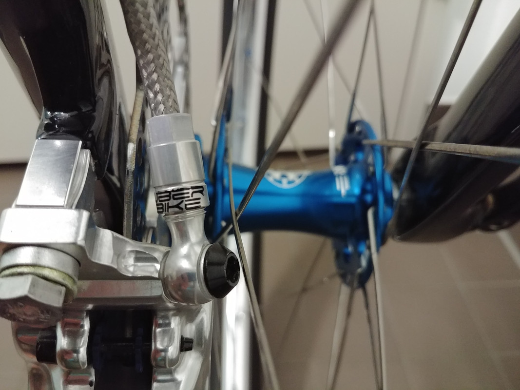

So, like I said, took my time today on the brakes. I knew there was a reason why I saved this for last.
This was my first time cutting brake lines and setting them up 100%. All went well, just slowly.
Bleeding the rear brake was super easy and without a hitch. It was the front brake that ended up leaking after the first bleed. That was caused by a barb that was not completely seated.
I may have to consider getting some real caliper screws. The hardware store here (European hardware stores! What a joke!) had only 30 and 16mm M6 stainless allen screws. For the longer front caliper screw, I had to use a standard bolt and cut it down from 40 to 35mm because of the +20mm disc adapter. I'm running 180's on both front and back. Speaking of which, I love how the Timby has a flat mount 180 in back.
The brakes are really great. Loads of modulation and effortless braking. I picked up some organic BBB pads which are always smooth. Coincidentally the blue matches perfectly.
There is one issue with the brakes and I wonder if this is a known issue for the Magura's. The clearance between one of the caliper bolts and the spokes is beyond close. In fact, when braking hard the spokes started kissing it:
Most likely I will file down the head slightly. Other options? Remove the washers?

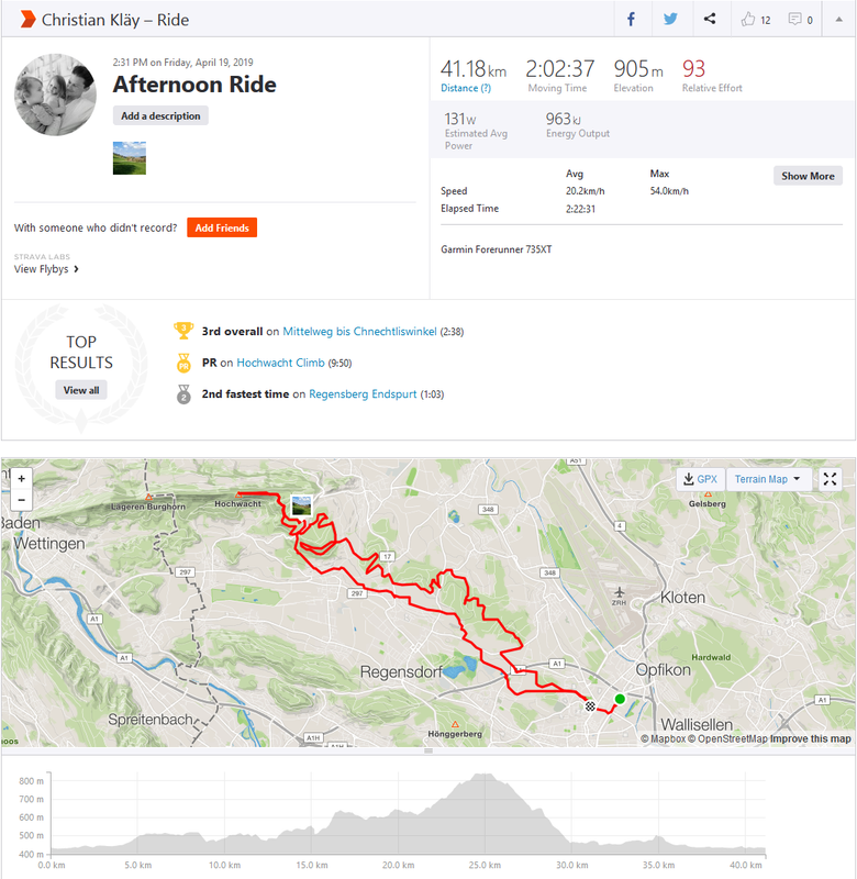

Today I installed the silver 100mm stem again. Also re-adjusted the stack pre-load to just about zero without play. Now the ride is much less twitchy. It is still slightly nervous and I'm going to give the fork credit for that.
This bike's geometry is very different than the 1995 GT Tempest that I usually ride. So the ride will take some kilometers to get used to. That said, I took it out for a 40km ride today with 900m of elevation gain (and then loss!) and I must say that this bike is almost nearly impressive. I honestly can't say that I'm too impressed with the frame, but it aint bad. The build is but top notch and exactly what I needed as an upgrade to the GT.
First off, the disc brakes make downhill an absolute breeze. With 1 finger I got all the power I needed. The wide(er) wheels allowed me also to run less tire pressure on my tubeless setup which allowed better handling and grip.
The steel frame put together with the low tire pressure makes this ride feel like it has a suspension. With the front tire at 1.8bar and rear at 2.0, I took some seriously rocky terrain at speed and didn't feel a thing. This is where I was impressed.
The frame itself is just okay. Nothing special. But damn it looks good.
Note: chainsuck 3 times on the ride today gave the chain-stay it's first scars.
Plans: My wife was right, this bike would look great in all-silver. I will sand the fork and seatpost before bringing them to my favorite auto shop for a professional paint-job of the most metallic, chrome-like paint they can do.
Most importantly, before (and after) the ride today I spent some quality time with the fam:

Brakes: Magura MT Trail SL with extra double caliper for rear
Discs: Hope 180mm silver
Brake-levers: Magura HC3 (purchased used)
Brake-lines: Uberbike stainless kit

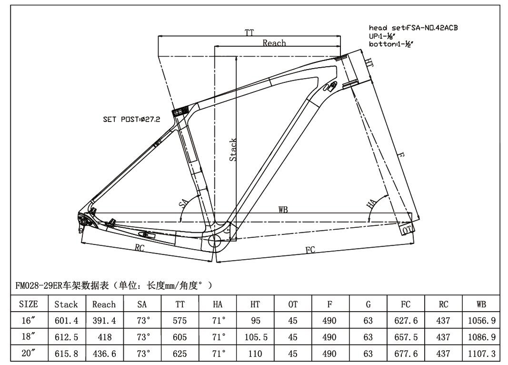

So after 6 months of riding I am deciding to ditch the frame. Already have one on the way from China:
In size 18, the geometry is perfect for me.
Will swap all components out and eventually build a new (29er) wheelset. I also need to order a 490mm rigid fork.
Kinda sad really, with all the work that went in to the Timby. But the frame can hang nicely as deco until the kids are older. Or maybe I would sell it. Hell, it would fit my wife pretty well too...
