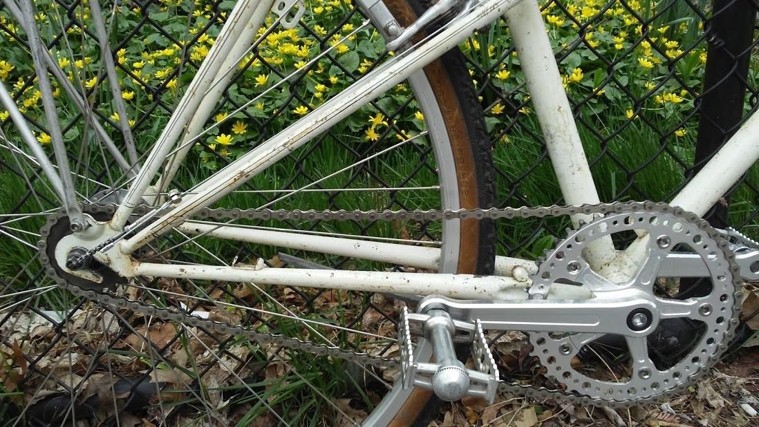

Actually I have a period Cyclo chain tensioner. All I need is to work out how to attach it to the chainstay or dropout.
Road Fan is offline
gster is offline

Originally Posted by gster View Post
Great pics! Yours seems to be a derailleur, not just sprung tension arm. Mine is missing the band clamps around the chainstay. It also does not need the shift cables or the long coil spring, as far as I can tell. What is that long coil spring for?
I also don't have that arm that is reaching forward from the dropout to the derailleur.
OOPSQ! that "arm" is the drive chain!
Dealer installed option.
It's not my bike. It belongs to a neighbour/friend who bought the bike new
in 1956. He fit the Cyclo and the 3 cog cassette shortly after. He refers to
it as "French gears".
It's a Norman Club bike that has clearly been well loved and ridden hard.
The original bill of sale and the cancelled cheque to pay for it!
He paid an extra $5.00 for a kickstand and electric horn!

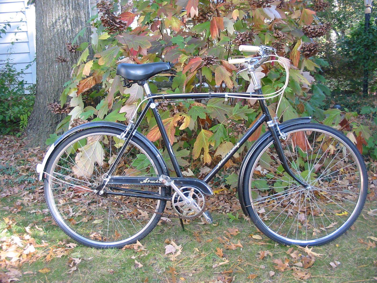

I have a 23" 1969 Armstrong. Are there any other Armstrong owners out there?
