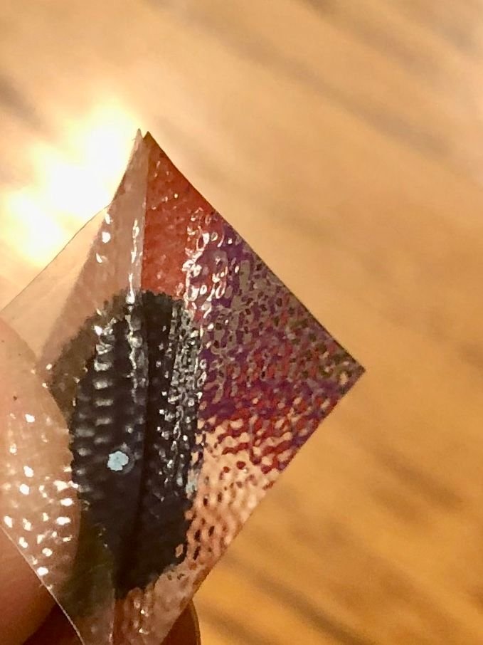

4) The patches come with foil (on one side) and clear film (other side) protectors. No mention in instructions about removing this packaging. Pretty obvious, but its hard to get a foothold (fingerhold) to get those things off.
5) The patches come with one side all blue, and the other side with a black dot with blue surround. Anyone know which side goes towards the tire? Wasn't in the instructions.

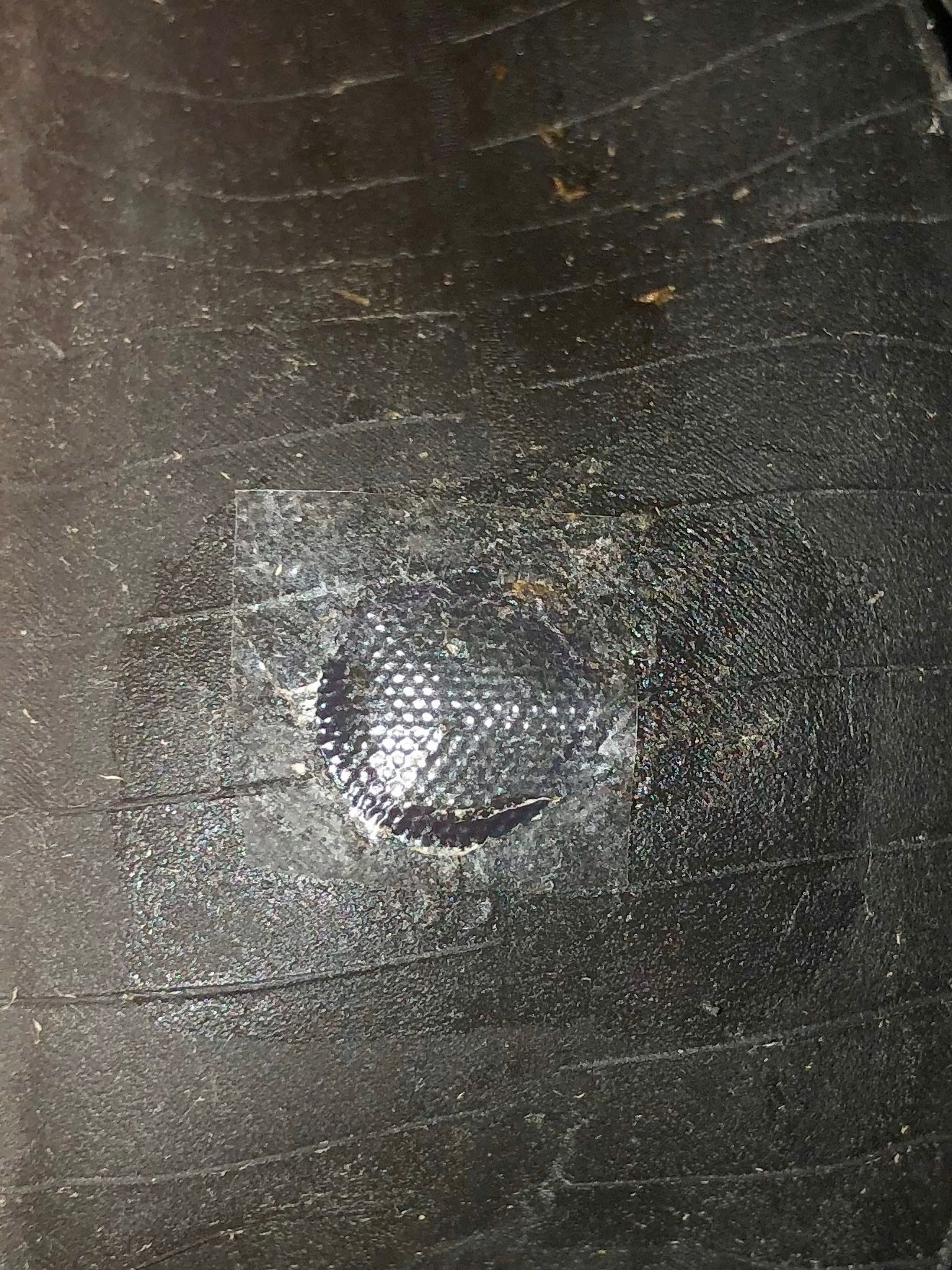

Yes I have successfully repaired a small cut on the tread using the Hutchinson tubeless repair kit. I applied glue to the cut on the outside of the tire, sanded and cleaned the interior, applied liberal amount of glue to the area where the patch would reside, applied the patch (you must separate the foil. The side that you just exposed goes on the puncture)), let it dry, and remounted and applied sealant to the tire.

I left the clear plastic part on top of the round patch itself because it seemed to be stuck on there pretty good and it wasn’t going to affect the bond between the patch and the tire. I switched from 25mm tires to 28mm which is why it’s not on my bike.

I could be wrong but I don’t think you can use too much glue because I used a lot. I wanted to make sure every bit of the patch to include the plastic I left on was covered well. I didn’t remount the tire or apply sealant until it was dry.

If you look close you can see the area where I applied the glue surrounding the patch (it’s slightly darker). Note the plastic part didn’t stick, but it allowed me to massage the patch really well.

And peace upon your house, too AnkleWork. I'm not trying to frustrate you. I now see that while the texts describing the kits are EXACTLY the same, and the "Description" is nearly exactly the same (different size tube and patch, but using the words "instant adhesive" in both cases), that the DIMENSIONS are listed differently. I guess I'm just too much of an engineer: I expect DIMENSION to be, like, a number or numbers with an associated unit(s). I suspect that I saw "DIMENSION" and didn't even look at it. So one item has dimensions of "Rubber Glue" and the other has dimensions of "Instant Adhesive"? And BOTH are described as having "Instant Adhesive"? Given that I missed the "rubber adhesive" and I WAS LOOKING FOR IT, and that both items have identical text blurbs and nearly identical descriptions, and yet are (apparently) different, I'd have to say that this is another extremely example of extremely poor, customer unfriendly communication on Hutchinson's part.
I am not letting go of the poor instructions for the MTB kit, because I think it's dangerous. Further, I think that the MTB kit should at least have stuck to the tire and sealed it temporarily, and it didn't. I tried some of the techniques others used above (keeping the clear plastic on, for example) and held the thing for five minutes. And it still hadn't stuck - came off easily. I did try the technique jadoc suggested, but I guess I wasn't as adept.
I've written Jenson USA (because I remember clicking on the Road option when I ordered, and got the MTB option). No response yet.
Yikes, yeah there is definitely something going on with that glue in the MTB kit. I will caveat my experience with the fact that I think after applying the patch, I let it sit for a good long while. I wanted to make sure everything was dry before I made it wet again with sealant. I also made sure to clean the area very very well using rubbing alcohol prior to applying glue and new patch, because the surface was "greasy" so to speak from the old sealant.

Did a nice little 15mile ride today. FWIW, the tire didn't leak at either point.

Jenson's did get back to me and offered me a refund. I've written to Hutchinson to get their side of the story. Will report back.
