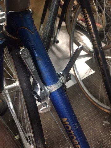

I bought my bike years ago at a thrift store and before my first tour with it niavely took it to a Craigslist garage mechanic. He stripped it of it's suntour derailer, pedals, and more without my knowing at the time. I'd like to get the appropriate parts to replace what he swapped in. I have little idea where to start but thought I should identify the year before purchasing a derailer or anything else. Any advice is appreciated.

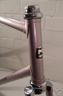

that's correct so keep posting 9 more times or maybe one easy clue: what sort of headbadge is this:
Round? Dimensional (plastic) shield? Flat shield?

If you're lucky, yours will have a "Vitus 172"sticker on the seat tube and down tube shifters. That would put the bike in the late 70s. The best years for this bike. It would have had the SunTour V Luxe derailleurs.

Don't have to have an exact match of parts. Find a co op, and talk to them about vintage parts. Depending on era, it could have a Swiss bb (that you need to reuse as they are hard to find), French sized headset. The rest of the parts are typical Japanese made, easy to find. Of all the French brands, Motobecane seemed to love, love, love Swiss BB. My usual source for replacement Swiss BB is another donor Motobecane. On the other hand, Motobecane often embraced standard Japanese parts. Instead of crappy plastic Simplex derailleur used on many vintage French bikes, Motobecane embraced well made, solid, Suntour derailleurs along with other Japanese parts.
To below, the Suntour Vx GT is a fine choice, and relatively common.

Is your goal to restore it to original factory spec? You may be able to find period Motobécane catalogs on-line that could help. Someone here might be able to decode the serial number to determine the date of manufacture.

I suppose my main goal is to replace the cheap derailer he put on and maybe the pedals. And if like to know the year. There's a coop here in town where I'm visiting so maybe I'll stop in there. The headbadge is round and identical to the top photo posted. I am not finding any of the stickers mentioned.

Ask at the Co-op for a Suntour Cyclone GT, VX-GT, or VGT-luxe. You cannot go wrong with those, and they probably have a drawer with a few to choose from.

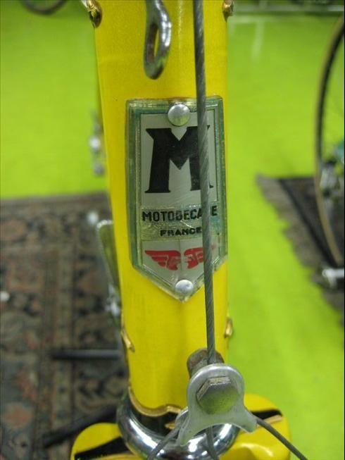

the round badge is typical of a Grand Touring from '74 to '76, the first 2 years had 1020 "light steel tubing" frames where the '76 had a Vitus double-butted tubing with Bocama lugs (a superior frame). All 3 used Suntour VGT Lux rear derailleurs, '74 and '76 should have downtube shifters while the '75 had stem shifters. Most other components are identical but I think the '76 would be the one to have if you're in luck.

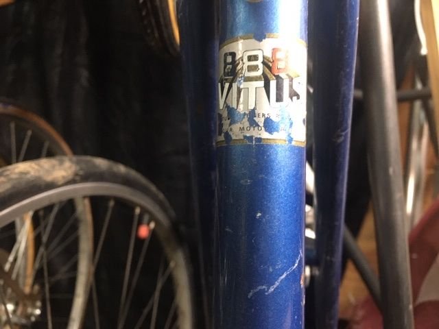

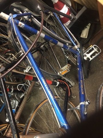

I believe that is either a '78 or an '80. If it has a Vitus 172 sticker on the frame it's a '78. 1980 was 888 instead. Round headbadge and braze on top tube cable guides define that era.
A Suntour V-GT or Vx-GT RD would be appropriate. They were an inexpensive and very common but excellent derailleur at that time, and it shouldn't be to difficult to find one at a coop etc. Looks like the front derailleur is still original Suntour SL, so that's good.
I'd be more concerned that the wheels are original or at least good quality. IIRC they ere using Rigida 1320 27" rims at this time. From the pics it kinda looks like he stole your wheels and replaced with random junk, but I can't tell for sure from the pics. Should be presta valves front and back, Rigida rims, Normandy hubs with QR.
OEM pedals were basic Atom rattraps. They were $5 a pair at the time, but still a reliable and decent pedal. The main thing wrong with the pedals on there is they don't match.
