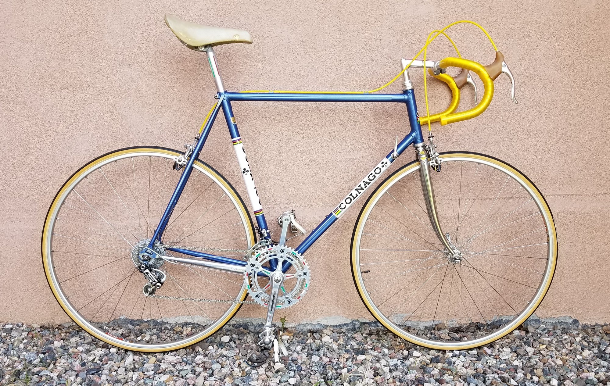

That was a top level bike so yeah Gran Sport would kind of be beneath it if you care about that. Super Record would be appropriate. A picture of one I used to have for reference:
