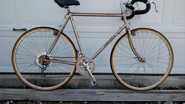

I get it, believe me I get it, especially knowing that you have limited bike buying experience. You did the right thing. You were put under pressure by the seller for no particular reason. I think that the seller knew no more about bikes than you do and simply used information gleaned from Schwinn pamphlets of the time. That could have been a great "barn find" if the seller was honest. Don't forget the the old saying "There's a sucker born every minute" You are not one of them
That's exactly what it was,a great barn find. I was looking for something better, and really expected it due to a long conversation about condition. Even if the seller was ignorant of how to access condition, there were several points that I was obvious, that I had been lied to about.
It could have been a great barn find if the seller was honest. As presented online it was a great deal. As presented in real life...., Not so much. Good on you for walking away
