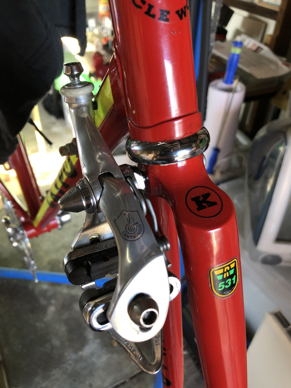

How do you know if a bike is C&V? It will have a small area of paint missing where the front brake has collided with the down tube.
I was cleaning up some (2nd gen?) Chorus Monoplaner brakes today and noticed the front brake has a small rubber stop on one of the cable arms to prevent damage to the down tube should the fork rotate too far.
Was this on all 2nd gen Chorus brakes or has someone added it? My 1st gen Monoplaners (with the slimmer arms) don’t have it.
Neat detail.
Neat detail.
