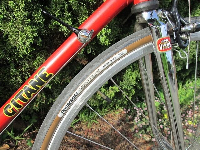

700c x 26 Gravel Kings
Originally Posted by Lemond1985 View Post
From my experience, the Conti GP4000II's in 28 mm were around 30 mm on all of my rims, but Panaracer Gravel Kings when mounted on the same Mavic Ksyrium rims measure around 26 mm.
YMMV on some of the newer wide rims, but I found that the Gravel Kings run about 2 mm UNDER 28 mm, and the GP4000's run about 2 mm OVER 28 mm.
I recently tried a set of 700c x 26 Gravel Kings. Mounted them on Mavic Reflex SUP rims which are very similar to Open Pros. I'm running them at 90 psi. They originally inflated to 24mm but have "ballooned" out to 25mm after about 50 miles so your 2mm comment is close.
They have an amazing ride! They coast, accelerate and climb like heavy sewups! The sidewalls are pretty stiff due to the heavy rubber protective layer which changes the feel when cornering.
I bought them to try out because several places that I ride in the evening or at night have separations in the asphalt pavement up to 1" wide in the direction of travel. That tears up Continental side walls, even Gatorskins.
I've never had a problem with 700c x 25 Panaracer Paselas on those pavements until recently when I got a small cut right at the tread-sidewall in one of them. I changed it but I'll probably boot the tire and keep it as a spare.

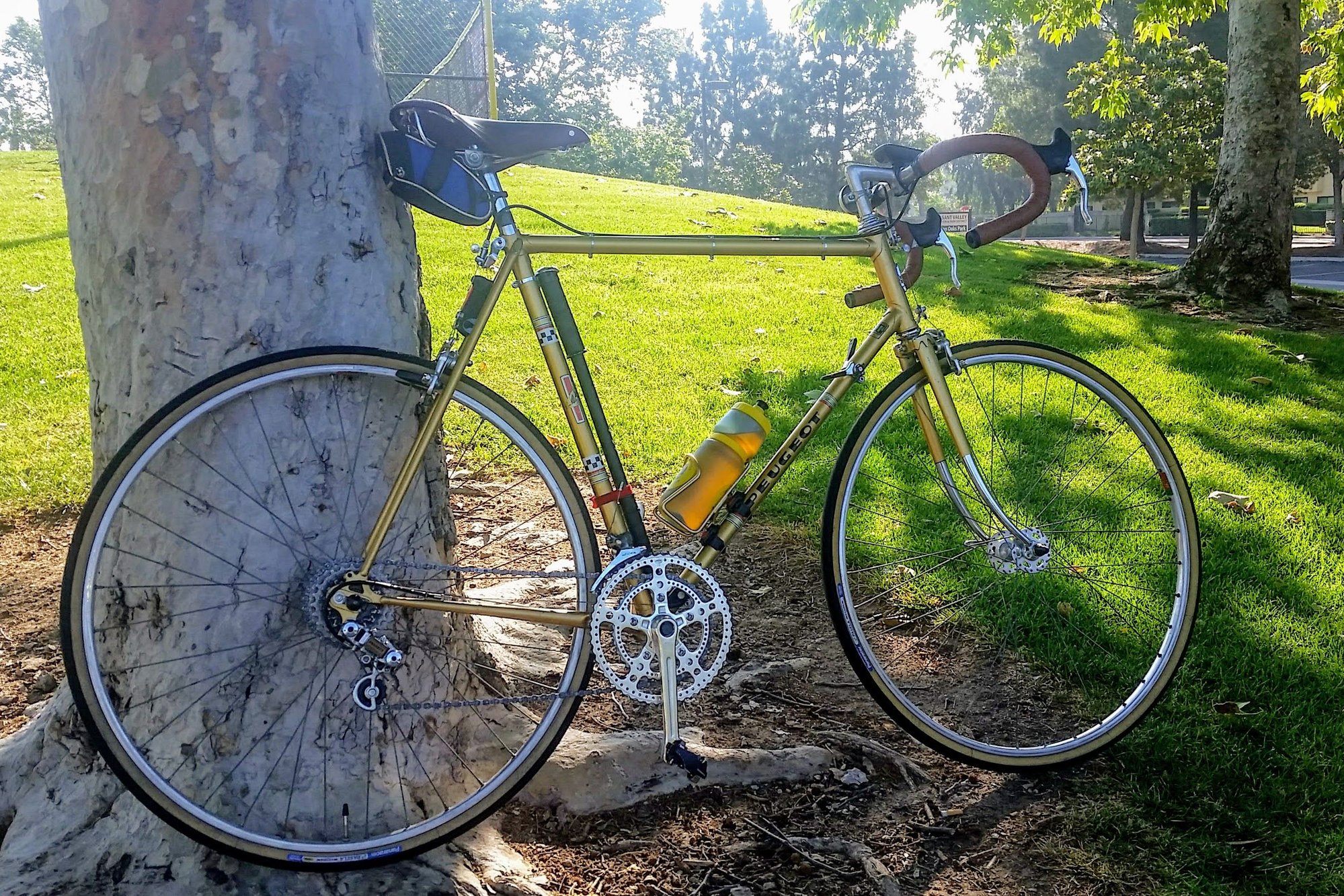

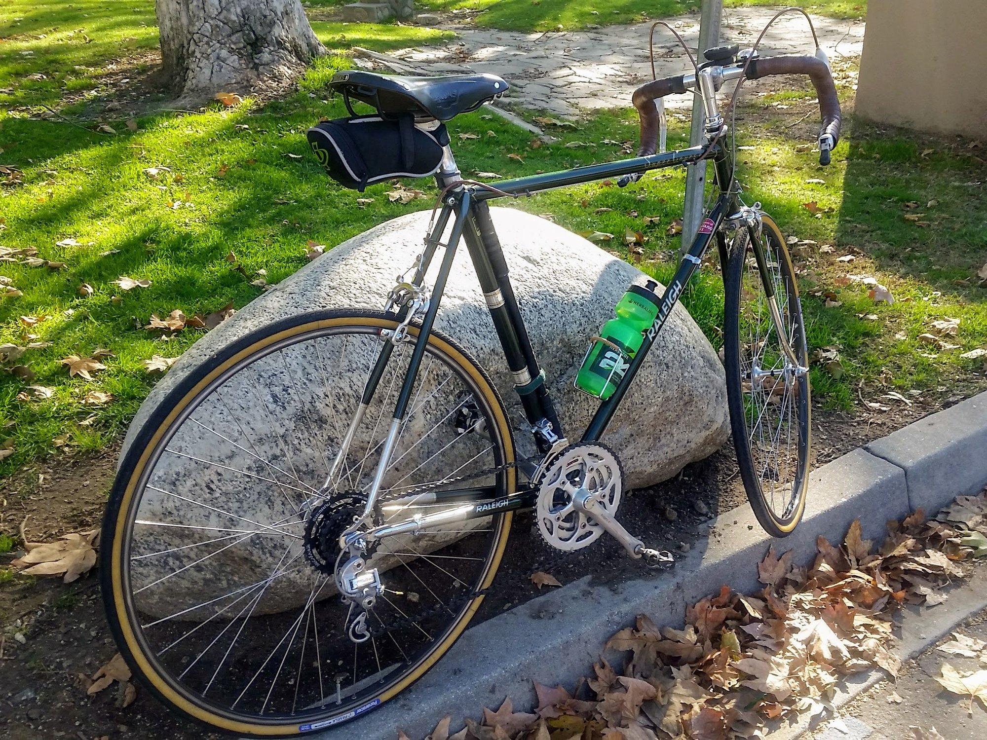

I've got Pasela 28s on narrow vintage rims, Mavic MA40s and modern wider CR18s. I can't tell the difference in comfort, speed or ride quality. I think they look kind of chunky on the wider rim, and prefer the look on the narrower vintage rims, but that's just personal preference. I've also used Gatorskin 28s on narrow vintage rims, and they worked fine.
Pasela 28s on wider CR18s. These measure 26.6mm.
Pasela 28 on vintage silver finish Mavic MA40s. These measure 26.5mm.
Pasela 28s on dark anodize MA40s. These measure 26.4mm.
Gatorskin 28s on no name narrow vintage rims. These measure 27mm.
