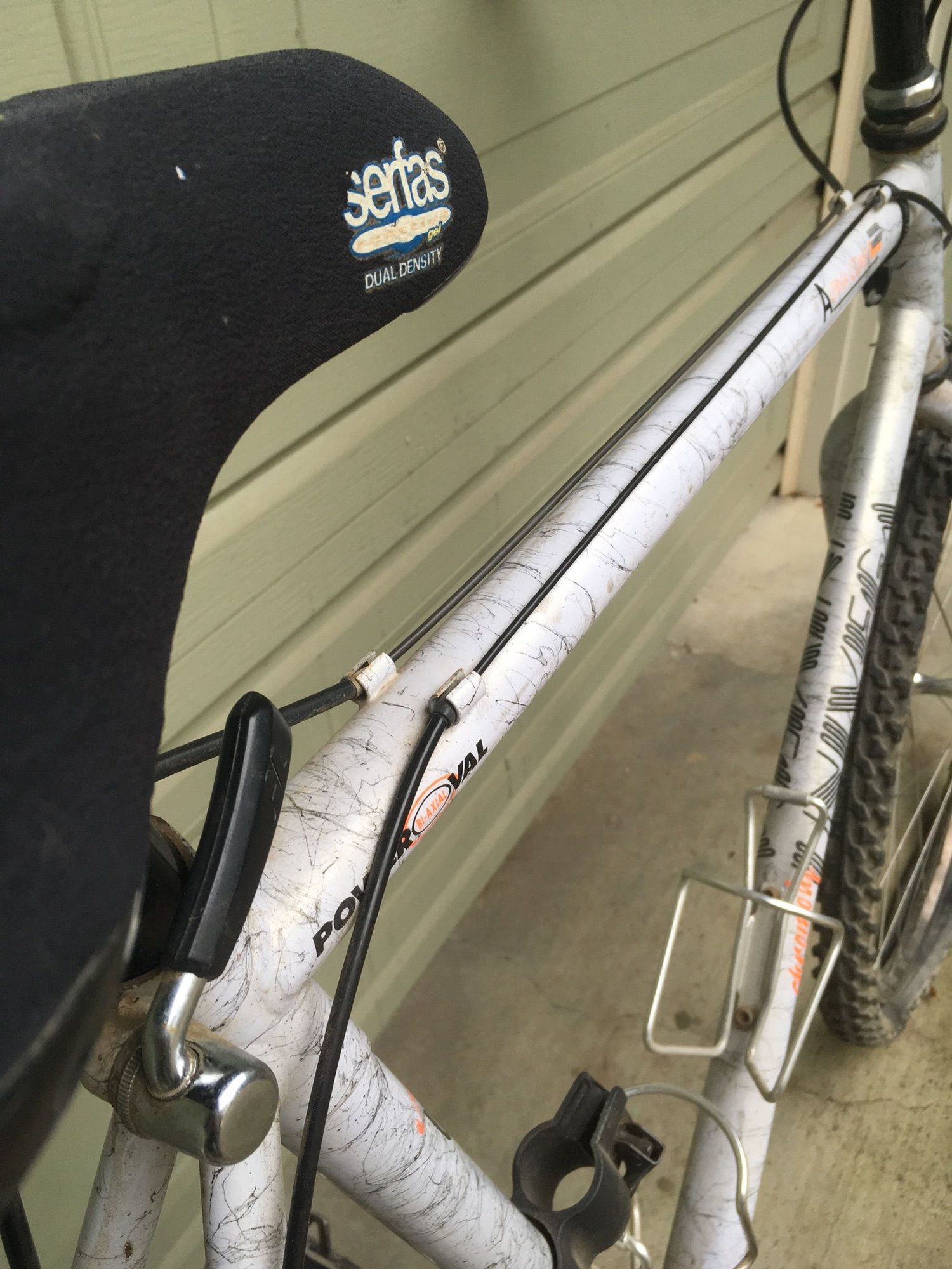

I love this top tube cable routing...

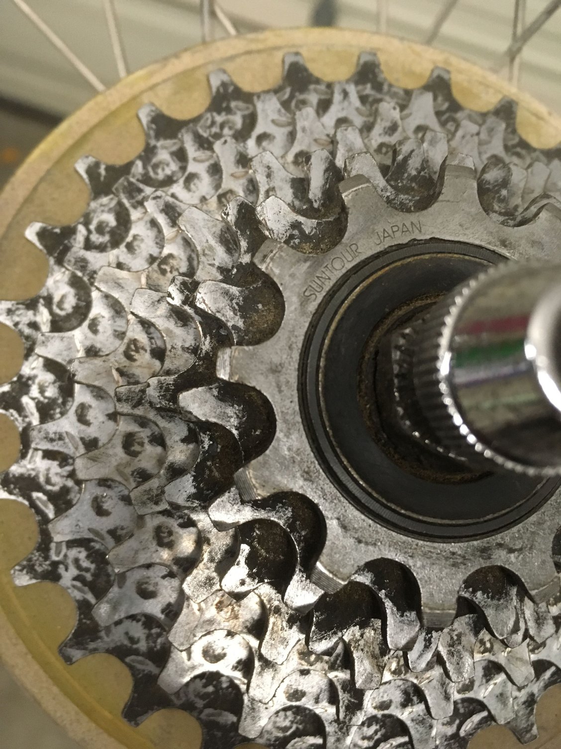

Starting the teardown... All Suntour drivetrain, even the chain. Pity that it’s severely worn. Also Suntour cassette mounted on Suntour GL hubs.

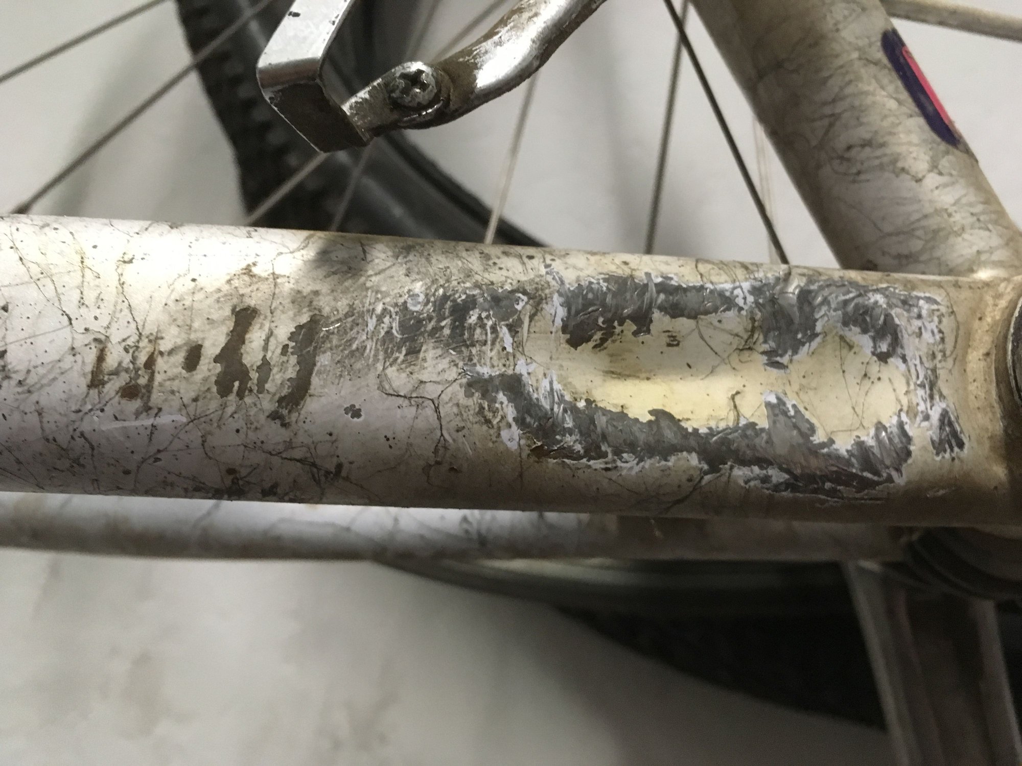

This doesn’t look too bad, right? It’s chainstay rash down to bare steel, and the 24-tooth granny ring is bent, so the chain must have seized. Just file to smooth and apply Rustoleum? Frame alignment does not look to be affected.

Yeah I would say the granny ring is bent, RJ may have a video on fixing that or you can probably get a straight one cheap at the local co-op I have purchased new Sugino rings and don't think they are that expensive if you are just getting one.

I'd clean up the chainstay, apply a bit of body filler, smooth it, and touch up the paint. It's a very inconspicuous spot, behind the chain, so touch ups are easy to get away with.

Nice bike. The Alpinas are nice bikes. I like the suntour stuff as well but the indexing was hit or miss. I wouldn't sweat the damage to the chainstay; just touch it up and ride it.

The easiest way to straighten the chainring is with an adjustable crescent spanner. Remove the middle and large rings but keep the granny fastened to the crankarm spider. Tighten the jaws of the spanner over the point of largest deflection from true and bend back. It may take some trial and error.
The stay damage is typical chain such symptom. Given the location, any touch-up will be largely inconspicuous.

I appreciate everyone’s reassurances - I will likely just straighten the ring rather than replace, and the touch up looks straightforward.

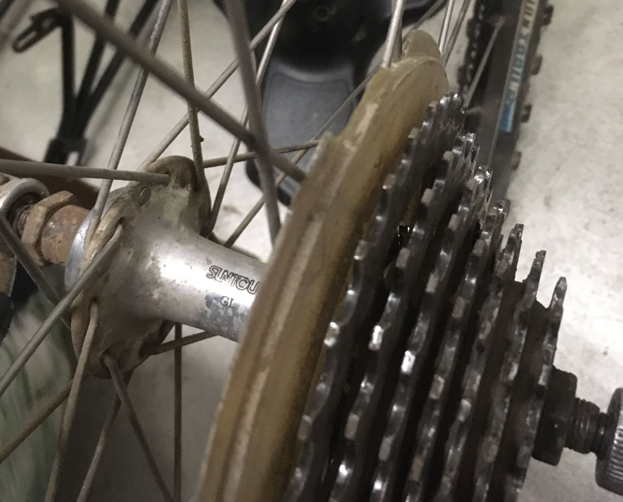

Rear hub cups and cones are in very good shape, but the front is mixed — cups look excellent, but the cones are shot. Luckily, I have a random spare Sunshine front hub that also uses 3/16 bearings, so I will give that a go and try to cannibalize the cones.
