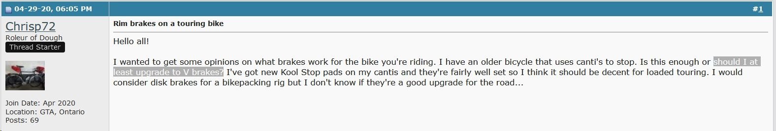

Hello all!
I wanted to get some opinions on what brakes work for the bike you're riding. I have an older bicycle that uses canti's to stop. Is this enough or should I at least upgrade to V brakes? I've got new Kool Stop pads on my cantis and they're fairly well set so I think it should be decent for loaded touring. I would consider disk brakes for a bikepacking rig but I don't know if they're a good upgrade for the road...
If you want to 'run what you brung', and like your current bike, the cantilevers (adjusted correctly with good shoes) will work fine.
If you still are set on new brakes of any type try the V-brakes with the proviso you may need new levers or modify the old ones due to the pull ratios.
I run Shimano CX-50 cantis with Ultegra shoe holders so I can easily replace the shoes without re-doing the toe in, and am very, very pleased. My other bike has Mafac Racer centerpulls and I like them alot.
