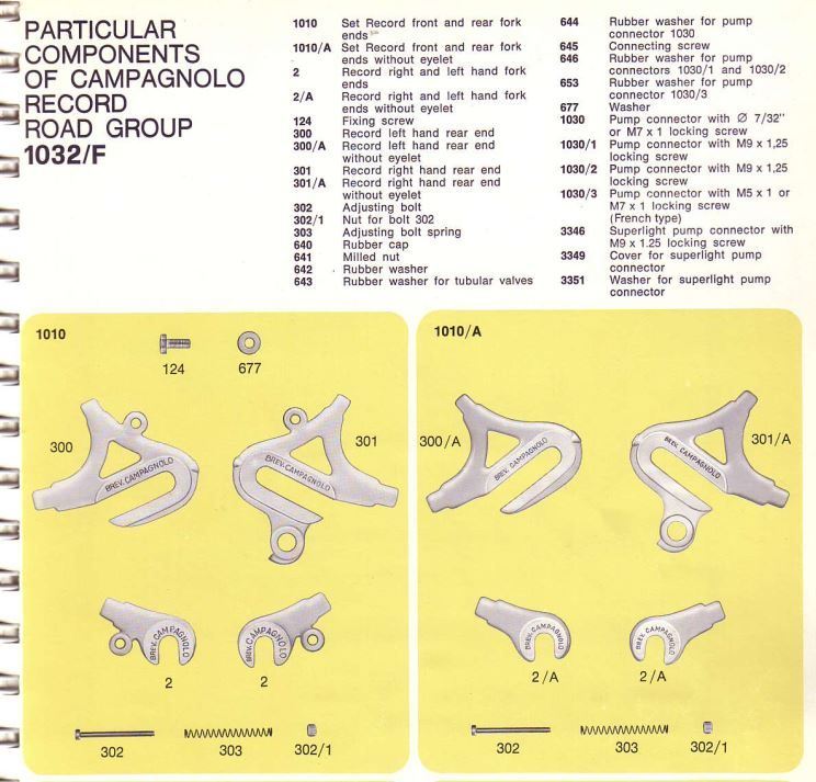

Originally Posted by wawine
just about every bike ever made with Campagnolo 1010A dropouts at that time, had fender eyelets, as they were part of the forging itself.
Just to be a niggling truthist: The ones with eyelets were mod.1010 (no slash A). If you wanted no eyelets, you didn't have to cut them off, you could just order mod.1010/A, which were forged without eyelets. This is clear from looking at them in the raw, as I have done many times -- 1010/A were clearly made without eyelets to begin with, not made with and subsequently removed.
From Catalog 17, 1974:
I'm not disagreeing with your main thesis though.
Mark B in Seattle
