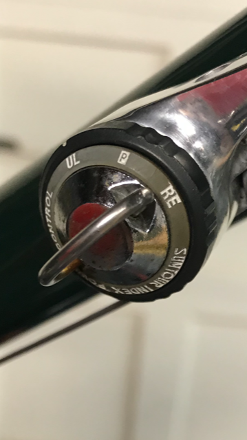

Can anyone tell me how these are supposed to work? I am not familiar with the markings on the adjustment, nor SunTour in general.
Anyone know what model these are? They are driving an XC 9000 RD if that helps any.

Its been a while but I believe the RE is for 6 spd and the UL is for 7 spd.

Why do I always find the answer after posting? I did an exhaustive search beforehand with no luck. I changed my Google search slightly and BAM!! I found this PDF in my search finds:
https://www.yellowjersey.org/Suntour21.pdf
Page 10 outlines what each marking means, but here it is for the short answer: The UL is for ULTRA-7 index cassette. These are narrow spaced. The RE is for standard spaced Winner Systems, 6 speed. The P is for non-indexed friction shifting, regardless of the cassette. I have attached the document for those who may have the same technical questions as I did. Suntour is pretty finicky it seems on what will and what won't work with each other.
Yep, you are very correct! Thanks! What is interesting is I am glad I asked. Mine is set on UL and I have the Winner Pro 6 speed. So mine needs to be set on RE. I was counting the shifts on this and got "7" when I operated it. So, knowing I had a 6 speed cassette, I was a bit puzzled at that. Now, I know the problem. Funny, it shifted pretty well in the wrong position....
