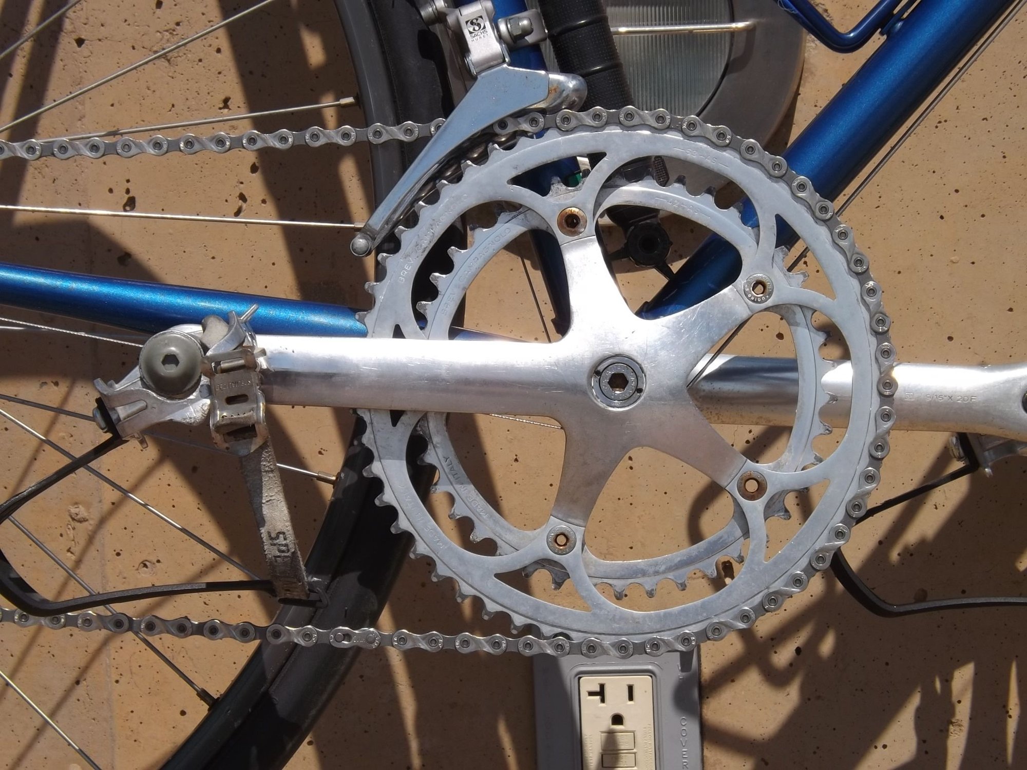

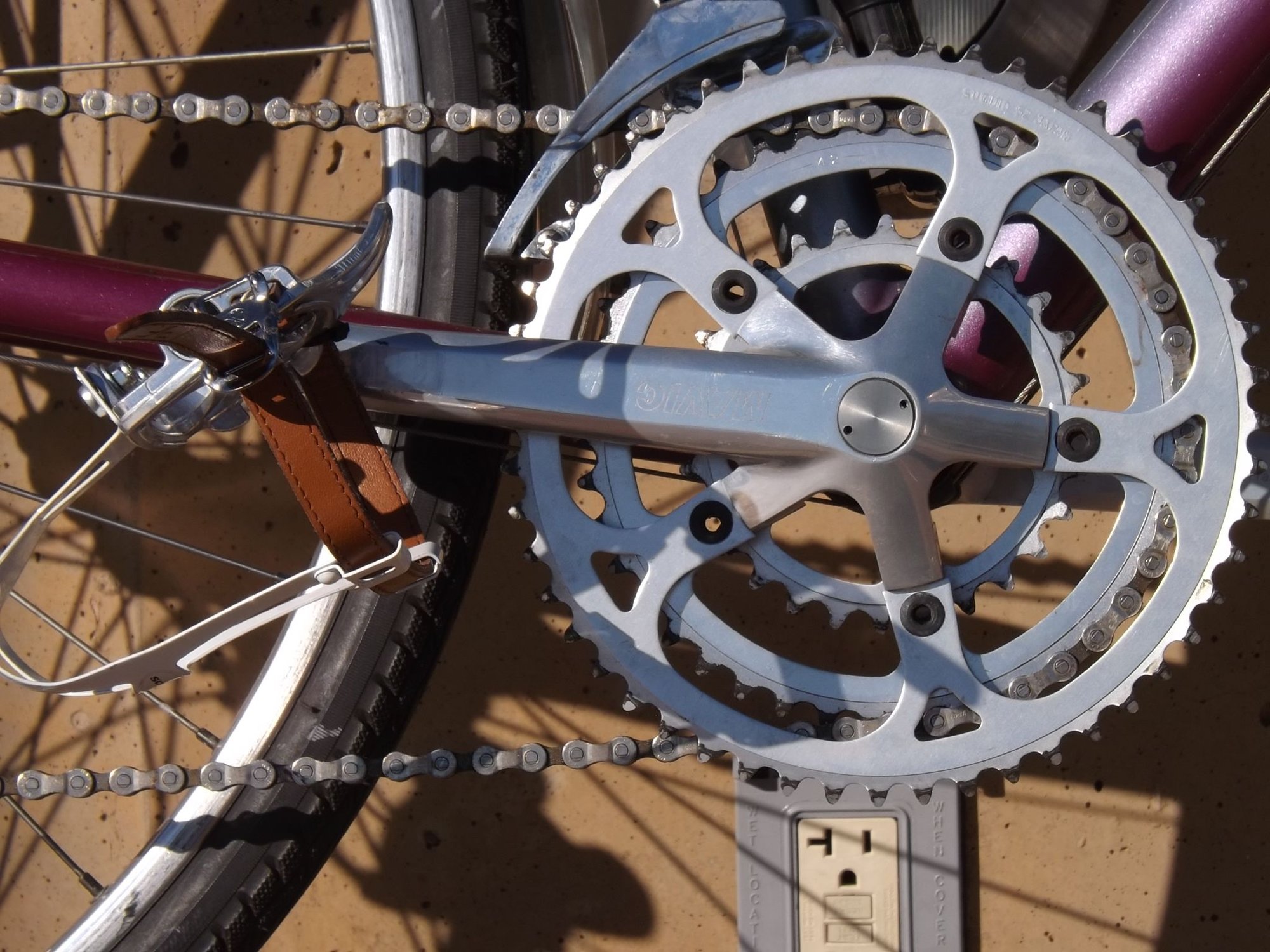

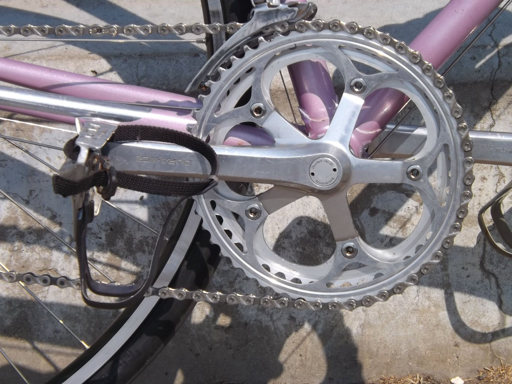

Those look like Soma clips, which, in my experience, are the best. They are a copy of an ICS design. Their straps are pretty damn good, too. Not cheap, but you get what you pay for.
I had some All City double straps for a while, but I could never get them tight enough for some reason. Replaced them with some Cinelli straps which have been great.

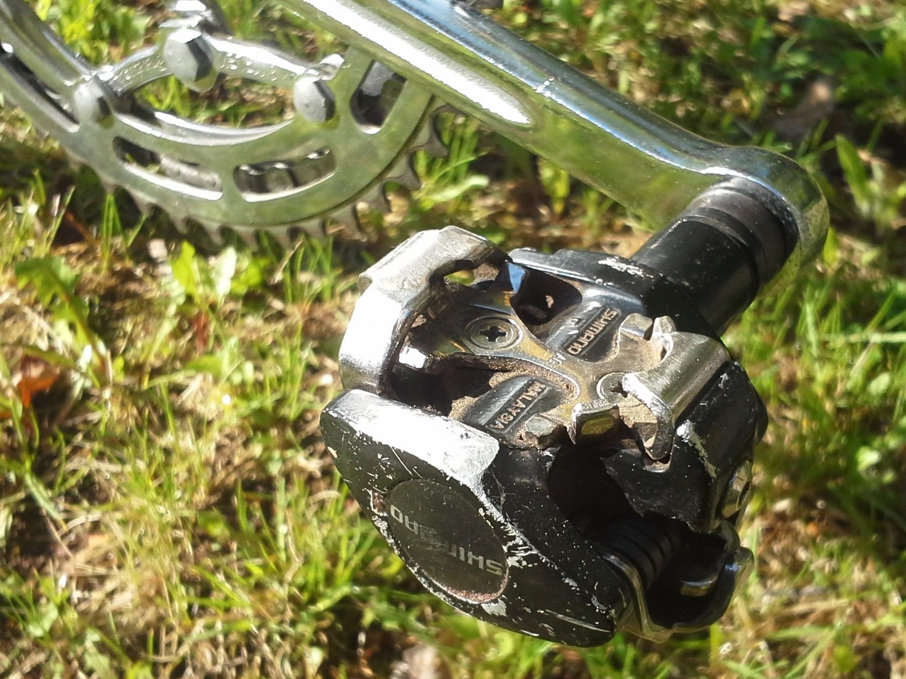

BITD yes I used them but not today. I have two sets of pedals for the older bikes, Look Keo and traps. Shoes for both too. Early in my biking experience with drop bar bikes I sued the traps with running shoes that were fairly small in cross section. Then, as mentioned, they ballooned in the sole and it killed the approach. This was back in my youth when I could not afford good shoes and didn't know or was apprehensive about cleats.
I try, infrequently succeed, in color matching the pedal with the bike in some way.

I went back to riding toe clips and straps for about a year a few years back. I found it was no big deal, but I'd started with them when I was like 12, which was a long time ago now... Still had the muscle memory for it. Overall though, clipless is a better system. Functionally it's about the same as toe clips, straps and cleats, but much more comfortable. That said I didn't find going back to toe clips to be any huge hindrance. For a commuter bike there's still a lot to be said for clips/straps. That's what I always used before I moved to LA. (bike commuting here is too dangerous)
The main problem with clips/straps is that cycling shoes appropriate for them are no longer easily available. For commuting and casual riding the shoes aren't necessary. However, for more 'serious' riding, they are, IMHO. Almost everyone BITD with enough interest in bkes to have a Reynolds 531 or Columbus fancy bike would have been riding with cleated leather cycling shoes, that is to say all racer types and most club riders. Some club riders used Avocets or Bata bikers instead.
Salamandrine is offline

Yes, I won't ride without them. For me, it's more of a safety issue. Without foot retention, my foot may slip off when I hit a bump I don't see. Then a crash is more probable. I don't like to crash. It feels really weird now to ride without them, like riding naked, but worse, far less secure. The bike feels more a part of me with clips. I'm in it, not just on it.
After a couple rides you will get used to them. It is still difficult for me on rare occasion to clip in, especially on an incline from a dead stop. But there are workarounds...

I've been using toe clips since I was 14, and I'm 58 now. I'm perfectly adept at them, but I prefer SPD cleats. SPDs are easier to get into and out of, especially if you're learning for the first time or have taken a break from toe clips. But if you try toe clips, you'll know soon enough if they're for you. They're not for everyone, and don't let anyone bully you into thinking you need them or you need cleats. It's a matter of preference. I ride a lot, and I have foot problems, so my pain is less when I use cleats. But my wife tried both toe clips and cleats. She just didn't like them and doesn't use either now.
If you're pretty sure you want some form of foot retention, I recommend SPD cleats. There are lots of different pedal styles and shoe styles available. Some of the shoes have recessed cleats so walking in them is no problem. There are even SPD sandals for warm summer days. There are pedals that allow plain street shoes on one side and cleats on the other so you're not limited to a kind of footwear on your bike. I have these pedals on my commuter bike, as sometimes I wear dress shoes or sneakers or work boots.
