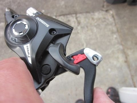

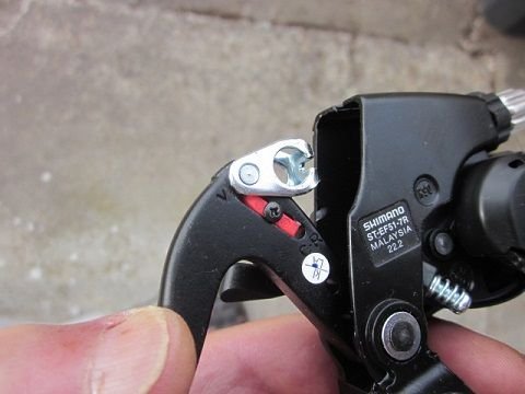

I like the Shimano EF-65's with the integrated brake/shifter.
Get a cassette that's more appropriate for your need. You likely don't need a 30+ tooth largest cog and maybe not an 11T cog. maybe something like a 12-28, 13-23/26. You didn't mention hills, so if you don't have them, you don't need super low gearing. You'll have closer steps with the casssettes I mentioned.
Skinnier tires will shed a lot of weight too. You can go down to 26x1.25" no problem.

Just get some Kool Stop brake pads. I think the calipers on your bike are probably better than your replacements you provided.
Brake calipers are another bridge you can cross IF you need to. Just put a dab of grease on the pivots.
Buy a couple cone wrenches to service the wheel bearings with the money you save.

Originally Posted by thebigx
Currently the bike has cantilever brakes. Aren't v brakes better?
Not necessarily.
IF you get the trigger shifters, get the 4 Finger version. The suffix (not always provided) will have a 4L?at the end of the part#.
You can move the red "plug" to the proper position for whatever brake type.
EDIT- The suffix appears to be 4A.

Originally Posted by Bill Kapaun
Not necessarily.
Awesome! Thanks so much!
