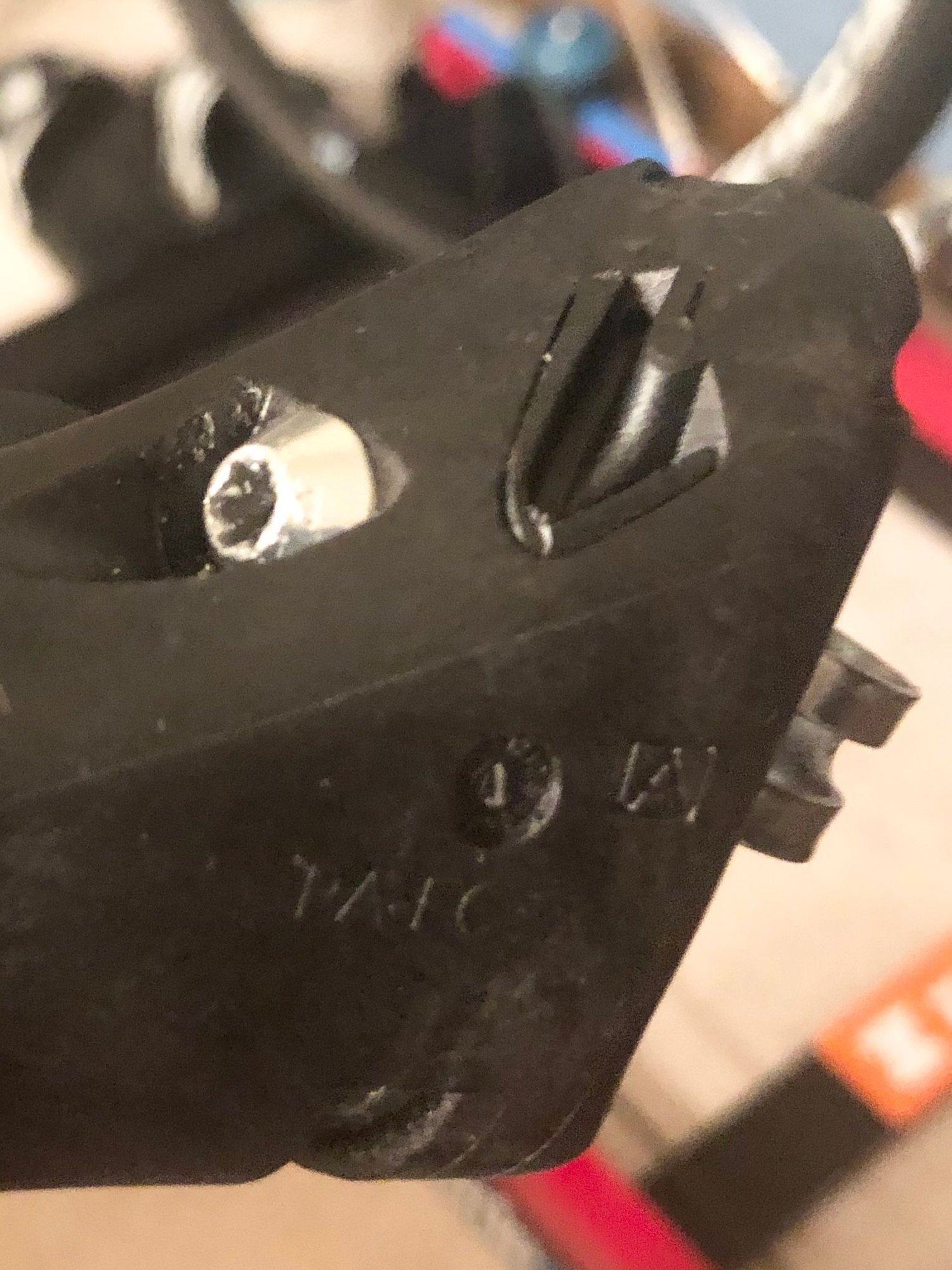

Anyone have any idea what the problem is?
in addition to generally poor shifting, I have difficulty changing down to lower gears. To do so, I have to push the right-hand lever inwards and then the button repeatedly. If I am lucky, it clunks into a lower gear.
It's probably a frayed shift cable.
Shifting gets a little sluggish, gets worse, can jam up entirely, and broken strands can spear your thumb drawing blood.
Keep track of your mileage between failures and change them before that point. That can vary from under 1500 to over 15,000 miles depending on how frequently you shift.
With 2009+ Ultrashift 11 speed levers, you can inspect them on a regular basis shifting to the small cog, lifting the back of the hood where it abuts the bar tape, and examining the cable laying in its guide. Make this a habit when you lubricate your chain.
With pointy hood 8-9 speed levers through 1997 having the cable housing entering vertically you can't do that.
I think the 1998-2008 round hood 9-10 speed levers have the newer cable guide configuration, but skipped over that generation.
Note where the cable runs in this photo from https://www.bikeradar.com/advice/wor...o-ergo-levers/. The cable section which gets bent around both the shift drum and guide flexes a lot and fails from fatigue.

I bought a Campag 11-speed Record groupset in 2014. I think it was the 2011 model. Housing not changed since fitting, rear mech cable changed a couple of years ago.Front mech changed last summer. Chain and cassette changed last summer. Tried to adjust myself.
Thanks
I bought a Campag 11-speed Record groupset in 2014. I think it was the 2011 model. Housing not changed since fitting, rear mech cable changed a couple of years ago.[Front mech changed last summer. Chain and cassette changed last summer. Tried to adjust myself.
Thanks
I usually replace rear shift cables every 2000 miles to prevent breakage at 2200 - 2600 miles, but shift more when I'm out of shape and had issues at 1301 (broke completely) and 1558 (broken strands) miles. The last one made it to a normal 2186 miles.
Housing at the handlebar develops noticeable friction in a little less than double the time, and the rear loop a little more than double. To limit how often I take things apart I replace both at the same time as the cable. I keep that affordable using bulk Campagnolo housing, although Shimano at $1.80 a meter would cost even less.
That's every 10 weeks riding a lot, and still less than annually when barely riding.
Combining shifters level with the bar tops and under tape cable routing added a tight ninety degree shifter guide which doubled cable fatigue and cut life in half. Moving away from the flying housings caused the same problem with Shimano mechanical shifters.
How that translates into mileage varies with your shifting habits. I ride tight cassettes and maintain a metronomic cadence shifting like I have ADHD.
Drew I have 2015 Record shifters. The link above talks about being careful not to lose the pale yellow Teflon insert (see step 5). I donít see any pale yellow inserts on my shifters. What are they talking about?
Are they talking about the black insert below on mine?

Originally Posted by jadocs View Post
Drew I have 2015 Record shifters. The link above talks about being careful not to lose the pale yellow Teflon insert (see step 5). I don’t see any pale yellow inserts on my shifters. What are they talking about?
That's the insert in question. A finger on top will protect it from being dislodged installing a new cable from the bottom.

Hi Everyone,
Well, I finally took the bike to the LBS for a winter service, and I asked them to check the shifting problem. It was, as suggested above, a cable problem. They changed both inner and outer cables.
Thank you for all the great advice.
