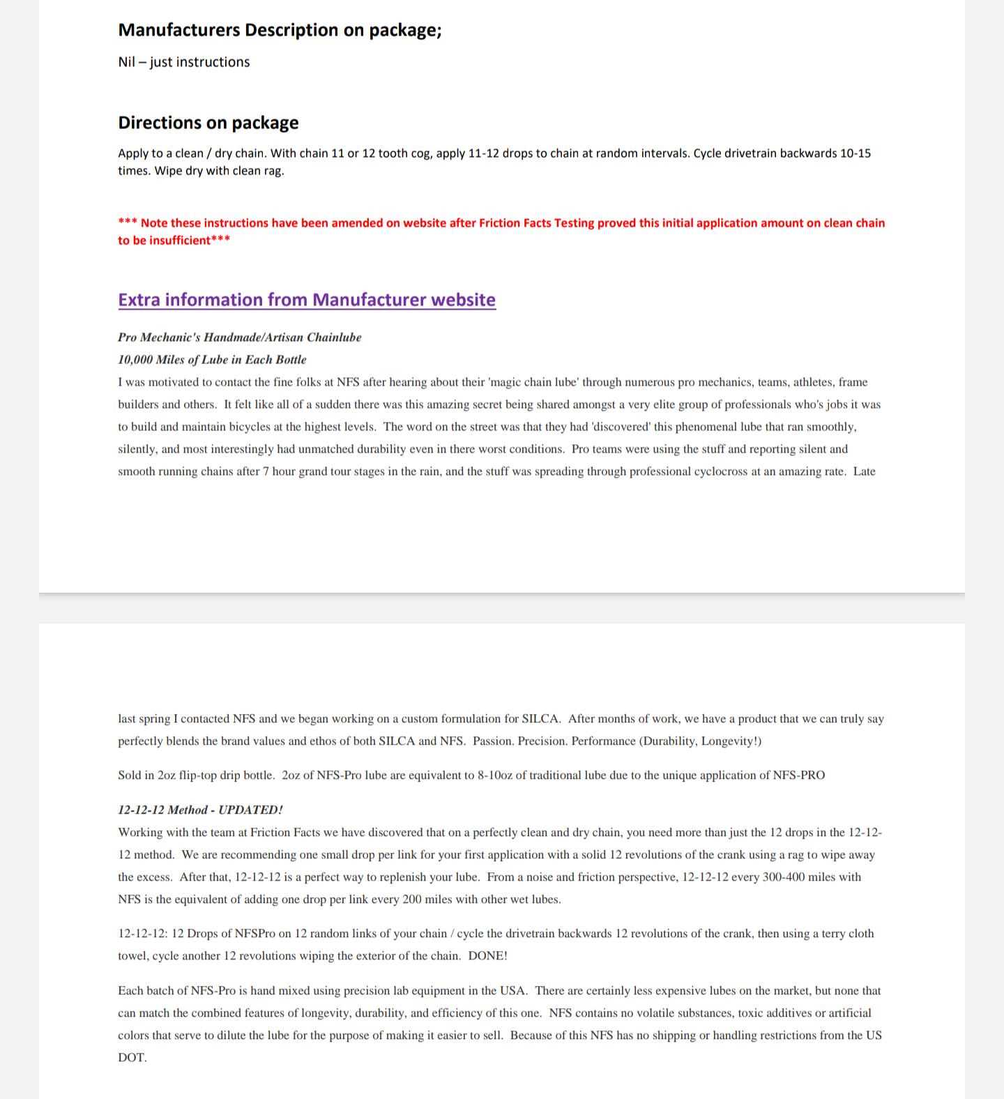

NFS chainlube. 12 drops does a complete chain. Really. The disbelief is the reason they can't sell much. I add one or two drops every hundred miles. If using the bike in brine yes more maintenance is required on every part of the bike. But not so much for the chain. Currently I no longer ride at -20 Fahrenheit but I have. I can tell you NFS works quite well at -5. If heavily brined maybe add two drops per hour the bike was outside. Add the oil just before you head out so that it spreads around. If you just have to add oil before parking it run the cranks backwards a dozen times . That's all that is required. Could not be simpler.

...NFS chainlube. 12 drops does a complete chain. Really. The disbelief is the reason they can't sell much. I add one or two drops every hundred miles...
I'll be darned. I just Googled NFS chain lube. All this time I thought it was an inside joke on bike forums. It's a real thing.
Kinda tempted to try some now, at least on the bike that gets ridden in the wet occasionally.
I've plugged it here half a dozen times with no response at all. Riders are loyal to their chain lube. Will take your response as license to give it another plug. It's a bit pricey and shipping is too darn high but you don't use much. I do maybe 6000 miles a year and my wife about half that and we have a fleet of bikes. Took us four years to use up the first 2 ounce bottle. Would of lasted longer than that but ends up being used for lots of stuff besides chains. Chains are oily but much cleaner than chains with normal oil. Just not as wet as when it is necessary to oil every link.
I was sold when I saw Lon Haldeman's endorsement. Lon still earns income as a product tester which means he basically keeps his mouth shut regarding kit. NFS was so good he made a huge exception. And he gets no payment for endorsing, they have no budget for that. Also sold by Richard Sachs and Josh Poertner/Silca. Also endorsed by Tom Kellogg. Those guys are seldom wrong about anything.
I don't much ride in rain any longer. Have been caught in rain for three hours and 50 miles with NFS on chain. No squeak, no rust. Gave the chain a couple drops extra, no big deal. For ordinary town riding in salt slush, leaving the bike locked up outside for hours in rain or snow with only saddle leather protected, NFS laughs it off.

i use wax for most the season and the silca NFS version in the winter. I'd say 12 drops/application is optimistic. I tried and it seems somewhat noisy and not that long lasting. Went to 1/2 drop/link and it is much quiter and longer lasting in the rain/muck. Pedal it through for a few mins, wipe off the excess. You might be able to reapply with less drops directly but I always pull and wash the chain in OMS like I do for waxing. It seems like there is less friction than the Chain-L I was using before and about half the life, 500miles vs 1000 miles
I've done a bit of research on the NSF lube. The application instructions make the impression that there's some magic involved. How does dropping 12 drops in random places on the chain make all the rollers lubricated?
1. With your chain in the big ring and the smallest cog apply 8 to 10 drops of NFS at random and run the chain backwards to distribute the lube. A very good method is the 12:12:12 method. follow the instructions for chain position than add 12 random drops, rotate the chain 12 times than wipe it with a clean cotton cloth for 12 seconds.
I'm skeptical that this method will yield in a well lubricated chain. But I seen that all the people who tries this lube love it. So I might try it.
Where do you buy this lube? Looks like it's not that easy to find.
I tried wax once in the 1970s and once in the 1990s .The cleaning process is extreme. I was motivated and did the job very thoughly. Without an immaculately clean chain just no chance the wax will go where it can work. The cleaning uses enough solvent with enough opportunity for error it is just not something that should be done by large numbers of people. Let me point out here that paraffin, paraffin oil, all the solvents, are all petroleum products. Waxes are a simple chemical and occur naturally in all sorts of biological forms. What you buy at the store came from an oil well. Few will or even could use beeswax. Otherwise waxing chains is needlessly bad for environment.
No, wax does not last long. If you buy the race chain it is good for one 40k TT. A few track events. Lower power riders can get more miles. I didn't. The squeak alone is enough to deter any further experiments.
NFS is online only. From the maker or from Silca or from Richard Sachs. Put 12 drops on chain. Ride one mile and it is distributed over whole chain. At that point your chain is running smoother and quieter than you have ever experienced. A one mile trial and you will not go back.
Downside? You are going to bore your friends talking about chain lube and none of them will believe you. If your chain was previously waxed oil is not going to work. When first applied the NFS will attach to metal and drive off the old oil. You will need to keep wiping off the old oil after your ride a good while before it is all gone.

FYI if starting from a clean chain 1 drop per link after testing my zero friction found 12 drops inadequate

Interesting, "Friction Facts" tests indicate that Molten Speed Wax outperformed Silica NFS in both durability and friction. Silica NFS was their pick for drip lubes for ease of use.
Paraffin + PTFE was tested against Molten Speed Wax by Oz Cycling and his findings show Paraffin + PTFE to be superior.
We get way more than 10,000 miles to a bottle in this house. Three or four times that. Applying 12 drops every 300 miles would result in a sloppy wet chain. Applying a drop to every link would just cause a dirty oily bike. Whenever a bike or chain is done first time with NFS there is just no need to strip the chain bare. Maybe the old lube or packaging lube is working in our favor.
Reading through that document my impression is they have realized no one believes them and if all the world insists on overusing lube they will sell it to you. This household now has five years experience with the product, the formula here is one or two drops each hundred miles. Look at the chain. If it looks dry, was out in rain, use two drops, maybe even three if lots of rain or if used in salt slush. If chain still looks wet, runs smooth, only one drop.
63rickert is offline
If you are looking for maximizing watts saved then you should clean the chain thoroughly to remove any other lubricant just like you would with a waxed chain. NFS doesn't have any solvents to flush out old lubricant. Like I said above I apply 1/2 drop per link when clean and it works fine, it doesn't drip and you wipe off the excess. I don't usually reapply to a dirty chain and prefer to wash in batches in OMS and even with adding to each link I get quite a bit of mileage out of it.

I can't use the newer instructions. Have never owned a bike with an 11 or 12 tooth cog. One of the reasons for buying the NFS in the first place was their old and original marketing. They would answer queries with answers approximating "How much do you need to know to put oil on a chain? If you are that obsessive this lube is not for you." That marketing worked for me.
Myself have completely cleaned a chain in mineral spirits exactly twice in my life. Experiments with paraffin. Can't imagine another reason to do such a thing. Would never recommend to anyone they should be sloshing around in flammables. All on this forum are conspicuously above average and would never start a fire. Couldn't possibly happen. Reciting 'flashpoint' under your breath is an incantation that keeps flames at bay.
