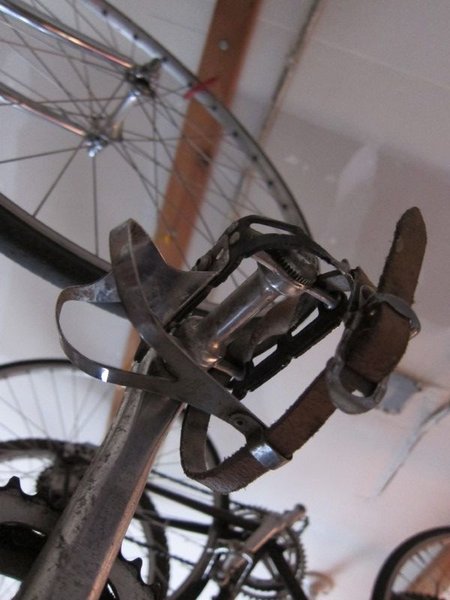

I have used nothing but quill pedals with toe clips for road riding because they fit snug like a glove.
My shoe of choice are high top converse chucks, though as they wear, the sole above the contact point with the pedal becomes thin. The traditional quill cage does not have much in the way of support and this combination starts to feel like standing on a post. This occurred to me after a lapse in riding while working in the mountains during the winter where/when riding is not as accessible, then going back to riding with my same shoes.
Can anyone recommend a type of pedal that would mount toe clips that would provide more support but also be snug and optimal for road riding? Would platform pedals that mount toe clips be just as good, albeit clunky in appearance and shape?

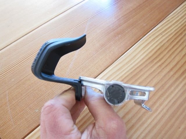

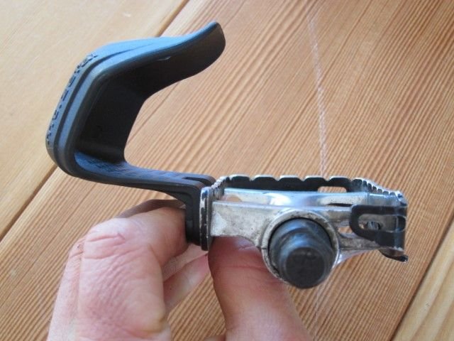

In the original post, it was only implied, but I am not interested in clipless or any bicycle-specific shoes as I like commuting without the need to change shoes. The canvas all-stars being so narrow actually fit well in quills, but would like to know if there are any other toe-clip people out there who have found more supportive quills. I like being strapped in so my foot stays in one place.
The thing I don't get about the MKS GR-10 pedals (of which I have a pair) is how a shelf forms where the toe clip attaches, whereas many other pedals mount the clips flush with the pedal surface. I haven't tried this yet, but imagine it would be uncomfortable at best or not work at all. The MKS steel toe clips (see first pic) I use have very little room to reduce height below the point of being flush with the pedal surface.
To solve the problem on the pedal and toe clip platform, I would use two tire valve nuts to put a little space between the pedal and the toe clip. This will help pull the toe clip out enough to clear the lip.
I'd be tempted to grind, or file down the pedals. But MKS does also sell 1mm spacers.
https://www.mkspedal.com/?q=en/product/node/401
You could also make an adequate spacer with either steel or aluminum plate or flat bar, and a drill.
