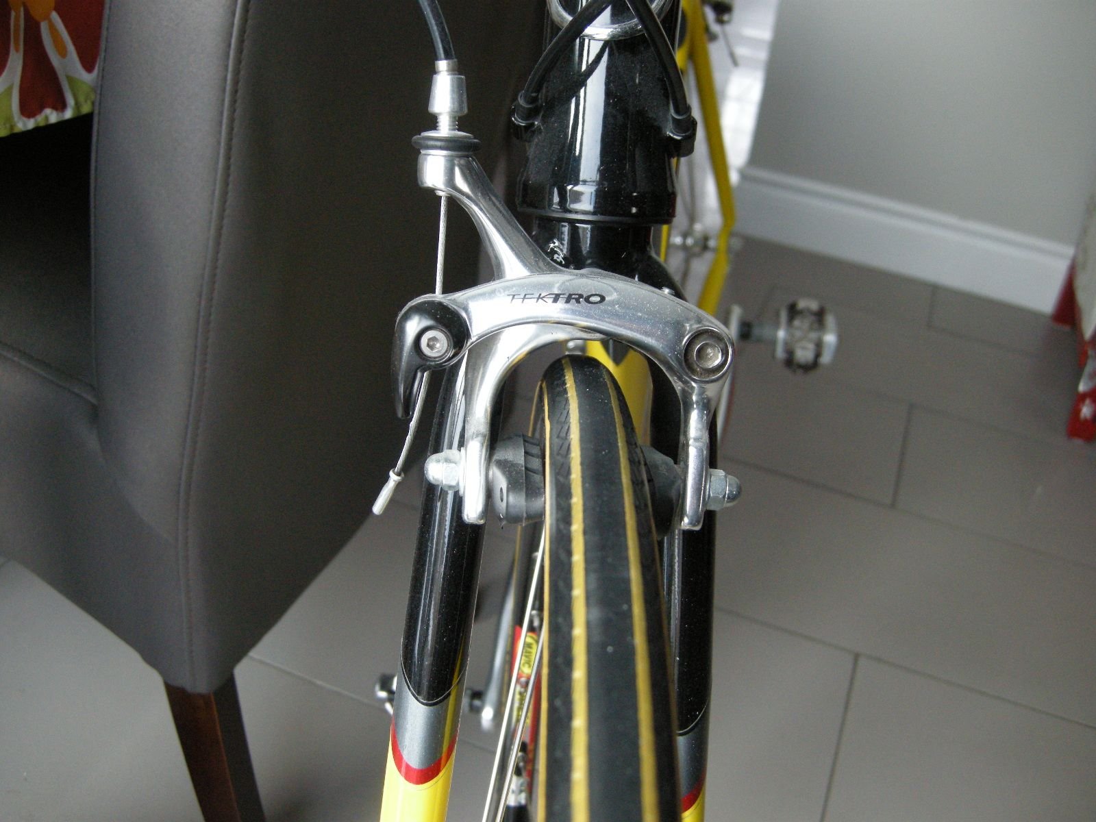

Here are pics of the bike up for conversion.

I agree with the comment about the rather restricted tire clearances. I suspect 25mm is the widest (without actual try and see efforts being done) that will fit and retain some clearance.

Andrew... I've mounted Continental 25's on (before) but the clearance to the seat tube was barely enough to slide a dime thru....so they were swapped back to the OEM 23's. I hear you about the seat. I always found the current seat to be very hard. Even the paper thin seat on my Langster feels better.
