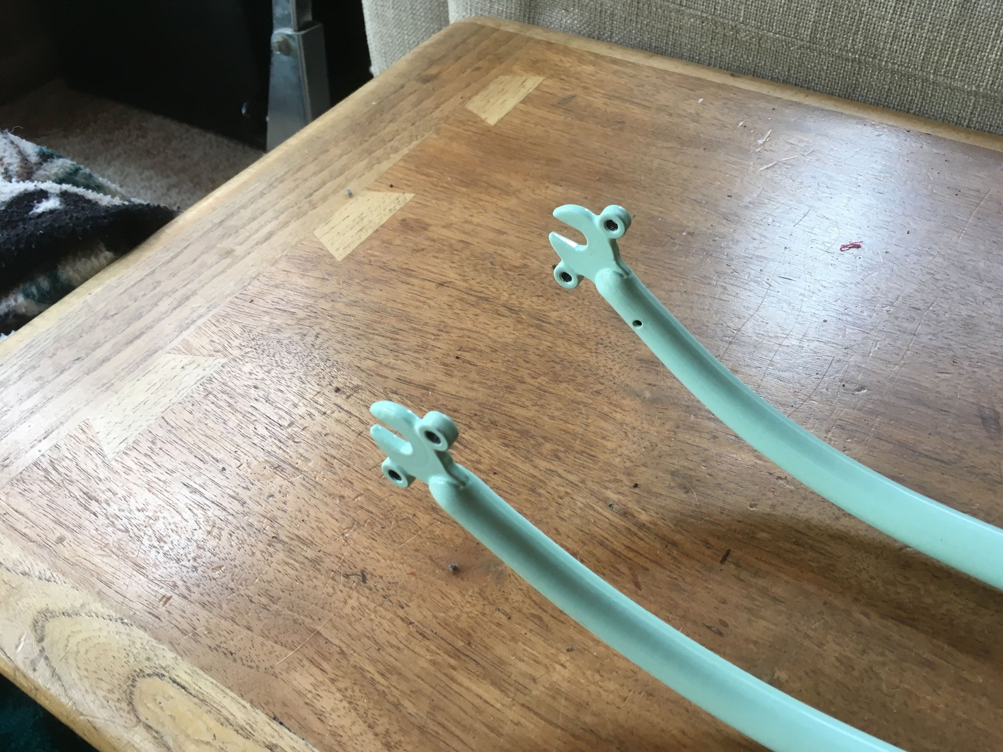

I had this done to an old Peugeot.

I have some mods planned shortly.
I think I'll stick to 25mm or 28mm tires, so no cantis, etc.
However, I've been wondering a bit about seat stay & fork rack mounts (and perhaps dropout mods).
A couple of questions I've been mulling over. First of all, I'd hate to be 500 miles from home and experience a critical failure. So, any solution has to be STRONG & DURABLE.
One question is whether one is better off with those spool shaped attachments like @Aubergine used, vs drilling and brazing the tubes, using water bottle bosses for the rack mounts.
Welding the dropouts?
Randomhead
Posts: 24,398
Liked 3,698 Times
2,518 Posts
spool mounts are probably stronger than water bottle bosses. I'm not convinced about braze on dropout eyelets for a heavy rack though.
I'd probably prefer to use spool mounts on a fork instead of drilling it for insert threading, although I don't like the look as much. Several mirror imaged pairs along each blade would certainly increase flexibility of attachment o' stuff. Ritchey used to offer a heavy duty rear dropout, and that's about the only thing I do remember about frame parts. If I could find pairs of those that fit, they might be a replacement option on a frame sometime.
