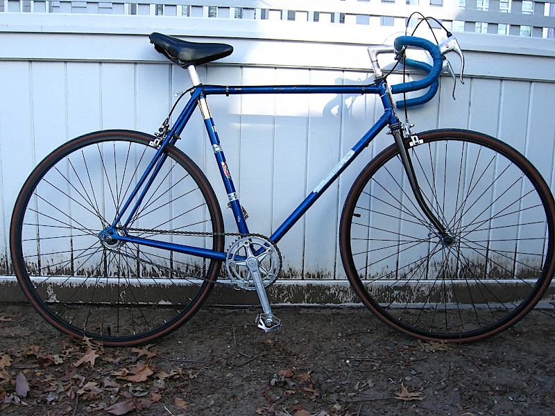

My first Lambert was blue, lugged (yes, they did make a lugged version at some point) w/ conventional BB and w/ death fork. It was my first attempt at a single-speed conversion (I learned a lot from that experience), and I mostly used it as a commuter. It rode great--very light and responsive. Here's a pic of what it looked like when I sold it (w/ a steel fork):

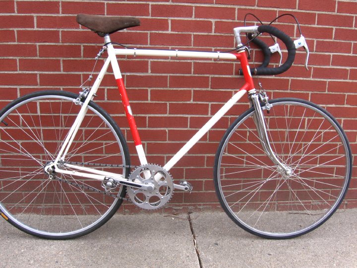

My second was a red fillet-brazed Viscount, which I had set up as a internal-gear 4-speed. Stripped of decals, the finish was excellent but the steel replacement fork on this one must have been out of alignment as it was terrifying on descents. On this one, I replaced the cartridge BB and spindle.

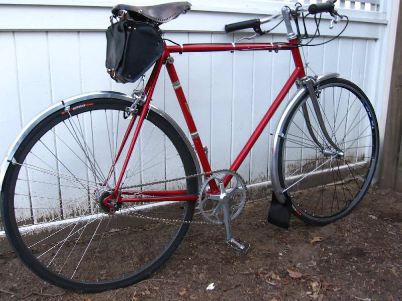

My third was the one Lem referred to, which I rehabbed as a single speed. That process included hacksawing off the left-side crank arm because the extractor threads were bunged and replacing the BB bearings but using the existing spindle. I also kept the original right-hand crank as it's very cool looking, even if the big ring isn't in use.

Here's a pic of my latest Viscount.
Neal
