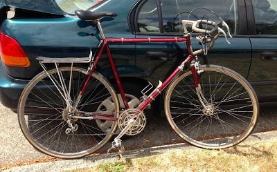

Hi everyone,
I finally created a profile and introduced myself, though I have benefited from the wealth of knowledge this place has before. And now I’m hoping to benefit yet again: I'd love to find out what the experts think I snapped up from the local flea market today. I've done research here and over at GitaneUSA, and although I'm not 100% sure, I think it is a full Reynolds 531 Gitane Tour de France from '74-'76. I base this on the remnants of Reynolds stickers on the downtube and left fork leg, honeycomb rear dropouts and the fishmouthed stays. The fork is also fishmouthed and has huret dropouts too.
The bike has some curious components and I think it saw an update/overhaul at some point. The bike came to me with: Mafac competition brakes, Mafac levers with full hoods. Campagnolo Nuovo Tipo hubs laced to 27" Mavic MA2 rims. Stronglight cranks that were originally French threaded, but have been re-tapped to 9/16", and 46/42 chainrings. What I believe is a Huret Jubile front derailleur, and an anachronistic Shimano 105 rear derailleur. The cable guides are all Huret, as is the downtube friction shifter. The headset is Stronglight, and has a couple spacers along with the cable stop. And finally a 25.4mm steel seatpost with a Turbo saddle. The seatpost was too small and someone over-tightened the seatpost clamp, but I straightened it today. The rear dropouts are spaced at 126mm, which is too wide for the 5 speed rear hub. The frame has Bocama lugs (what appears to be "BCM" on the headtube), but no cutouts. The rear dropouts say "60" on the inside, yet the frame measures at most 59cm center to top.
So what did I get? Am I correct this is a TdF? Or is it something else? The later rims (Velo base says this MA2 sticker is from 86-87) with the 5 speed Nuovo Tipo hub and the 126 rear spacing is something of a head scratcher to me.
All in all, the frame is in pretty nice shape, with no serious dings or rust. If it is only 3 tube Reynolds I'm fine with that, just curious mostly. My plan is to replace what needs replacing with appropriate french parts, respray the frame and enjoy it as a sport tourer.
Looking forward to hear what the experts have to say!
PS: I'm a newbie on this forum so I still can't post pictures, but as soon as I am permitted I will update with pics

25.4 seat post would not be butted 531. Might be straight gauge Interclub. TdF would have a 26.4 most likely.

Looks like a Gitane Super Olympic. I had one once and wish it had been my size. Sadly, it was not and for what it is worth, another honeycomb Super Olympic would be snapped up in a heartbeat if one shows itself for sale and if I have the $$$ at the time. My never ever ridden Super Olympic...
randyjawa is offline
Old 11-24-19, 12:32 PM
ryansu
Ride.Smile.Repeat
ryansu's Avatar
Join Date: May 2011
Location: Seattle WA
Posts: 2,863
Quoted: 787 Post(s)
Liked 498 Times in 357 Posts
Had a Gitane TdF with honeycomb rear drops pass through my hands a few years back.
ryansu is offline
Old 11-24-19, 12:49 PM
Wildwood
Veteran, Pacifist
Wildwood's Avatar
Posts: 10,922
Mentioned: 247 Post(s)
Quoted: 2754 Post(s)
Liked 1,617 Times in 942 Posts
had a gitane tdf with honeycomb rear drops pass through my hands a few years back.
bingo!
@ryansu FTW,
@verktyg, you can go back to sleep this Sunday AM.

What does the gold lettering on the drive side chainstay spell out? I can't make it out, even with the partial close-up photo of the front derailleur.

I'll cut to the chase... BTW, thanks for the pics @Bianchigirll
@NHmtb has a rare, at least for the US, 1974 Gitane Champion du Monde.
1974 French catalog
I had one of these frames for a bit. I rescued it from the fate of being a fixie. Sadly it was too big for me and I passed it on.
Here are the tells:
The frames were basically the same as the European market top of the line Olympic model except they had a shorter steerer for a 33mm stack height Stronglight P3 headset. The Olympic model had a Campy headset with a 41mm stack height.
It's a 1974 model because it has the older Reynolds 531 decal on the down tube indicating all the tubes were Reynolds (not really, Gitane used butted Nervor brand steerers and seamed gaspipe head tubes plus the brake bridges were rolled sheet metal parts, not even tubes)
In 1974 Reynolds changed to this style decal with a gold "cartouche" at the bottom but many bike makers still used the older style throughout 1974. Maybe they or Reynolds had a lot of them left over or Reynolds were late releasing the new style in French???
Ignore the Bocama Super Professional R1 lugs with the cutouts on my frame, Gitane used what ever they had on the shelf.
My 1974 TdF has Prugnat lugs with cutouts...
Next it's a 1974 because of the head tube sticker. They used this design in 1974-75.
In 1976 they switched to this style.
The 25.8mm seatpost issue:
Outside of the UK MOST Production Reynolds 531 frames used 1mm x .7mm wall thickness main tubes. That included Gitane, Peugeot, Motobecane, Legnano/Frejus, Zeus, Gazelle, Schwinn Paramounts, Mondia and so on.
Bikes made with "10/7" (as it was described in France) metric tubing used 26.4mm seatposts.
My Champoin du Monde frame took a 26.6mm seatpost because it was made with lighter gauge .9mm x .6mm main tubes.
Gitanes made with their standard seamed gaspipe tubing used 25.8mm seatposts. The main tubes had a 1.5mm wall thickness.
Some ham fisted hammer mechanic probably clamped down on the 25.8mm seatpost pipe. The seat tube can be rounded out to take the correct size seatpost.

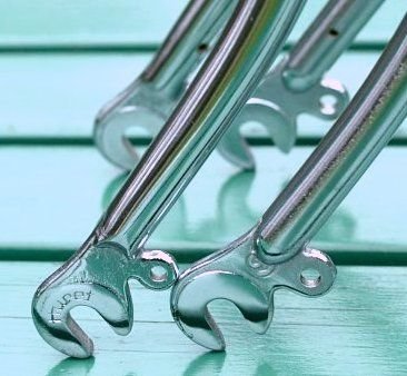

Huret honeycomb or spider web drop outs:
They first appeared on a few French models in late 1973 and continued to be used on performance models until the end of 1976.
They were never popular. When we first saw them our response was WTF??? They were such a departure from "normal" dropouts that even many inexperienced first time buyers balked at them.
Add to that, those 1974 Gitane bikes were a hard sell for us because they were as much as 30% more expensive than comparable competitors models.
We ended up selling most of those 1974-75 Interclubs and TdFs on close out, sometimes for less than our cost!
One positive feature of the Huret dropouts is the could be used with most brands of derailleurs: Campy which had become the de facto world standard design, Simplex and Huret.

Chain Stay Sticker
What does the gold lettering on the drive side chainstay spell out? I can't make it out, even with the partial close-up photo of the front derailleur. DD
On the 1974 and later bikes it says "Racing Team" with a Gitane logo.
On the earlier foil decal bikes it says:
Which means deluxe enamel... which was a JOKE!

wrt Honeycomb -
@NHmtb,
in case you were a-wondering anent the presence of the small half thickness tab on the edge of the cycle's righthand dropout it is part of a chain holder arrangement -
juvela is online now
Old 11-27-19, 06:13 PM
verktyg
verktyg
verktyg's Avatar
Posts: 3,446
Mentioned: 168 Post(s)
Quoted: 762 Post(s)
Liked 453 Times in 300 Posts
Weird tabs on Huret Honeycomb Dropouts
wrt Honeycomb -
@NHmtb,
@juvela Thank you for mentioning that point.
For years I'd been wondering what those protrusions were for. When we first saw them in 1974 our comment was WTF?
They looked like casting "sprues" or runners that weren't ground off.
Several years ago my curiosity was quenched when someone posted a photo of the chain hanger attachment on BF. It's designed to hold the chain when the rear wheel is removed. Rather an overkill design??? I've never seen one in the steel!
As I mentioned above, these dropout could be used with just about any rear derailleur on the markets at the time. It got around having to use 3 different dropouts:
1. Industry de facto standard Campy style with the travel limit stop at 7:00 O'Clock
2. Huret with the travel limit stop at 4:00 O'Clock
3. Simplex style with a travel limit tab on the back of the RD to fit over the front of the dropout. Shimano used this method for a long time and so did later Campy RDs.
Simplex (and early Shimano plus later Campy) travel limit tab.
Simplex and Huret had a rather chauvinistic view that they were at the center of the bicycle derailleur world. There was strong competition between them to have their proprietary dropouts used on bikes - when you needed to replace a derailleur, you had to use the brand that matched your dropout.
Along came Suntour who threw a monkey wrench into the French derailleur makers plans and adopted Campagnolo's style derailleur hangers. Most other derailleur makers followed suite!
Maird!!! Sacre Bleu!!!
By the mid 70's both Simplex and Huret started offering dropouts that used the de facto Campy standard hangers. But... in true Gallic tradition, they continued to offer their proprietary dropouts! Remember the Maginot!

Thanks for everyone's input. I've now got this completed (though I can't find a photo of the final build). I had the chrome redone on the fork and rear triangle, and did a little brazing - added water bottle mounts and brazed together the sheet that they used on the rear brake bridge, plus spent a little time touching up the original brazing to make it a little more polished. I polished all the components, rebuilt/replaced everything and then resprayed it. It's a little big. But, French bike, French fit!

This is a fun thread, lots of great posts. And you finished this bike up 2 years after your first post. You get a prize for persistence. The bike looks good how about some pics without the wrapping on the top tube!
bikemig is online now
