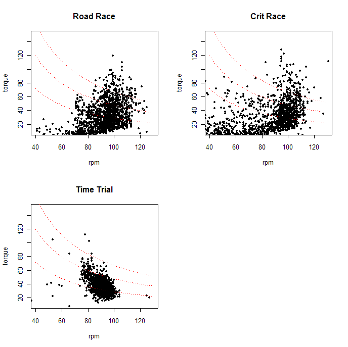

Here's a plot that shows cadence and crank torque for the same guy in three different types of races. The plot is from here.
